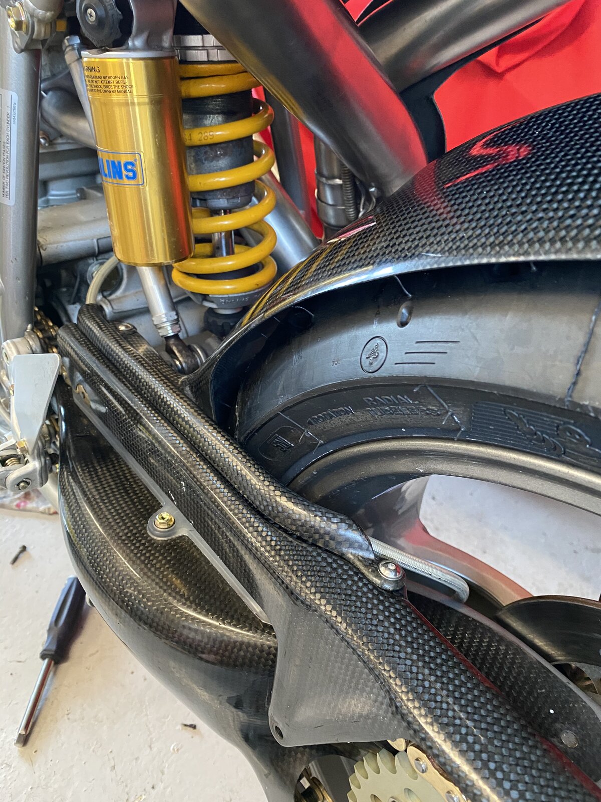

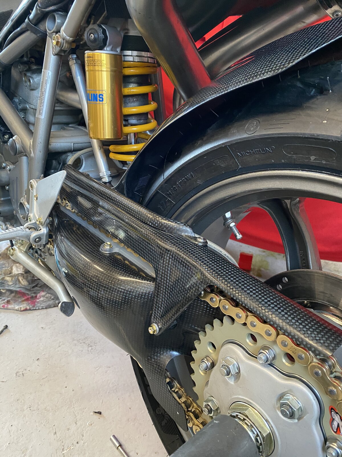

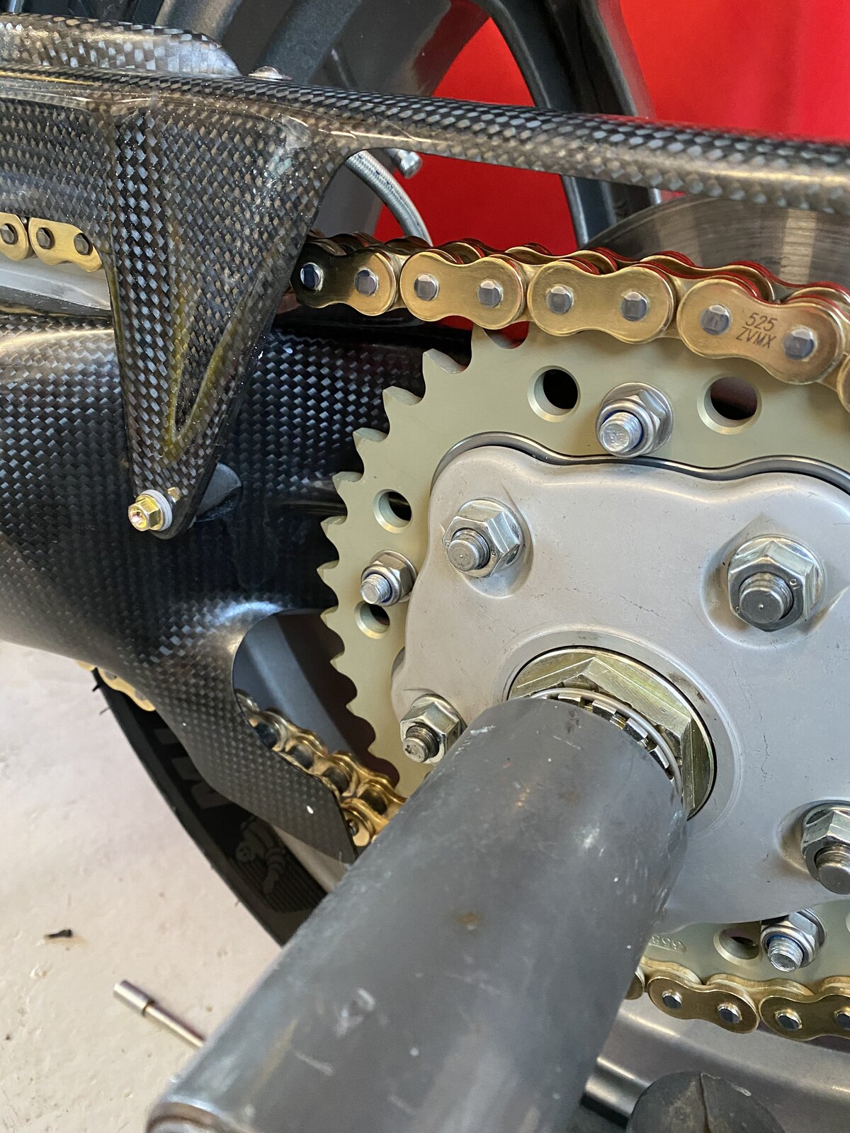

  11. Just been doing little bits and bobs while waiting on a few parts to come to finish it off.

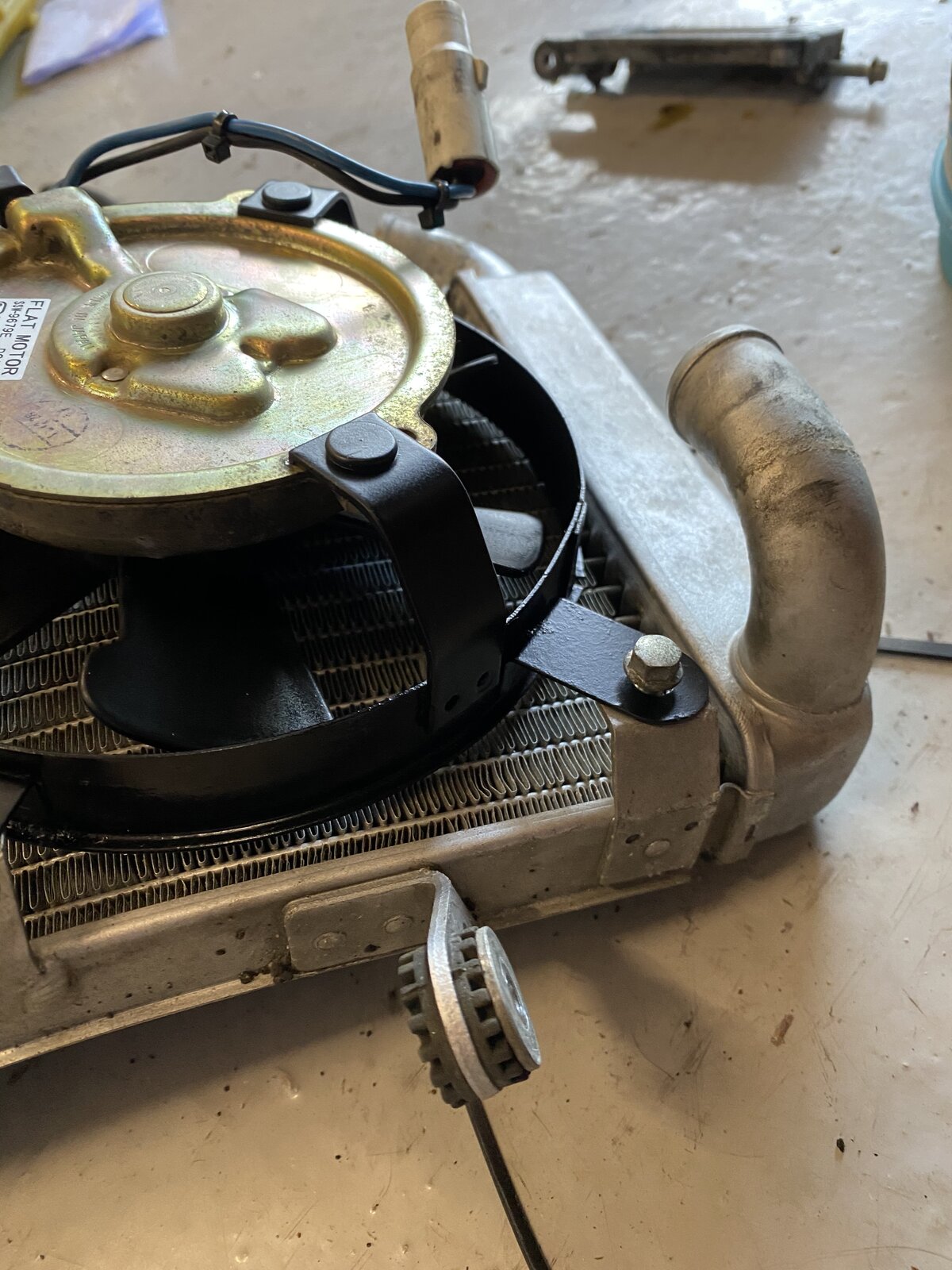

    Mainly stripped the nose off and took the radiator off, as it was filthy and also wanted to sort the fan shroud as it had some flaking paint. Also, the lower valve inspection cover is missing one of the lugs to mount the v panel so removed that for replacing

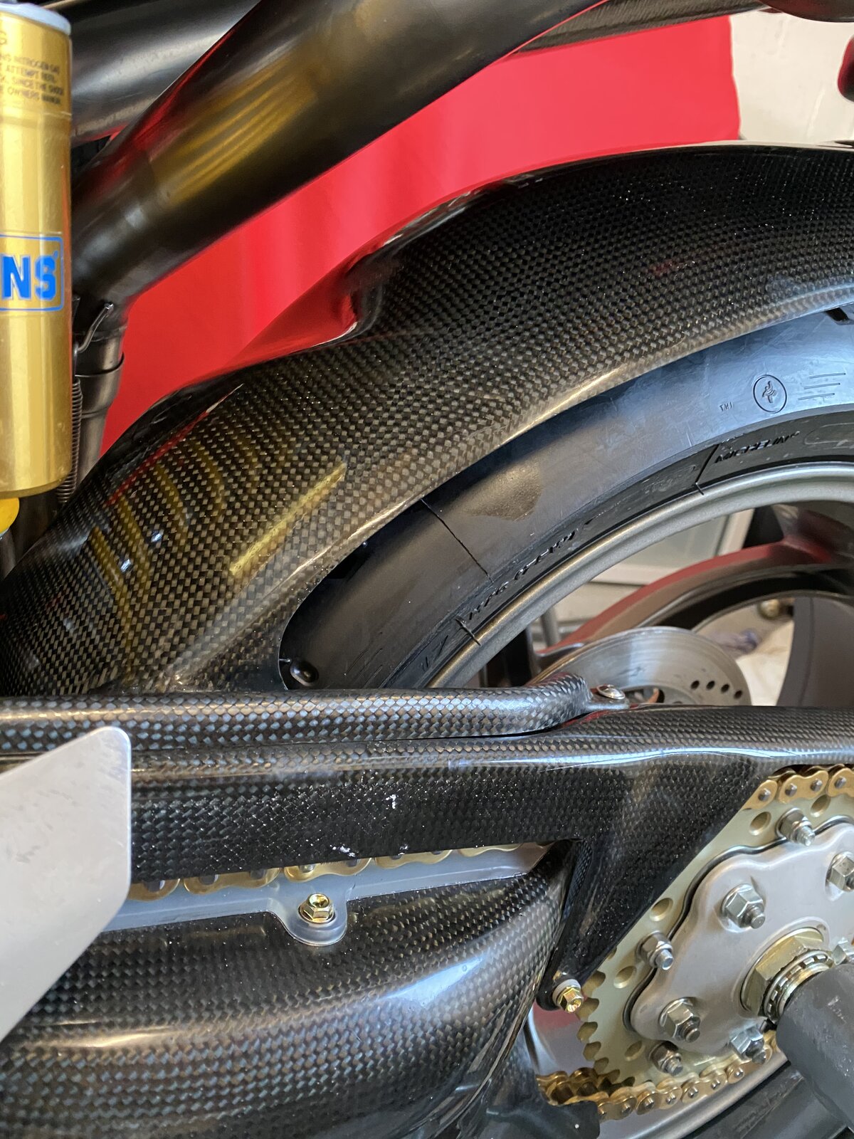

    and sanded and buffed the rear hugger and fitted that up.

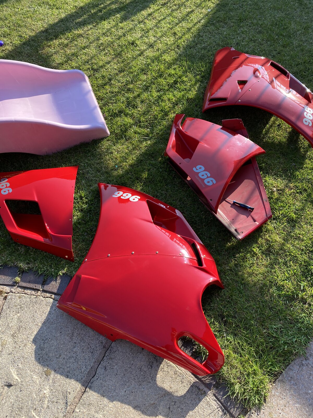

    finally, buffed and polished the fairings - sourced some new ones in OEM paint with the correct colour decals. The ones I had are slightly dark and was never happy with them.

  12. The seat unit in the last picture appears a bit sun faded.
  13. Ha yes it’s certainly pink

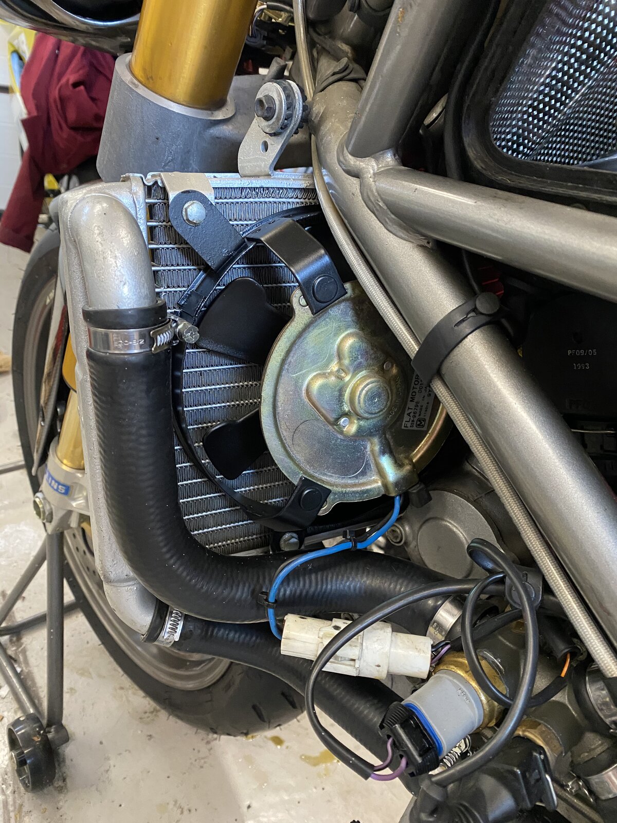

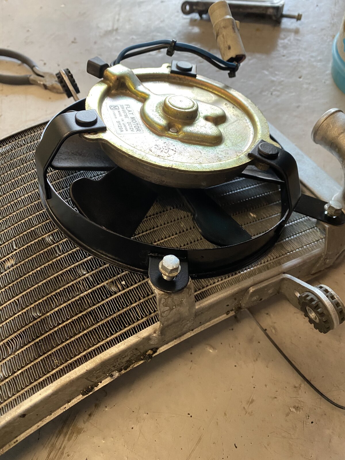

    just out fitting a replacement rad as mine was toast,
  17. My rad has damage and catches the top of the v piece, did you replace your rad with a Chinese one or is this one your replacement one, its on my to do list.

  18. Same here!
    just got a used replacement in nice shape off eBay for £50!
    Didn’t realise mine was bent until I looked closer!
  19. That was a good price, most i see are damaged I'm just waiting for a good one but at a reasonable price :innocent: or its a Chinese one but spray the ends silver.
  20. Just in case you haven’t read about @higgy748 ’s 1048 which had a chinese rad and caught fire, not enough cooling tubes causing the fans to run continuously, I’ve tagged him here for you. Buyer beware etc etc.
