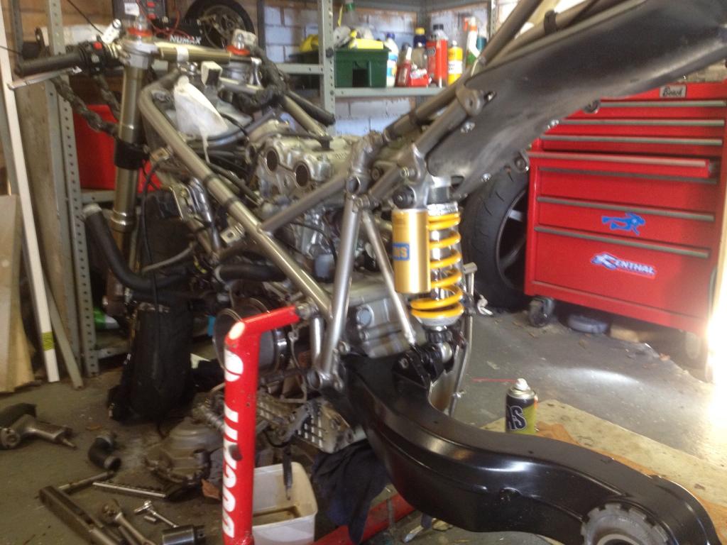

  2. Slow progress update& cheap clutch tool tip.
    DONT USE A £8 PLASTIC CLUTCH HOLDING TOOL TO LOCK THE ENGINE WHILE TORQUING UP THE ALERNATOR NUT, THEY DONT LIKE 270NM ,what a clown.
    thanks ducati Chris for the loan of a proper clutch tool.

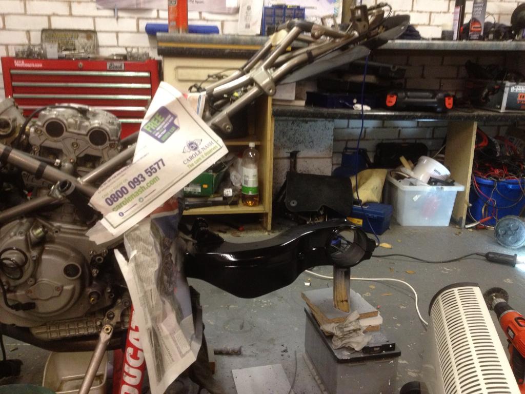

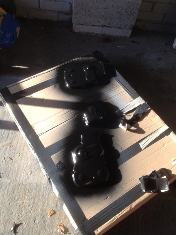

    you don't get much for £220 at ducati dealers these days,nice bag though.

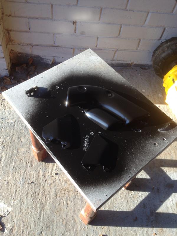

    managed to paint a few assorted parts,got rear shocker ect back in.
    I really need to get a move on now we can smell a bit off warmer weather round the corner.

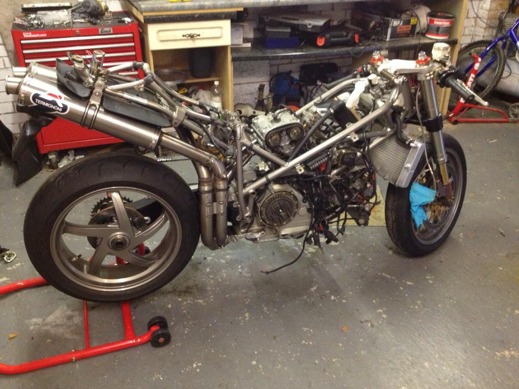

  9. Finally after 3 weeks of not doing anything to the old 998 I've managed to get a couple hrs in the garage.
    Hopefully the slowest rebuild in history will be finished before the nice weather arrives!
    Oberon clutch cylinder to fit,all brakes to refit and once the belts r done and TPS set its time to fire her up
    I just need a lower right hand fairing and my nose cone finishing

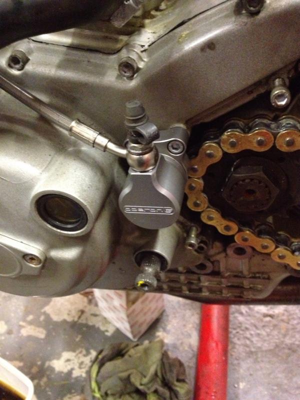

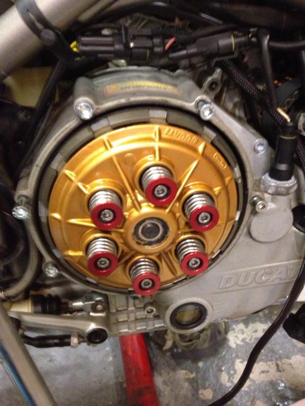

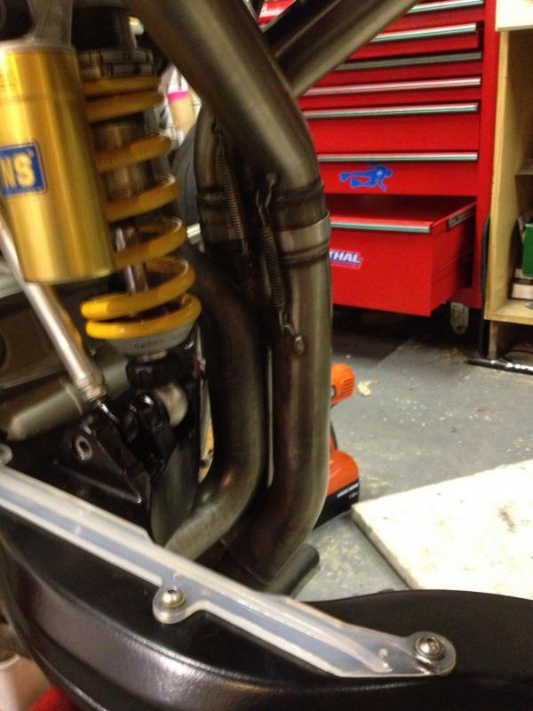

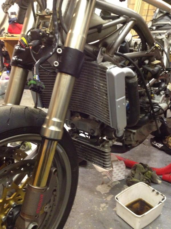

  10. image.jpg I've finally got my 1098/Suzuki clutch together with repainted pressure plate.
    image.jpg Oberon clutch cylinder fitted+ new chain.
    image.jpg Repainted rad refitted ,
    image.jpg New fuel filter now in & no leaks.
    oil&filter changed,rear brake cylinder & caliper back on & bled up.
    the battery is on charge ready for firing her up next weekend,time to get giddy!
