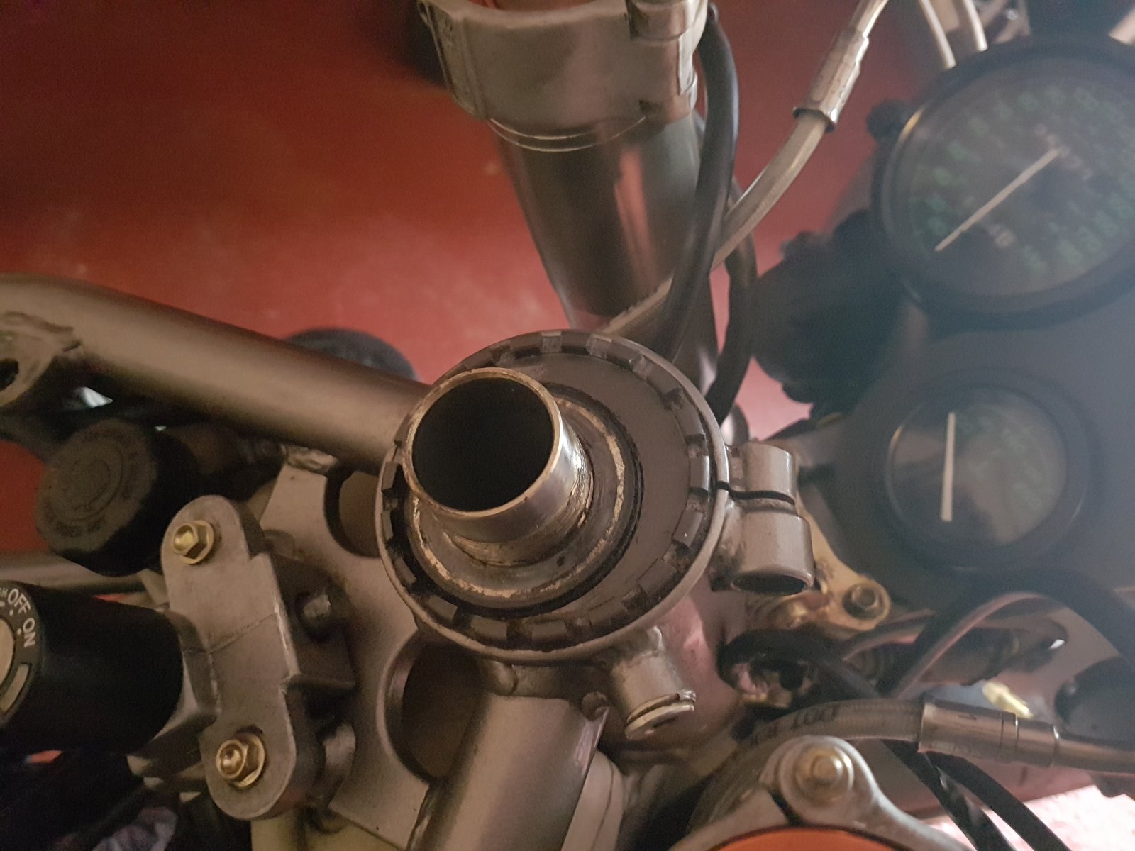

  4. I suspect this is stock set up? - stem position in head stock i.e. angle of forks
    This must provide the most rake / steering angle where as turning the stem towards the front of the bike (in the head stock) would make the forks more vertical, wheel base shorter and faster steering - for track use.

  5. Not sure from the photo but if the eccentric's been setup for race, you won't be able to use the steering lock, I think...

  7. Hayden said that at the BBQ and it makes sense referring to the above, at the stem moves forward it would clear the lock on the top yoke..
    My steering lock works in this postion and common sense tells me, this is as far back as it can be... hence more chopper style, so is stock

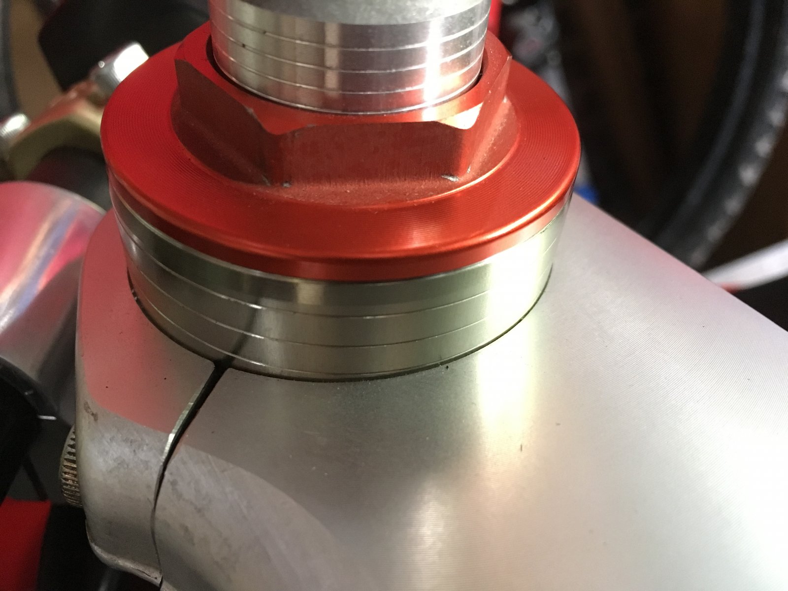

  8. I had that issue with the bike too. There were 5 rings showing above the top yoke when I bought the bike. I lowered it to 3 rings showing IIRC and the difference that made was massive. It felt a lot more sturdy after...

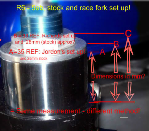

    I normal measure forks with a vernier from the top of the yoke to the top of the fork like this - my ocd diagrams (R6)
    The Ducati measurement is some way of measuring off the bottom yoke. Could anyone advise? is 3 rings showing the norm for the Ohlins too?

  12. If I don't get a reply re the ohlins.. I see on page 1 of this post Cream Revenge said the showa are 4 rings showing.
    I will compare the lengths of both forks (from the wheel spindle to the top, measure the increments of the marks) and make an educated guess... I will post a photo to confirm before I put the body work back on.

  14. Would those three rings be taken from the centre of the yolk point of view.. Eg:
  15. No worries NCF. Just replied. :)
  16. @flatairbag, yes.
  17. Sorry, no. Just re read your post. Taken from the inside part of the yoke. Where the 2 fork legs are closest.
  18. Yeah sorry that's what I ment.. So the photo is of stock position
