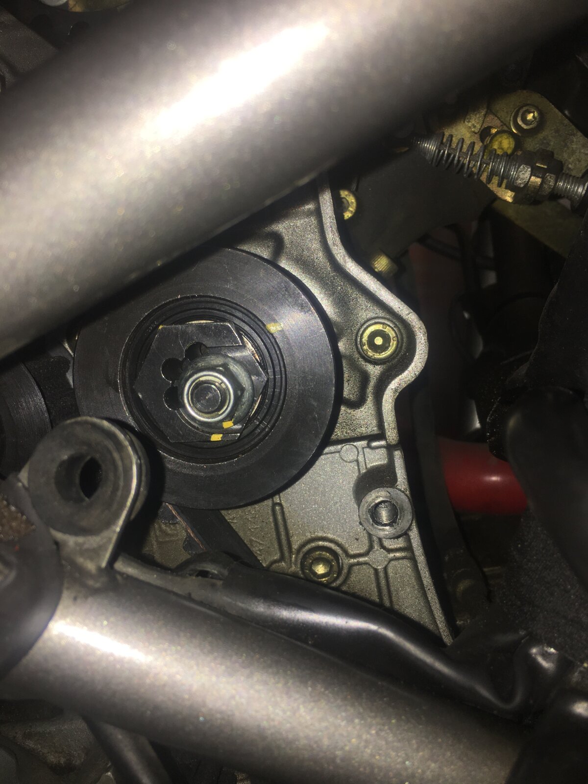

  1. Hi guys,
    Replaced my belt this morning. Forgot to picture the tension roller in front, but I know you can make a mistake in this. See pictures, i think they are good, but other pictures on the web make me worry....
  2. You can't tell by the position. There are several methods to check, twist, Allen key, frequency. I do all 3.
  3. Looks right to me, if you tightened the other way the belts can touch, they are closer than you think they should be
  4. I think he's concerned he turned the tension pulley the wrong way
  5. yep that’s what I was concerned of.
  6. I think turning 'up' or anti-clockwise is correct and looks like what you have done, others will confirm :upyeah:
  7. Ah!
  8. It’s counter intuitive.
    You have to turn what feels the wrong way, ie anti clockwise
  9. Oke makes sense. I finalized the belts change and started her up. Runs like normal. It just made me hesitate. Thx for the feedback.
  10. It’s vital to get it right.
    If it’s wrong, it has a double whammy effect. Not only do the belt runs get really close, you also can’t tighten them to the correct tension, making them even more likely to touch and potentially shred.
    If you were able to achieve the correct tension, you almost certainly did it right.
