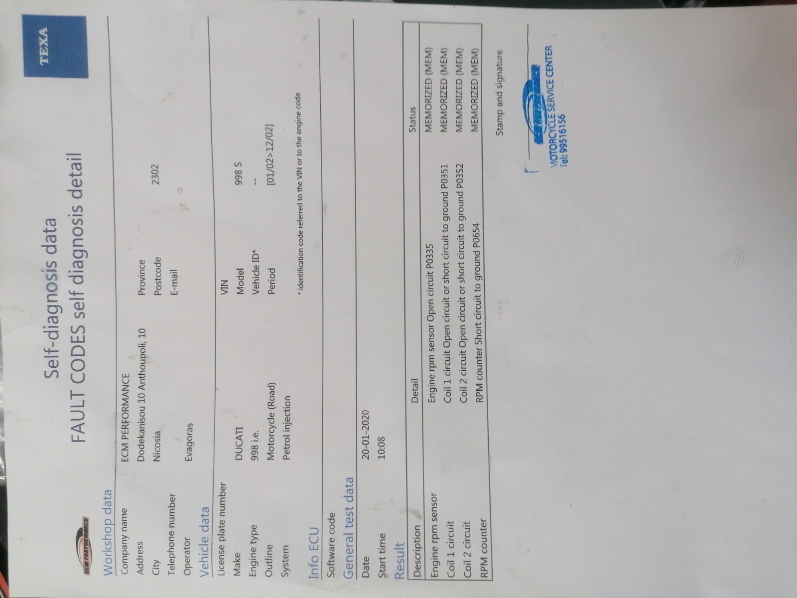

    The original bulbs are in, yes. All relays were replaced and connectors being checked now. The strange things we see are the following:
    Even now (with rpm sensor changed and rectifier) if you press the horn button with the bike engine off (switch on) the rev needle moves up. With the high beam on engine on the temperature Theneedle moves by 5C (instead of showing..85c shows 90+c). If you switch off then back to normal. Diagnostic software still shows timing/rpm sensor as problematic and same for the coils. I will try to attach the photo. We found one fuse (7.5A lights) hot but not melted.

  20. We decided we change the ecu with a similar one and take it from there. Reason being the diagnostics as all coils, rpm sensor and dash are controlled by ecu. If ecu is fine then we check wiring.
    It seems to be 2 different issues with the lamps and the ecu (?). And yes lamps although 12V 55W and same type as oem must have drawn more current. Now if it is the ecu unless there is no element inside burnt I guess could be flashed.. or not. We ll see.
