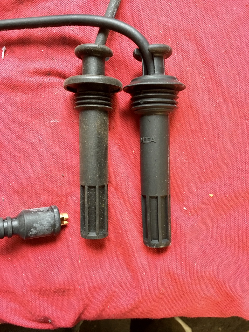

    Bloody lovely area you live in though! :upyeah:
  10. You would have a field day on @PerryL banks thread. :D
  11. Have you still got that tree in your front garden :thinkingface:

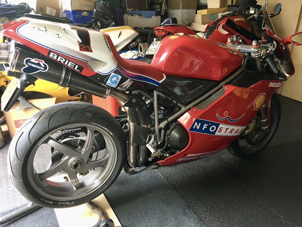

    Anyway, back on track. I started it up again and left it to run until the fan came on, blipped the throttle lots of times as the temp increased in order to hurry the process along. No more red hot exhaust headers, phew:grinning:. Quite why it did that earlier I have no idea.
    I put it all back together again to take it out for a road test but it started :splat::splat::splat: :(
    Over the winter the bike will have a complete strip down and deep clean but now it’s running properly I want to use it.

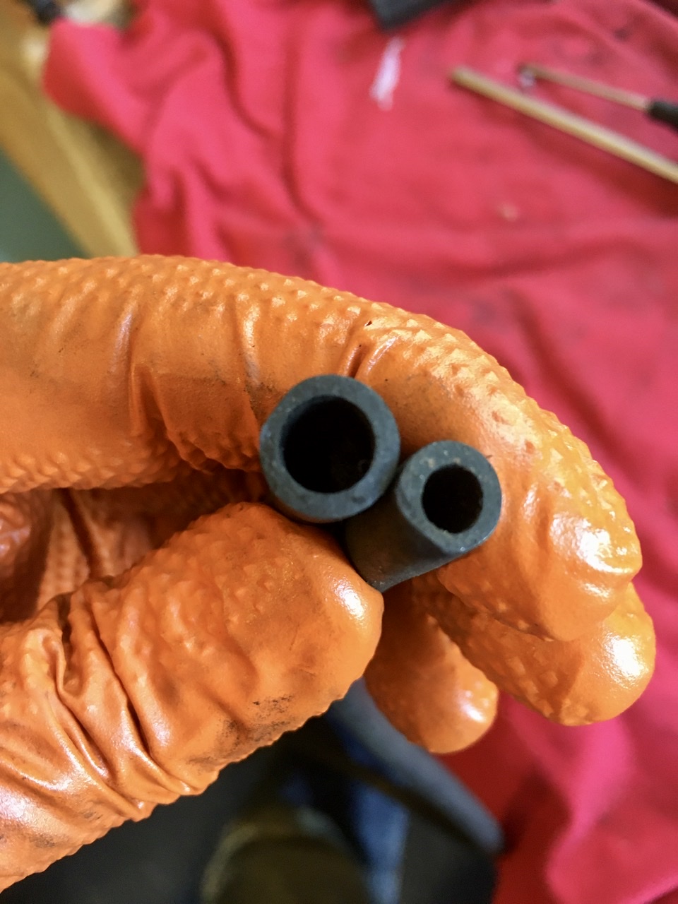

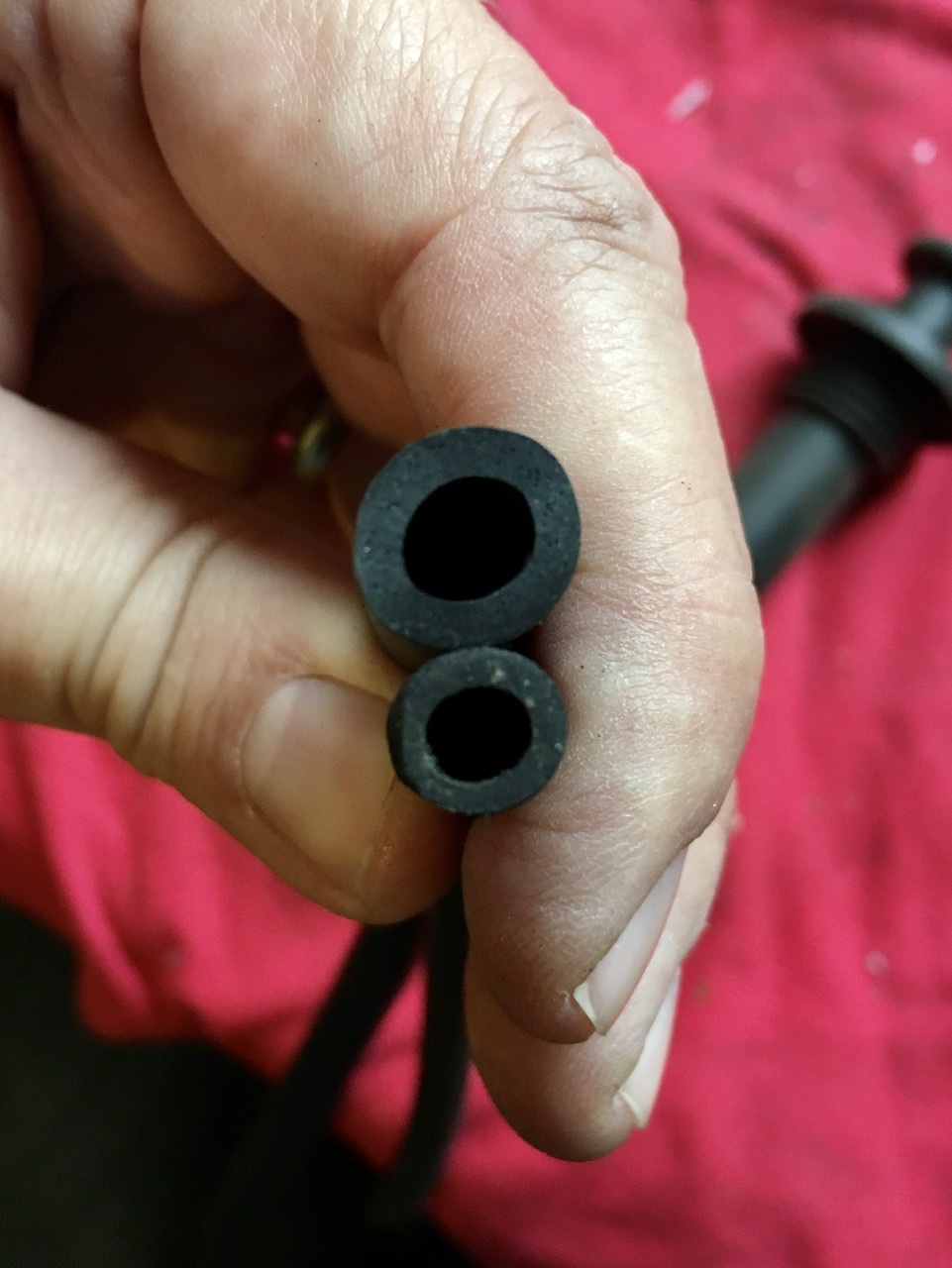

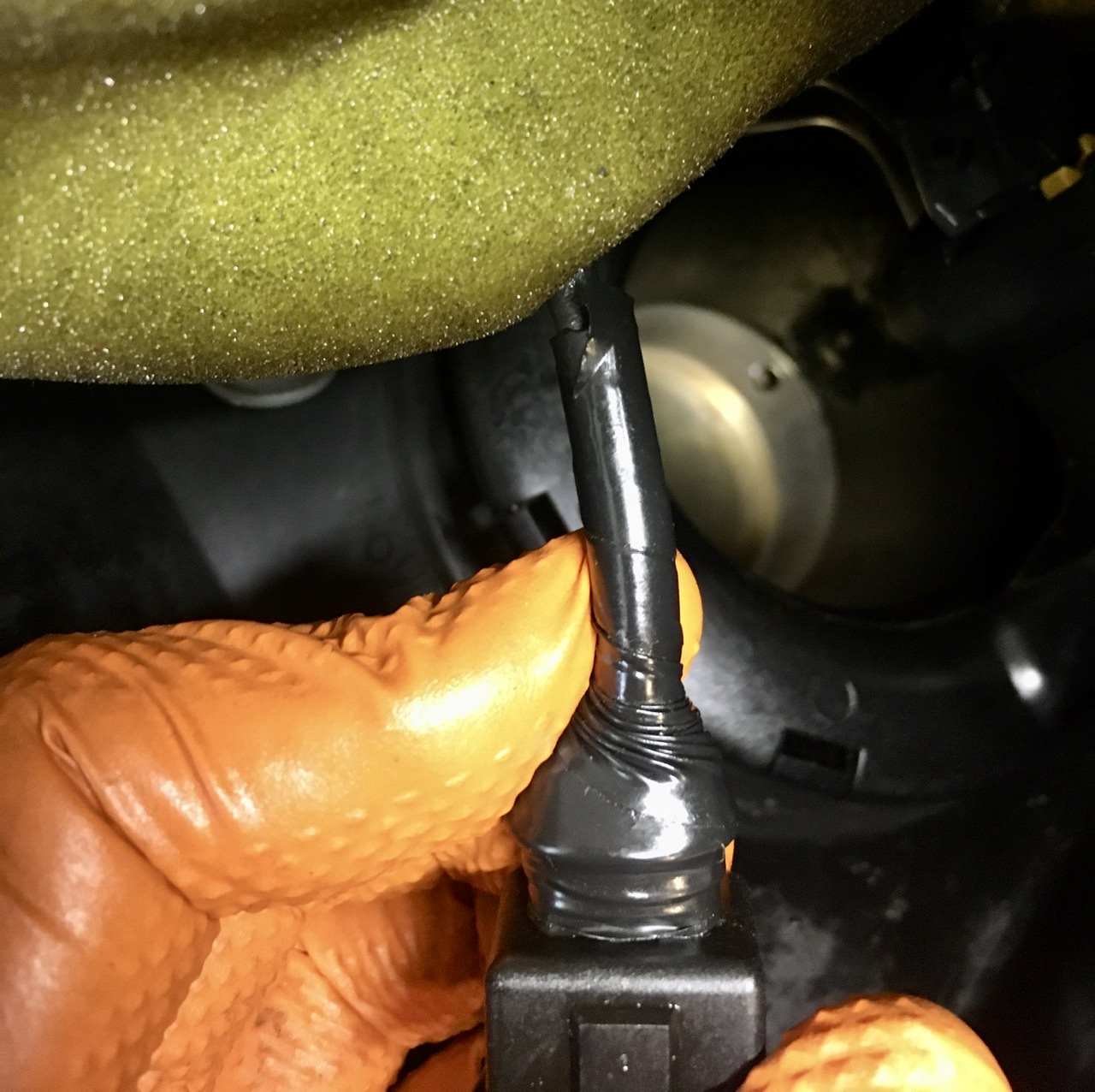

  14. So what's the manufacturers name moulded into the TPE :thinkingface:
  15. Hot = more a sign of lean rather than rich. I reckon that first 150mm is running at about 800-900C with that colour...
  16. TPE :thinkingface:? Thermo Plastic Elastomer? Do you mean the breather pipe? If so, none, niet, rien, nada. I looked everywhere on it, no maker’s marks at all.
    On the other hand the one that was on there clearly wasn’t petrol résistent which explains why it kept disconnecting. The end connected to the Y piece under the tank has swollen as can be seen in the photo below. The pipe also had a big hole in it due to being incorrectly routed and touching the vertical exhaust :(.
  17. On the plug in bit - you can see some letters in your picture :eyes:

  18. Oh, the HT lead. I’d have to pull it out to check if it’s more than the MTA you can see in the photo, and I’ve put all the bodywork back on now. I’ll take a look next time for you:upyeah:
  19. It might point to the correct car replacement part o_O
