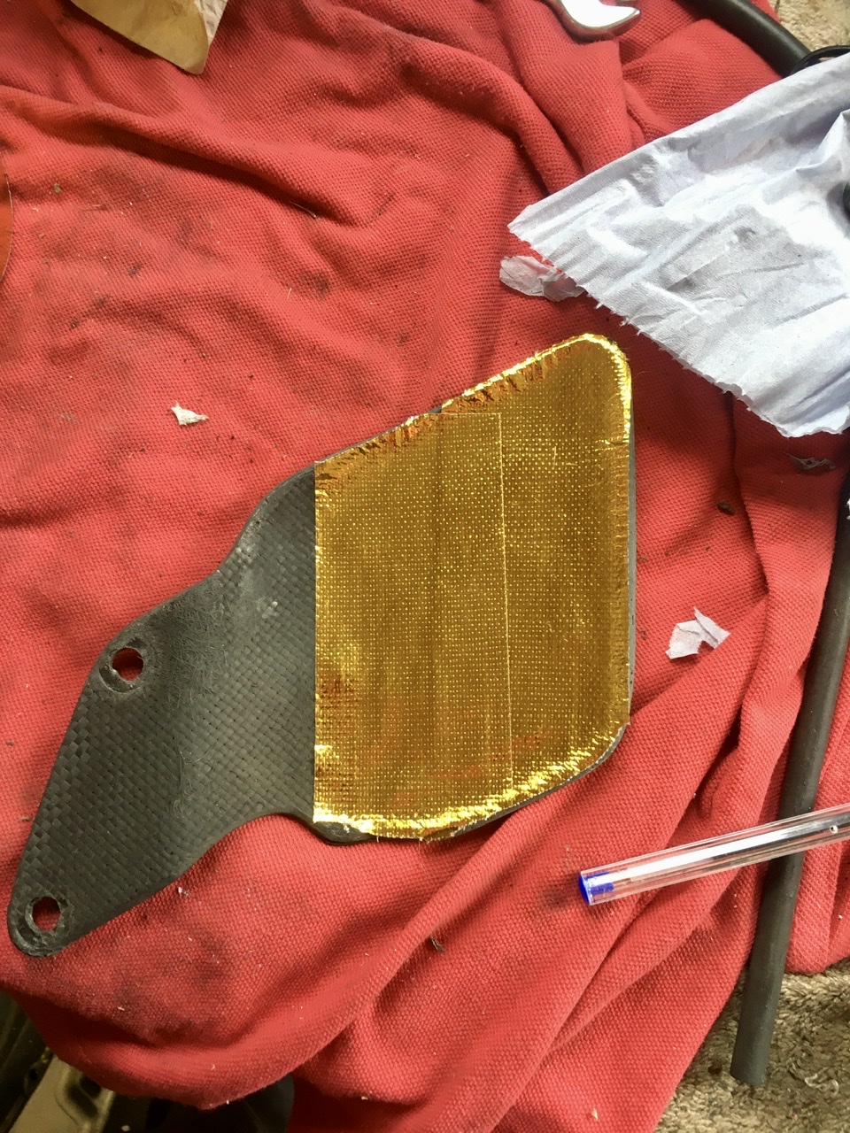

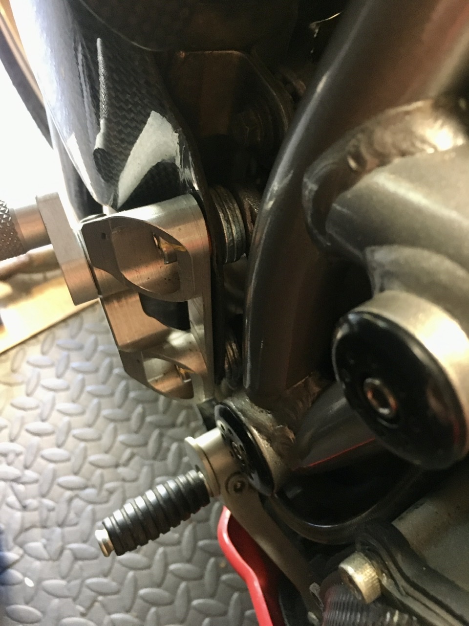

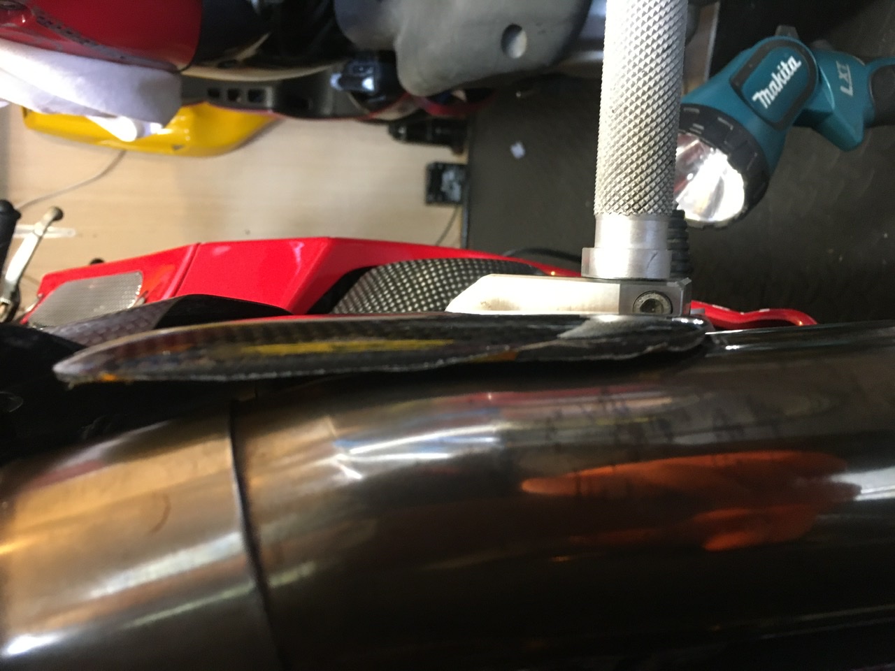

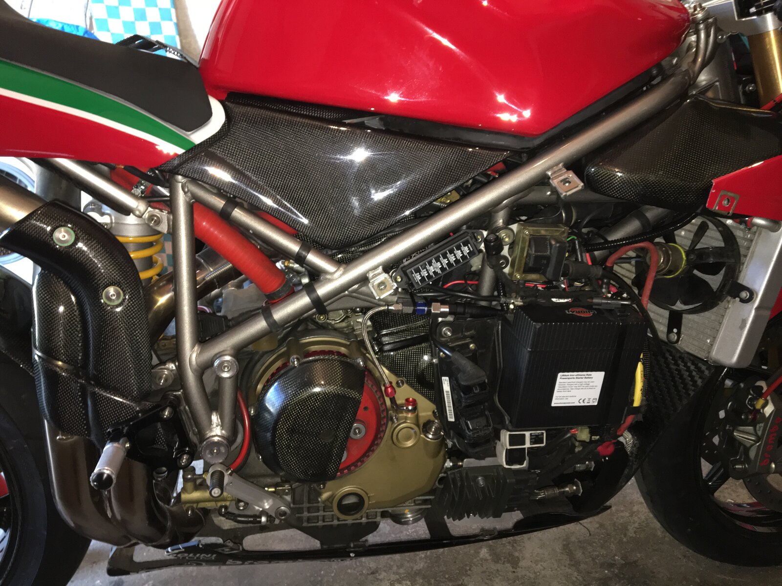

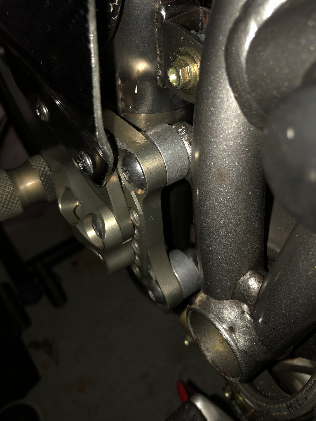

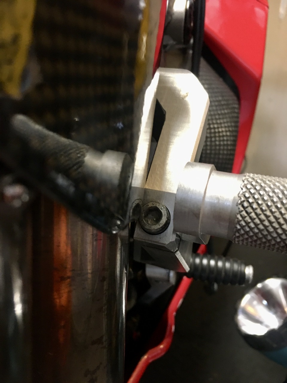

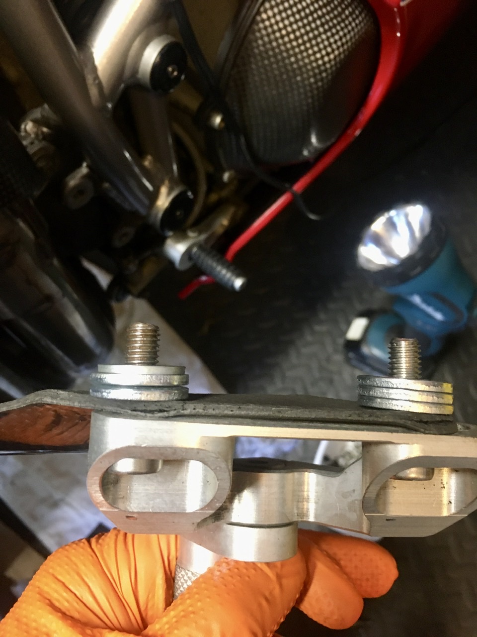

  13. As I fitted wider exhausts the right hand rearset had to be spaced out, no way it was going back on with the 50-54mm link pipe in place. Temporarily I used 3 x 2.5mm washers I had laying around but I’ll have to pick up some proper collars, maybe 10mm as even with a 7.5mm space out the rearset, and especially the CF heel guard are still too close to the exhaust IMO. I’ve applied some heat tape to the back of the heel guard just in case.
    B4C45A00-0C15-4058-BA94-03F87E4D2259.jpeg 36EAE2AF-C34B-469D-B718-F7436F8C5A38.jpeg CBE30932-E316-43BF-A9E3-B38BD1B6ECAE.jpeg BF075B51-7EFE-4B17-9619-85EC27B8BBA1.jpeg EE753E90-6FF6-406D-BEB7-66B5827E93A0.jpeg

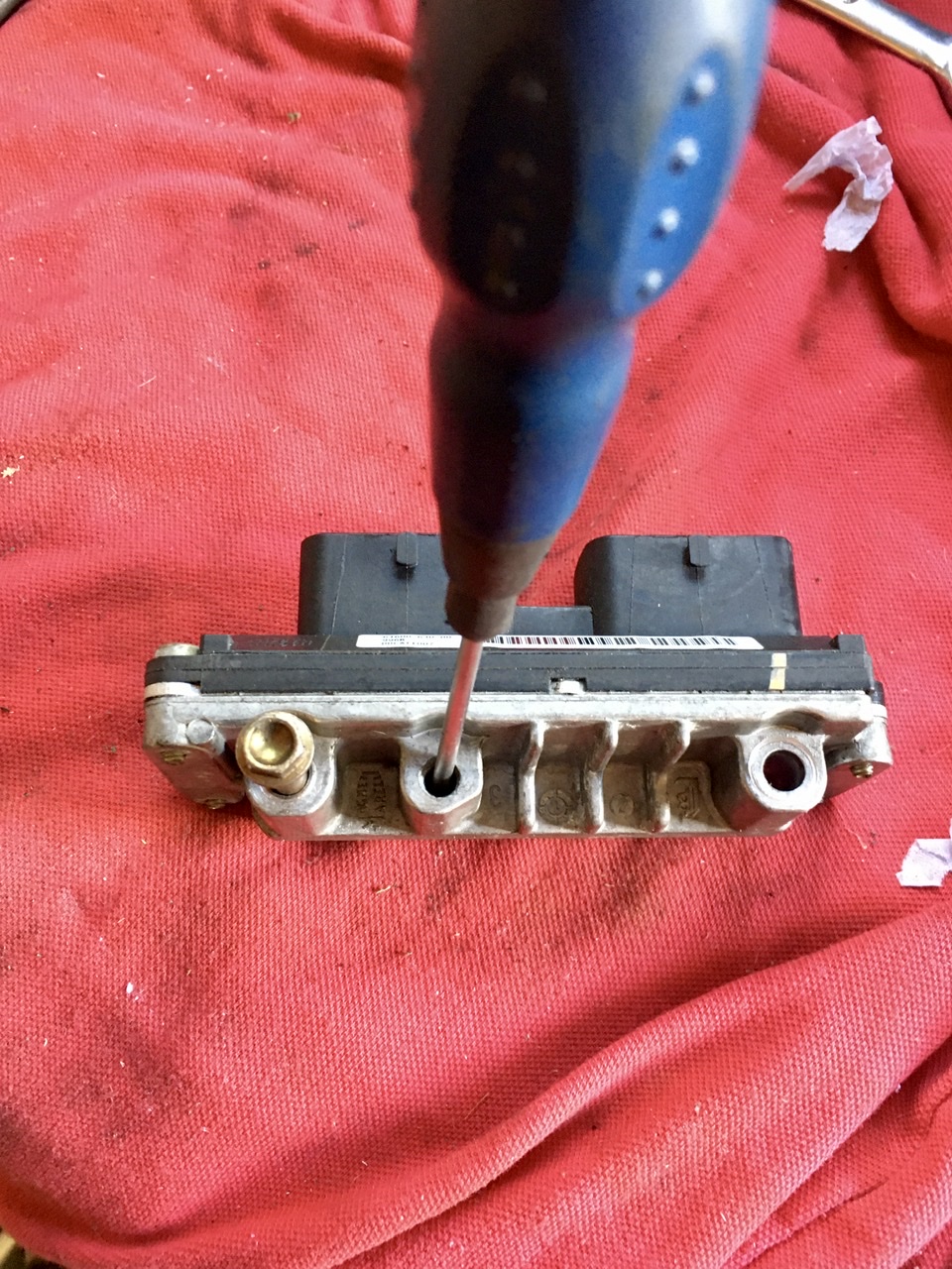

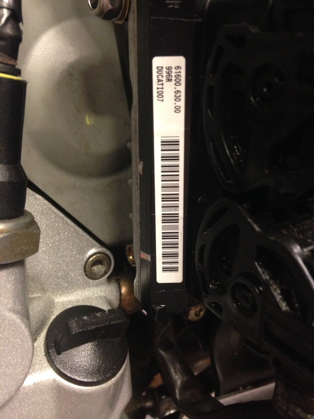

  14. When I removed the original ecu in order to replace it with one for 50-54mm I discovered it was earthed via one of the 2 bolts which secure it to the battery holder. As the battery holder is plastic and as the bolt is a 6mm bolt which passes through an 8mm tunnel in the ecu casing this doesn’t to me seem to be quite right. Especially as there’s a threaded 6mm hole directly beneath it which would be a much more secure earth. With a 6mm bolt in an 8mm hole it wiggles around, I just can’t see that’s the right place for it to be earthed.
    It’s now earthed into the threaded hole beneath, making a secure and consistent earth. That’d be the one with the screwdriver stuck in it in this photo.
  15. image.jpg I think my old DP rearsets had spacers.
    The Gilles ones are about 10mm.
  16. Top hole in the ecu. I taped those unsightly wires up as well. :)

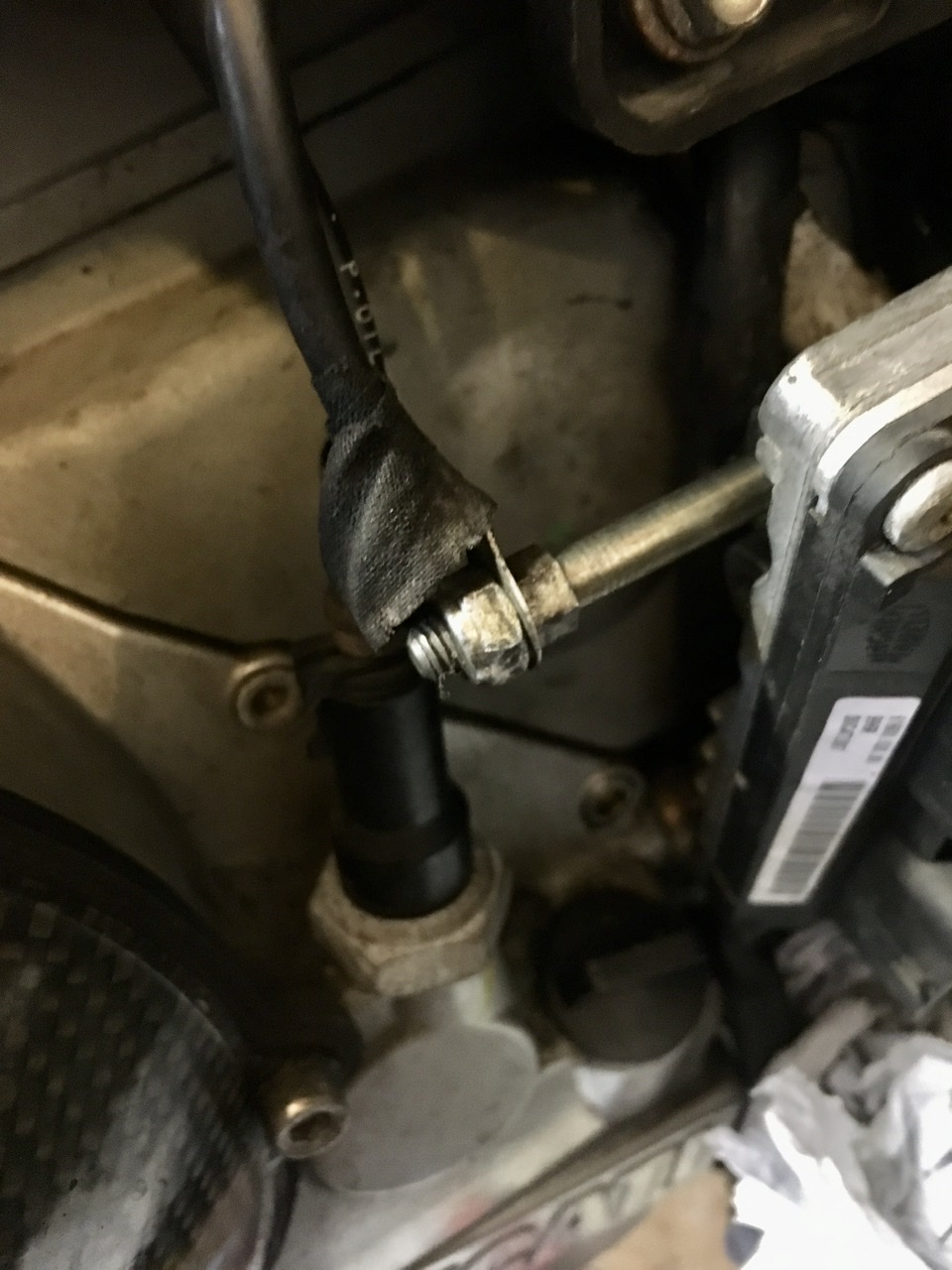

  17. Changed it to a pressure sensor for the digital dash.

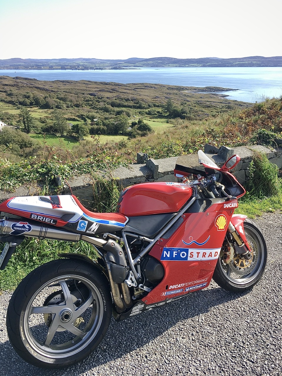

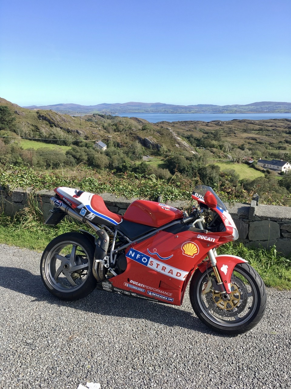

  18. Took her out again yesterday in the sun, now the dodgy connector to the injector’s been fixed and the exhausts are correctly fitted she starts first time and runs like a dream, no flat spots, no stuttering, perfect fueling (nice ecu @funkatronic , thank you).

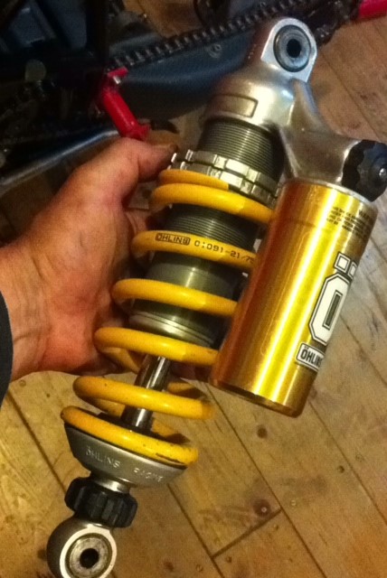

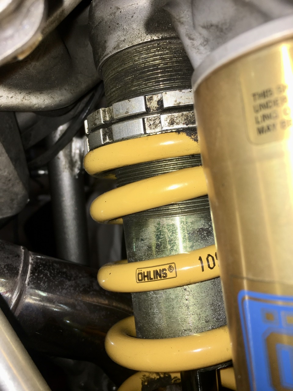

    However, the suspension needs some fettling (apart from the dirt which will get removed over the winter). The front’s ok but the back is way too harsh, bounces me all over the place and out the saddle at times. It’s not nice on the roads around here at anything over 75 unless the road surface is newly laid and race track smooth.
    The spring is 1091-21 75 designed for 90-100kg riders with full gear. A bit light perhaps for me as I’m 97kg in the buff. I suspect however, it’s presently got too much compression applied, see photo.
    I know they’re different shocks but the Showa on my 748 has only 5-6 threads showing now I’ve set it up correctly this has about 13 and the spring rating on my Showa is about the same as this one ie 75Nm.
    I’ll have to book some time in SWMBO’s diary so she can help me set up the suspension properly for me.
    Gratuitous photo shot :D
