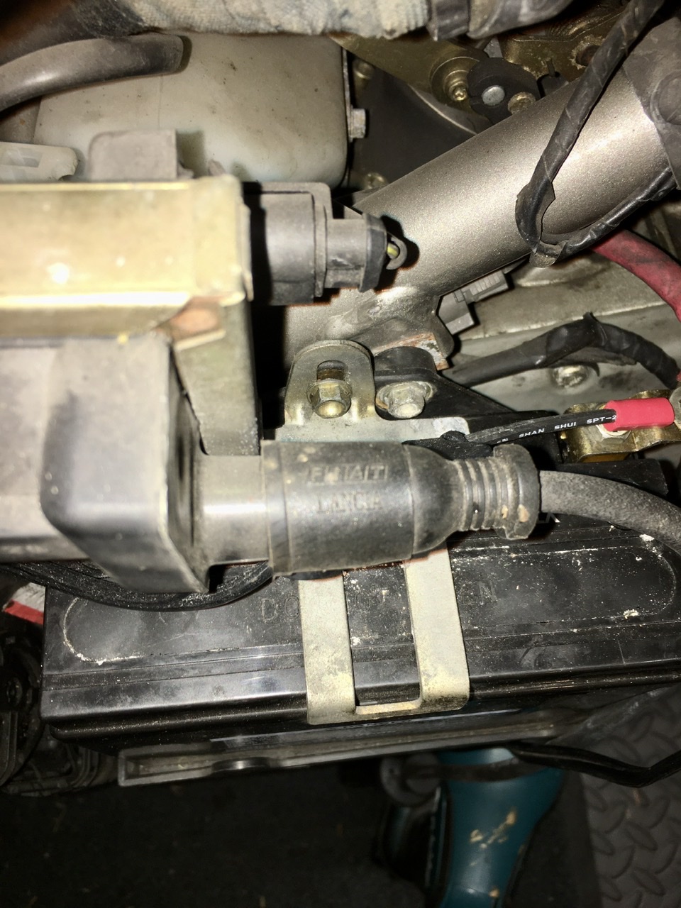

  13. I have a problem with an intermittent misfire which I traced to the front cylinder. I ordered more spark plugs and today’s job was to put a new one in the front cylinder to see if that cures it.
    New spark plug goes in no bother, while I’m down there I happen to notice the lead from the coil is stamped Fiat Lancia. 6F01E5E1-E022-498C-BD00-E148B34427C0.jpeg
    Ehh? What’s going on here? Someone must have replaced it at some point and used a part from a car that’s cheaper for the same thing:thinkingface:. I’ve no issues with that. However, I go to refit the plug cap in the cylinder and realise it’s all to easy to slide in there, doesn’t feel as though it’s really pushing down on the spark plug:confused:. Pull it out, push it back. Nah, that just doesn’t feel right. Pull the old plug out of the bin, push that into the plug cap, a nice tight fit, need to exert some pressure for it to go fully home:upyeah:. So what’s up?

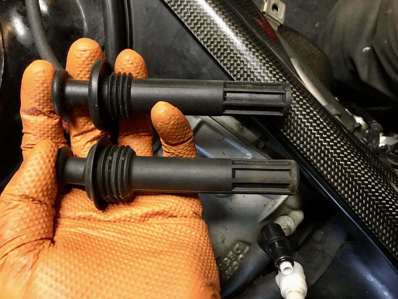

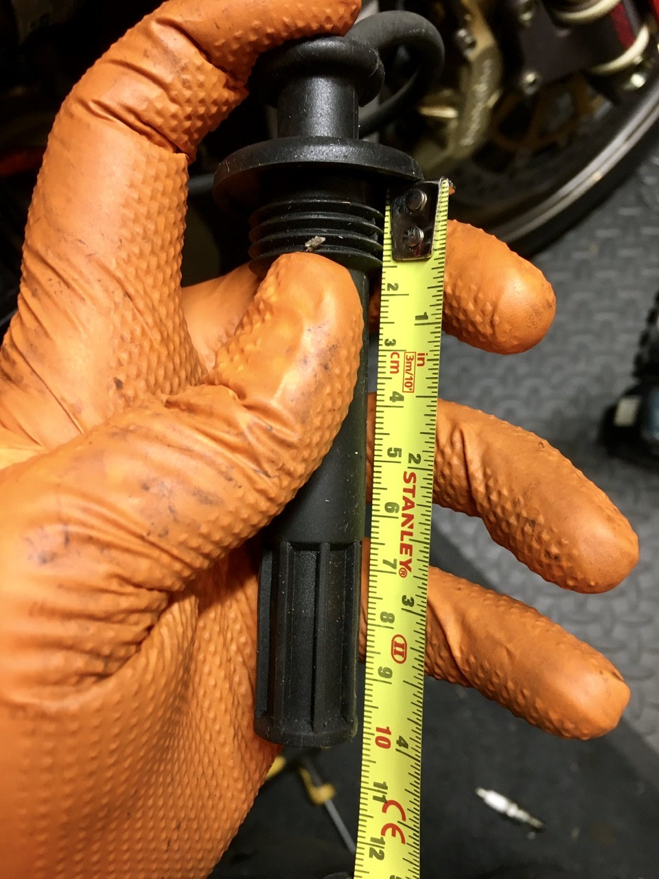

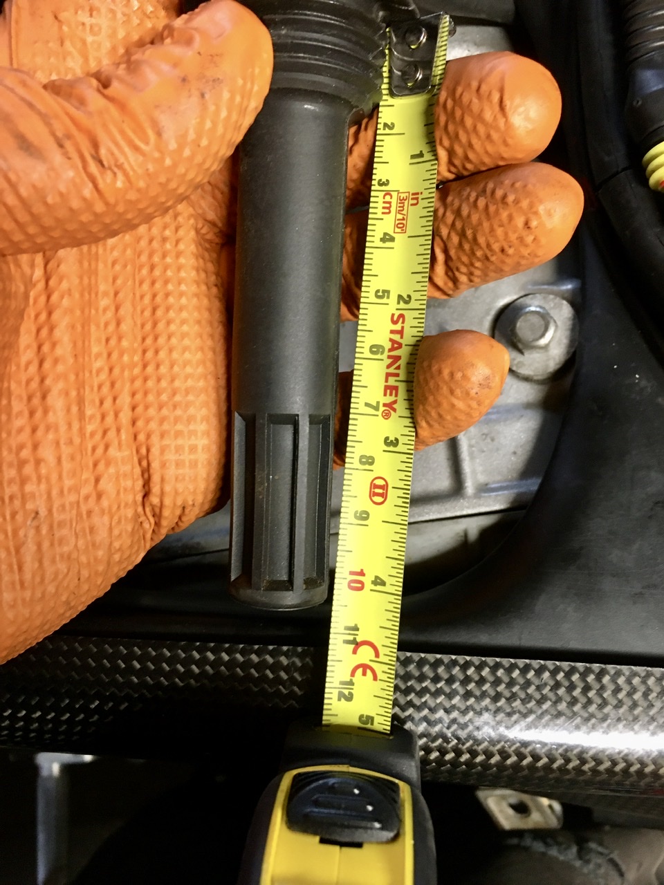

    I get the tape measure out, measure the depth of the hole in the cylinder head to the top of the plug and check it with the length of the plug cap. WTF, it appears the plug cap isn’t deep enough, the top of the plug will only just kiss the socket for it inside the plug cap:thinkingface:. Whip the tank off to check the vertical cylinder (thank goodness these bikes are easy to work on:upyeah::)), it’s the original part, no Fiat logo, and sure enough the vertical one needs a firm push to get it to seat home, unlike the horizontal one:confused:.
    Out comes the tape measure again. Turns out the vertical cylinder plug cap is 10.5cm from base of the weather seal to the end whilst the Fiat part is 10cm:astonished:.
    Horizontal cylinder - 10cm
    Vertical cylinder - 10.5cm
    The two side by side
    I’m now thinking the horizontal plug cap wasn’t making a good & firm connection to the plug:(. Now I’ve got to order up the correct part and wait a week or so for it to arrive:(. Bums:mad:.
