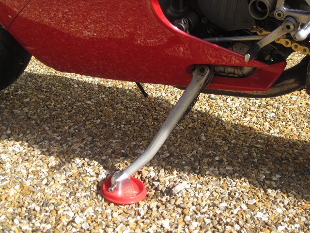

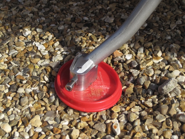

  4. Had one of these made in the machine shop where I work. It looks a bit like a club foot but raises the stand by 20mm and has something to get your toe behind to hook it out And no, the red bit isn't part of it.
    It's attached by 2 off M6 Socket Heads so the stand had to be drilled and tapped. . Works a treat though.
  5. Haha. Ginge's 916 has a club foot.
