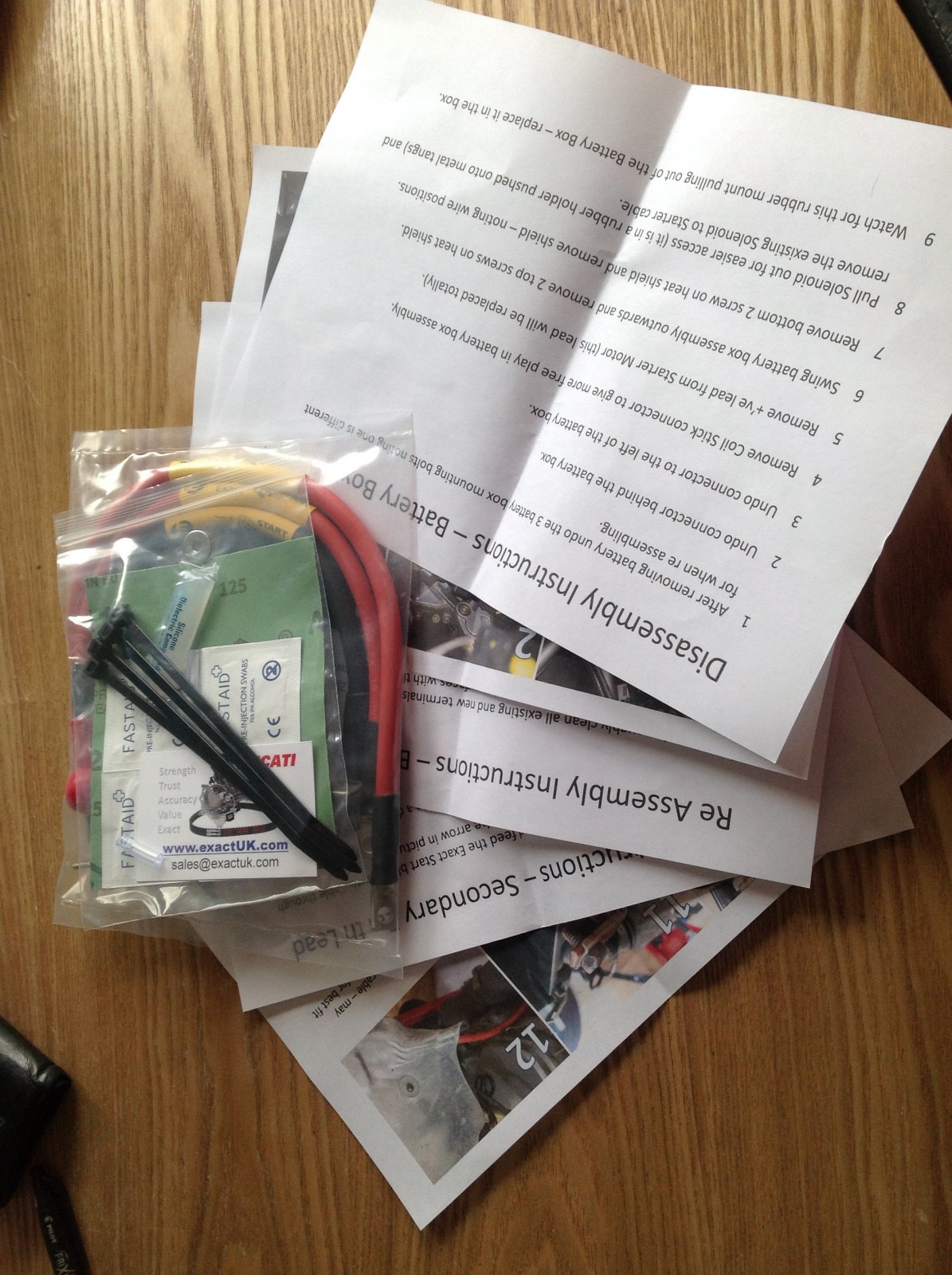

  13. Just to let you know mine arrived this morning ... And after coffee ..I'm on it ..will let you know how I get on ... :upyeah::)
  15. The instructions are upside down - I'm sure I put them in the package the right way up? :Wideyed:
  16. You did ...I thought I'd show NZDave what they looked like :Angelic:
