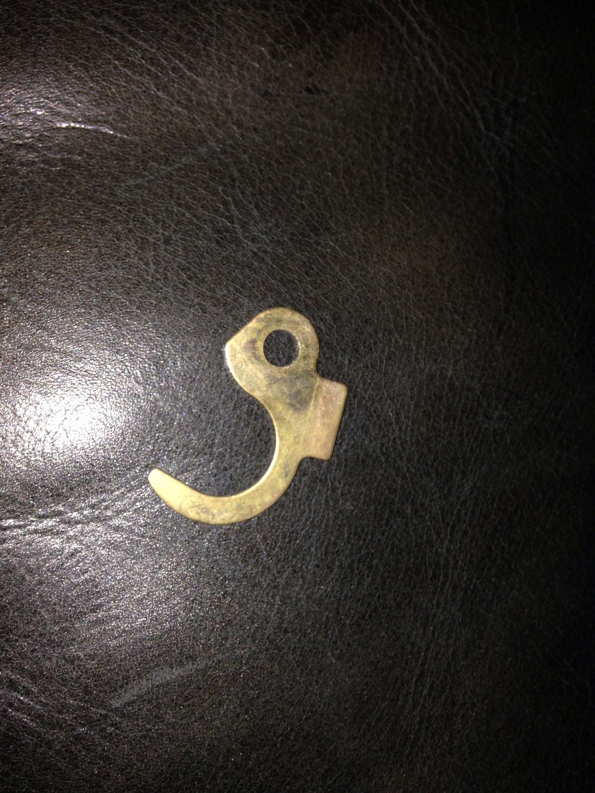

  11. I had prob with 999 start. The crank position sensor gap was too big. Whipped the horse shoe shim out from under cps. Sorted

  14. My bike would just turn over ocaisionally start. Glen, Moto V advised me to remove it. Safe to do. Remove screw, raise cps, it wont come right out. Whip out shim. Refit.
    My bike is 05 999. A lot of bikes at that time were over shimmed. Starts fine since. image.jpg

  15. Id be double checking the gap to the trigger wheel to make sure it's not making contact with it.
    I fitted mine with a .6 mm gap.
  16. I was told not to worry about it by Glen.
  17. yip. remove shim if your worried get someone to crank it while you push it in. you will feel it touching the phonic wheel. before i diagnosed mine correctly i filed it so it would go further in. (common fault with punto diesels same sensor i think or v.similar at least)
  18. Yep removed the shim , still no spark at either plug, will try the back wheel to remove starter possibility, waiting for muscle as need three arms ! Can it be the data alarm 3 ?
