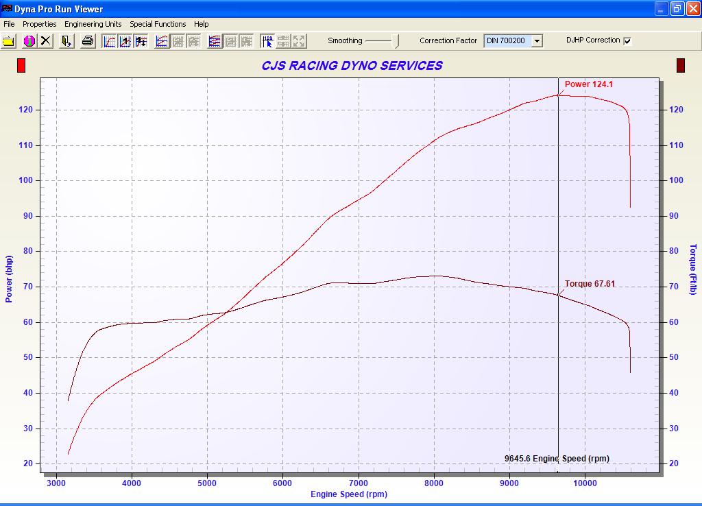

  10. Ideally, drop Chris a line and see if he can let you have the in gear ones, where you can see how it changes and decide where best to set a shift light. I'd say 9250 would probably be about the ball park.
    Gearing commander also has that option using the gearing charts to give you an idea :)
  11. I think you guessed I'd missed a zero off...its 500 to 1000 short of where the limiter comes in is normally max power area still and drops down to max toque. So say 9250 would put you back to just under 8k so you get instant drive while the power builds. Hope that make sure sense.
