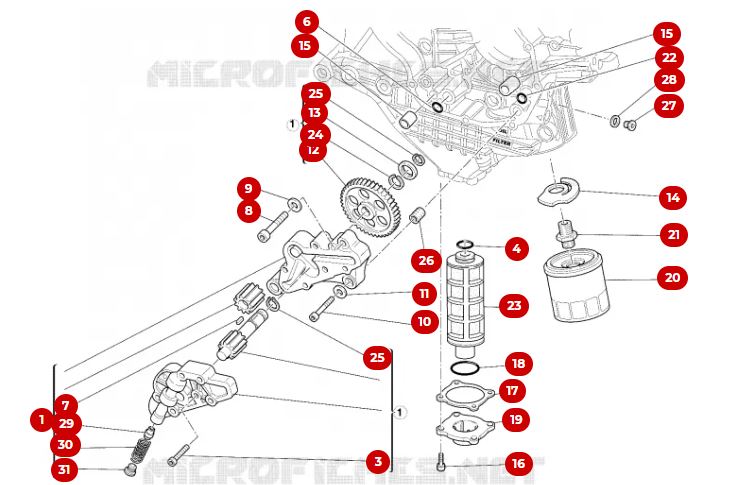

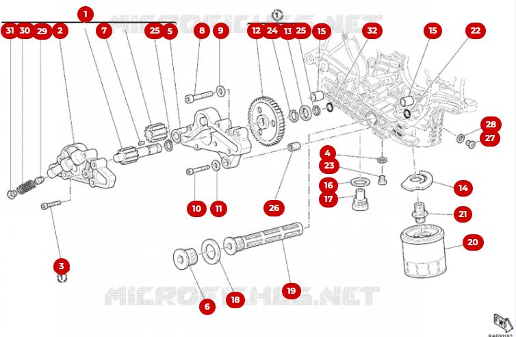

  2. You need to unscrew the filter. Use the same size hex drive you used to remove the plug.
  3. This is what you should have.
    Early Shallow sump:
