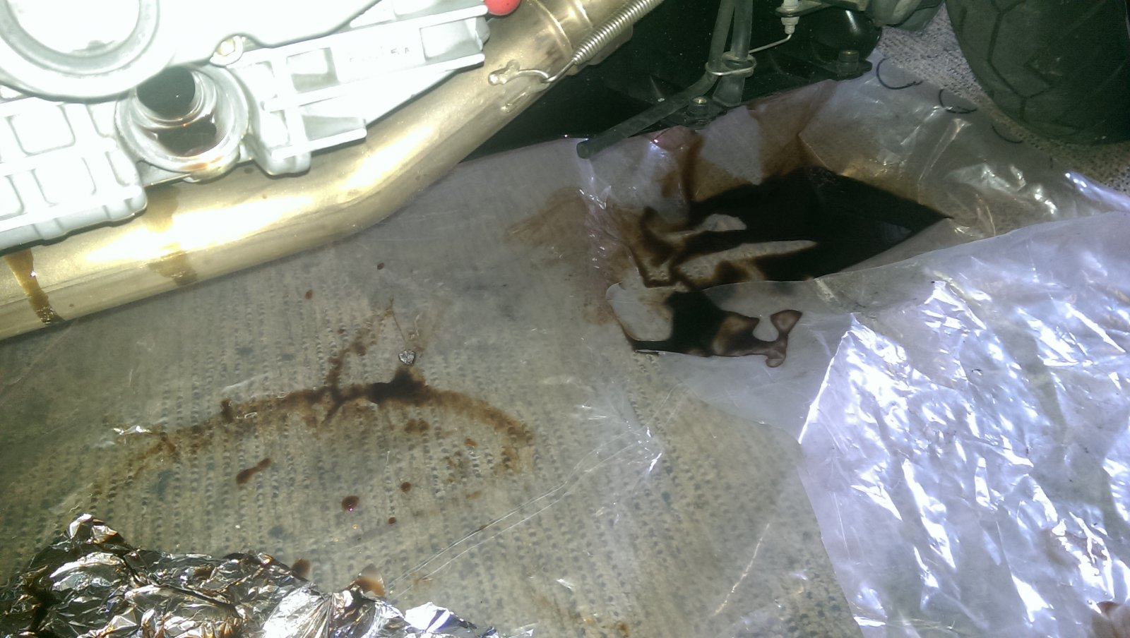

  4. And this children is why we change oil over a plastic sheet:

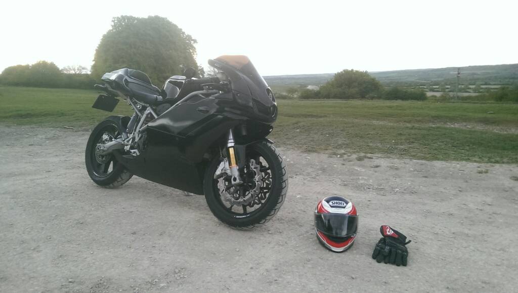

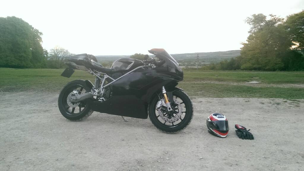

  7. It looks like it is almost at the perfect for you point, I do love the gloss black even though it shows everything. What will you do when it is where you have done everything and it is as it should be?
