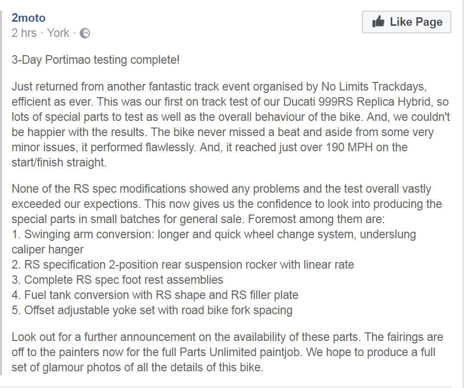

    162BHP and 175Kg :
  3. I don't know what you want me to say, Air Duck. Have you ever been to Portimao and ridden a bike around the track? You might know, though, that the standard dash, which we still use, blank out at 174 MPH, and it blanked out every lap well before the finish line while still strongly accelerating hitting the rev limiter in sixth just before the breaking point into turn 1. So there is a pretty good indication that it exceed that speed by a good margin. You won't be convinced, I'm fairly certain, and that's OK as there is no need. :)
