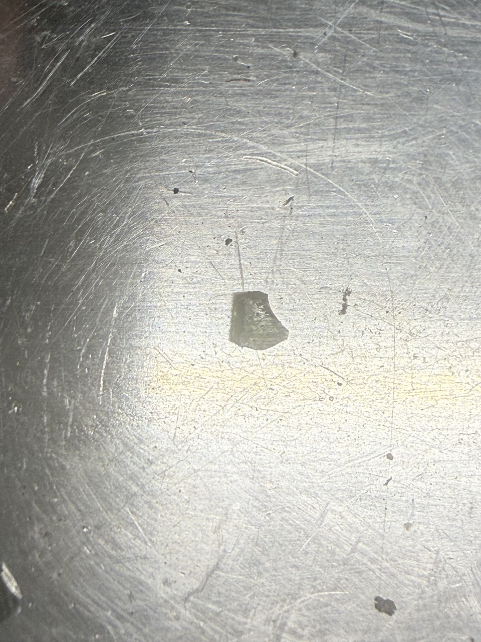

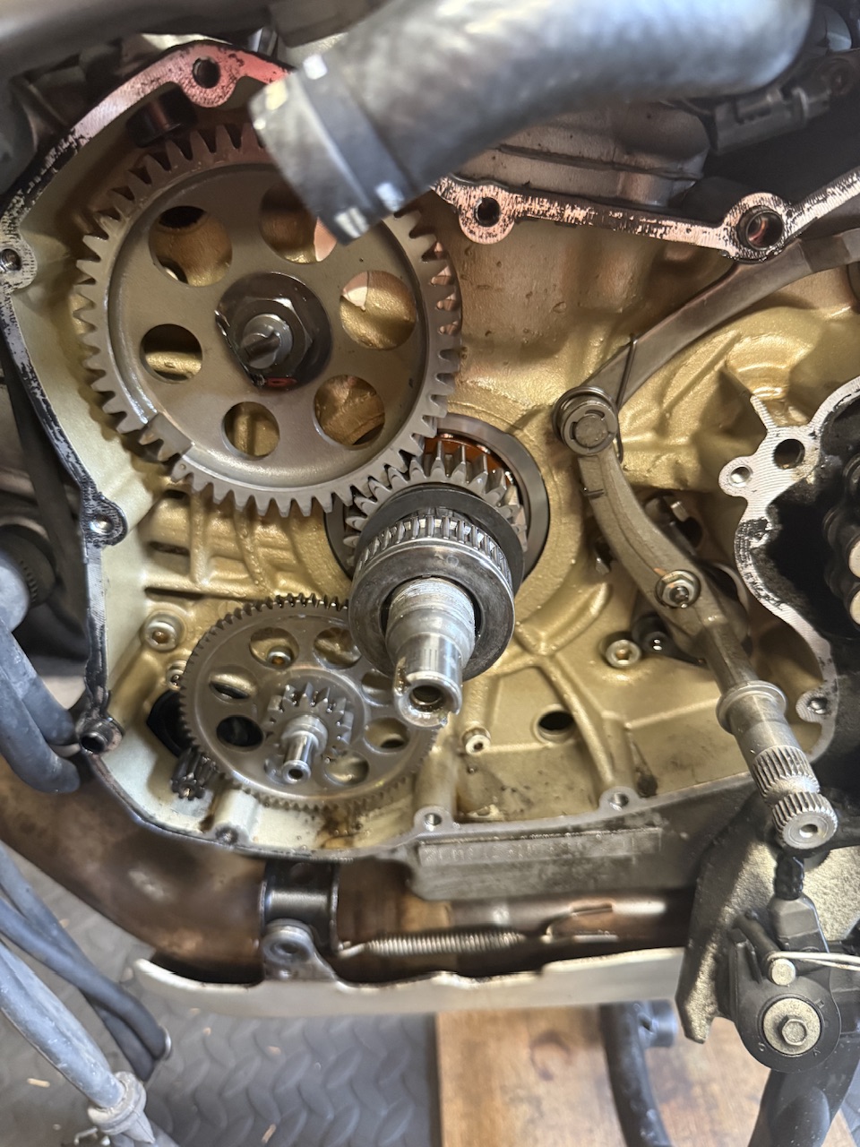

  1. Don't know if these are similar but, on earlier bikes there is a thrust washer under the alternator/flywheel that can get displaced slightly when fitting especially if fitted in the bike so upright as it can fall from behind the flywheel and not be seen.
    Then, when torqued up it is trapped but tightens OK only to then move after it's been running a while.
    I had an ST2 engine in which I found a piece of said washer in the sump and the flywheel was wobbly, after the washer had broken away.
  2. As in Post #117 onwards?

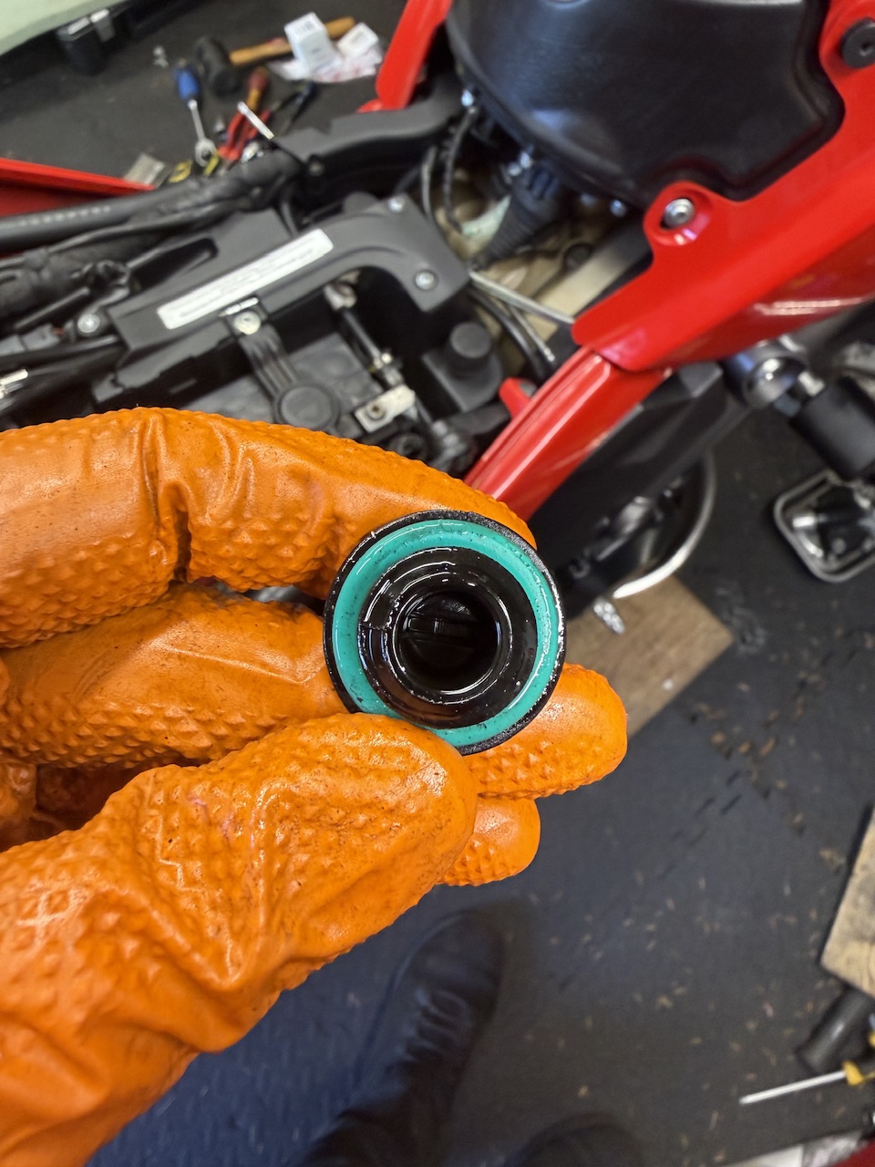

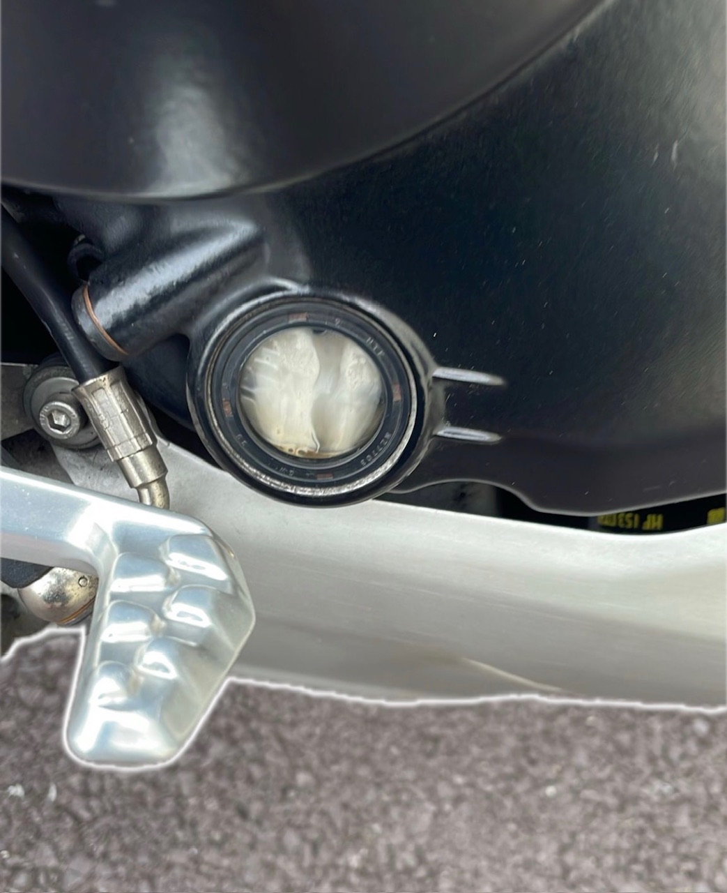

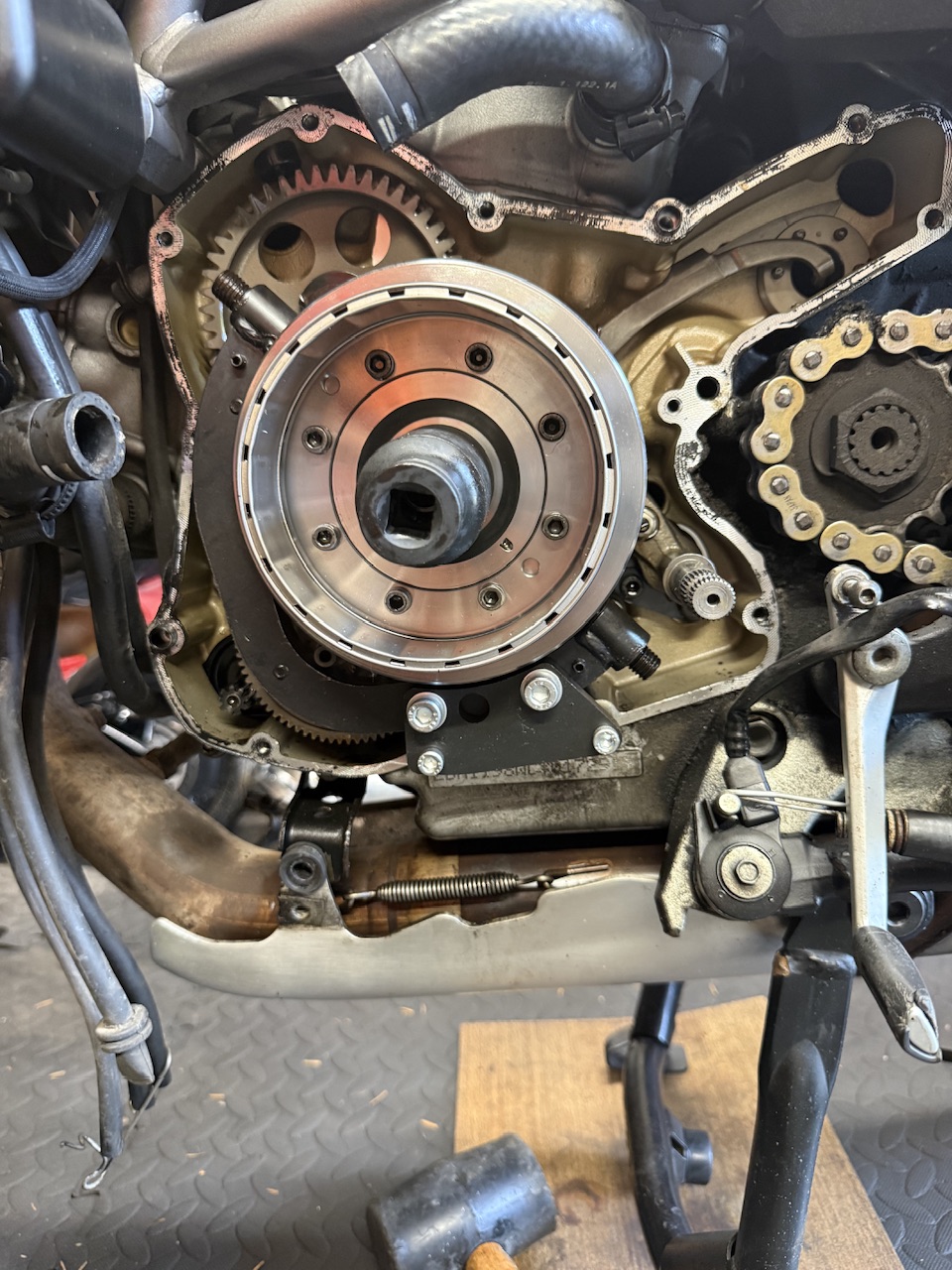

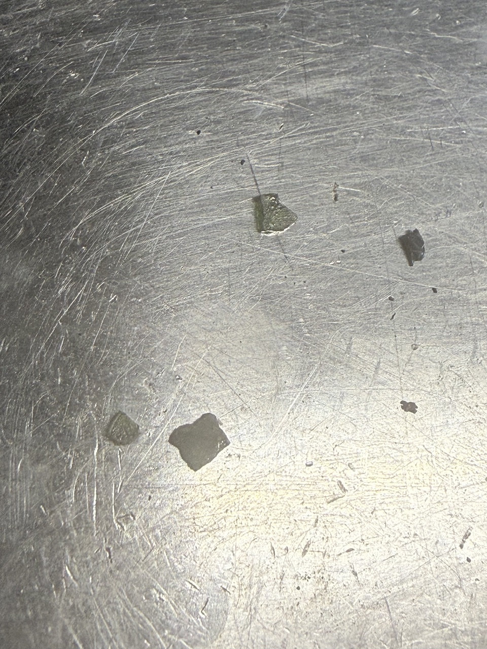

  4. The owner shared this photo with me from before I collected it.

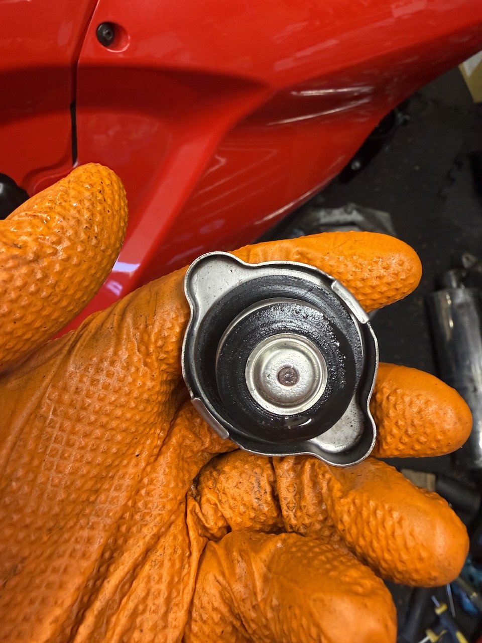

    This, coupled with the unnatural noise from the LHS crank cover, plus all the filings on the sump plug, is what sent me down the path of possibly the coolant impeller shaft bearing(s) having failed and started to break up, along with the ceramic seal thus coolant was getting into the oil.
    However, it turns out that was just condensation as the oil and coolant when drained were as clean as if they’d just come out of their respective containers, which they had, <1000km ago, when it was serviced. Plus, there’s no evidence of emulsion in either the oil filler cap or the rad cap - so all a red herring:confused:.

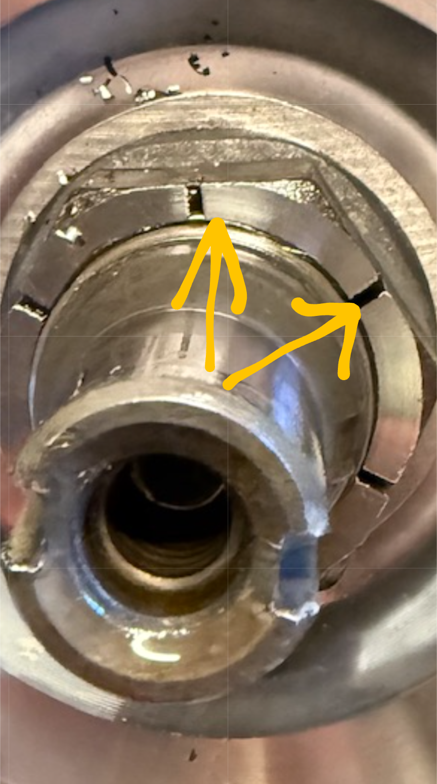

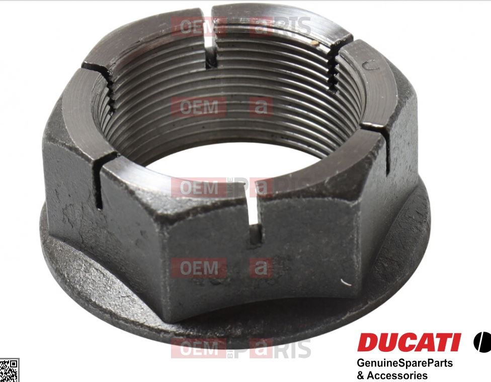

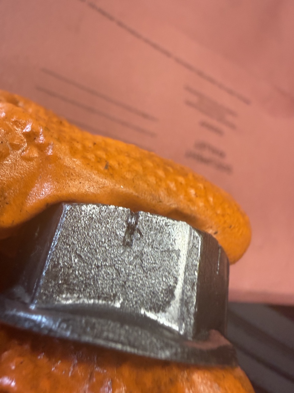

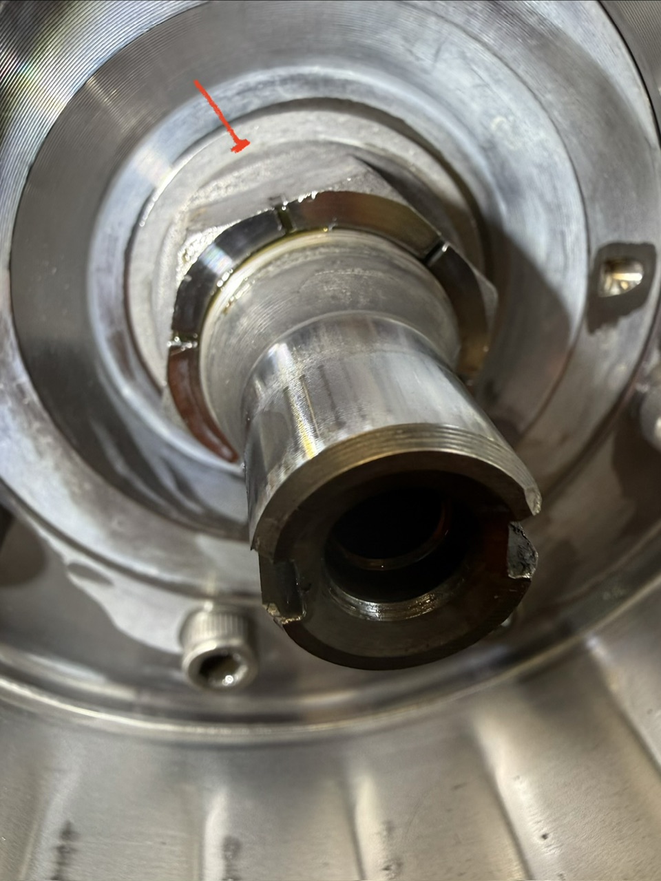

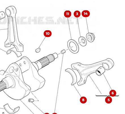

  5. We've all said that the nut looks like it's been rubbing on something, but actually having found an image of one they all look a bit like that:
    It's difficult to see from the images, but could item 11 be missing?
    Item 3 looks like it's there.
    #47 Nasher, Jun 24, 2026
  6. I’d say item 11, the thrust washer, which comes in different thicknesses is this, marked in red.
    There’s no apparent reason why the flywheel would have been off in the past and certainly it didn’t look as though the alternator cover had ever been removed since it was installed in the factory.
