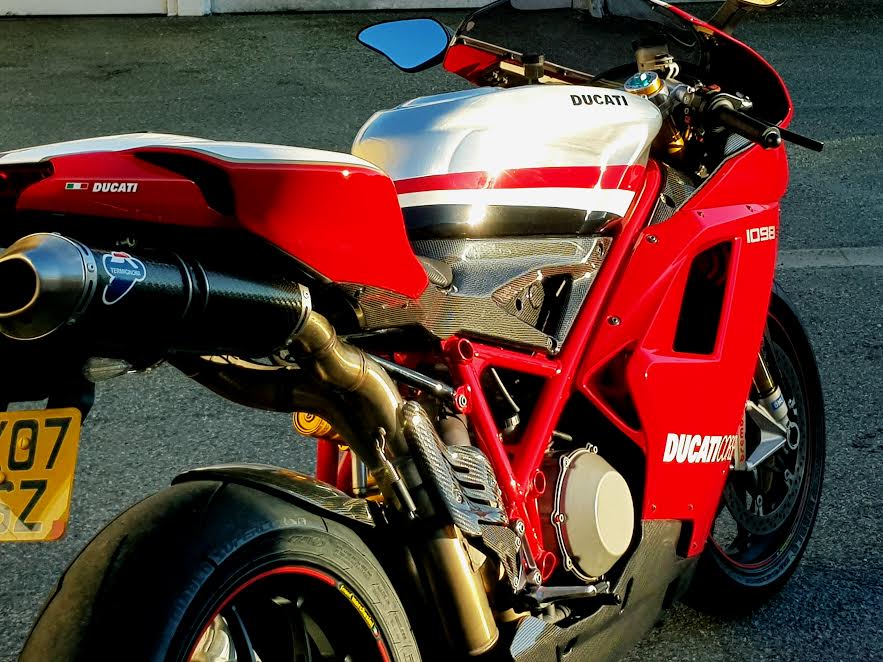

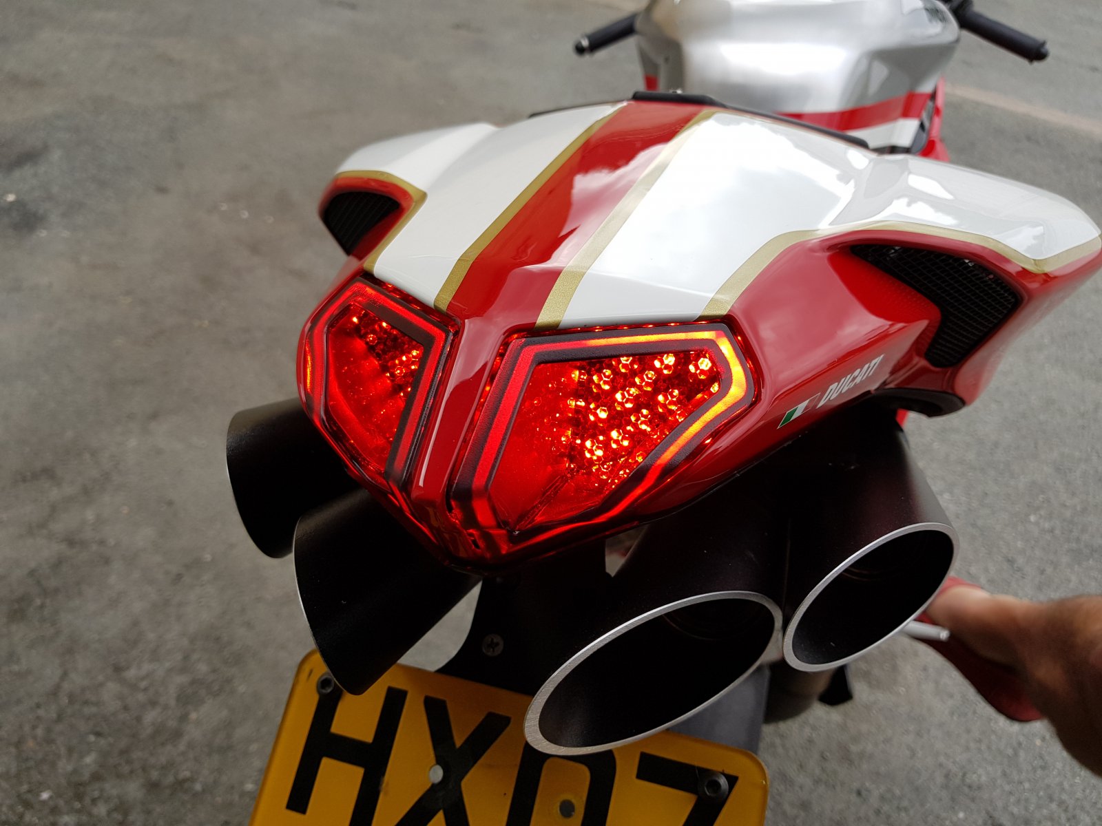

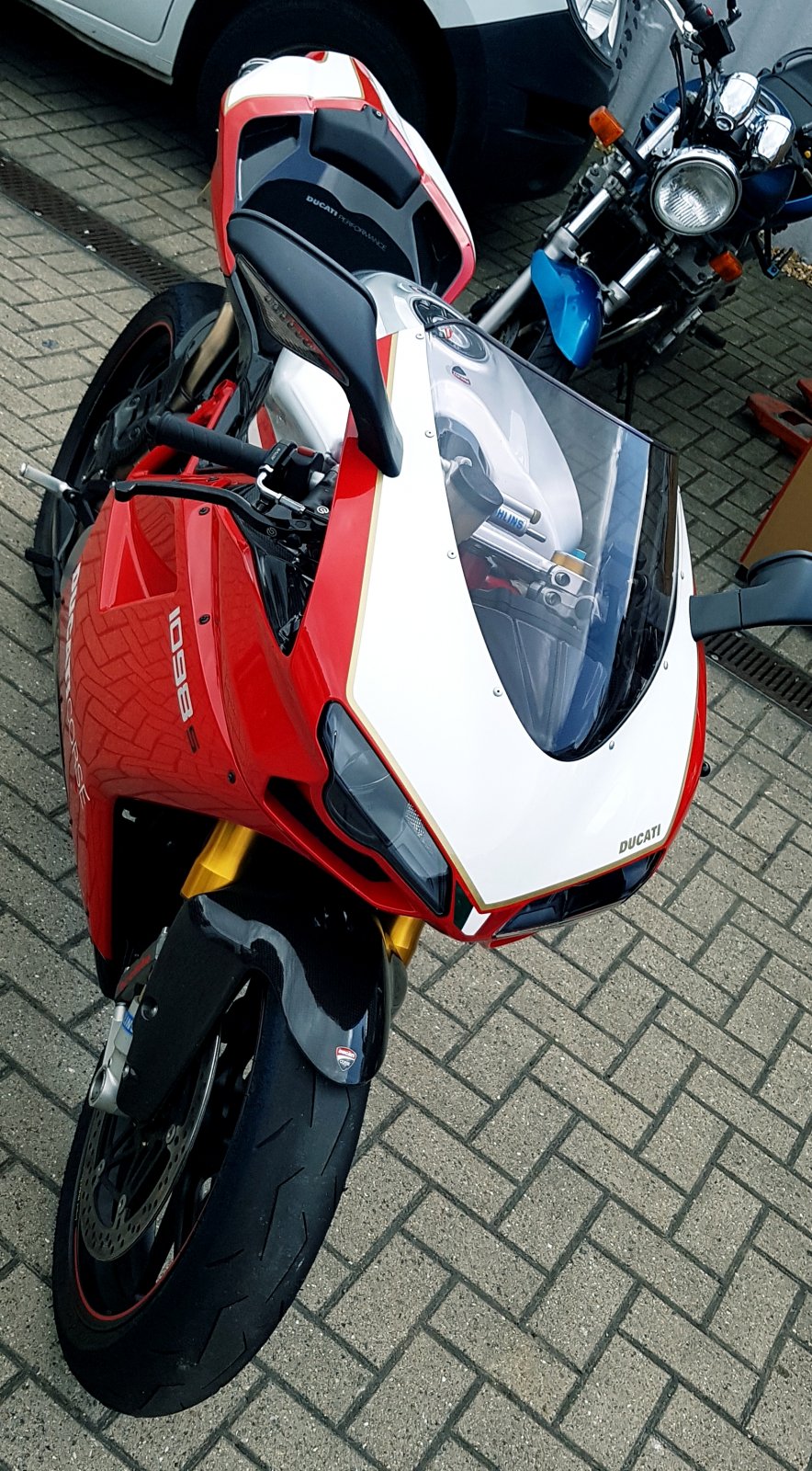

  1. Already a stunning bike, I wanted to take the design a tad further. She has full Carbon fibre bodywork, 1098R hand made tank, R Brakes (amazing) R lights and now has the 4 slash rear system with the R Spec exhaust (larger bore). Ive also fitted the stunning led rear lamp cluster and will upload a video if I can.
    We've sold all the OEM bodywork apart from the 1098S tank and rear seat with detachable seat pad.
    AJ
  2. Is that the Toce system on it in the last picture?
  3. It certainly is Pavey :)

  13. Allow me to introduce myself, my name is Andy and I'm one of the resident anoraks. I'm afraid whoever has been providing you with your information has been bigging it up. The exhaust is a generic 70mm not for road use system designed for the 848 and 1098. Your headers will not fit the 1098R which has the same header fixing spacing as the 1198. Both the 1098s and 1098 R used 4 pot 2 pad Brembo monoblock front brakes with 330mm discs. The 1098R only had a carbon 1 piece under tray and a carbon mono seat and a carbon front mudguard, carbon infills under the tank, carbon air tube covers and carbon belt covers, everything else was composite. Many moons ago Ducati did supply a larger capacity alloy tank at great cost that fitted the 1098R amongst others but as has been said previously, the one pictured looks like it is off an 1198 Corse SE and should have a capacity of 18 litres. All that said doesn't detract from the fact you have a very nice bike that has had money spent on it which I hope you enjoy for many miles to come. Andy
