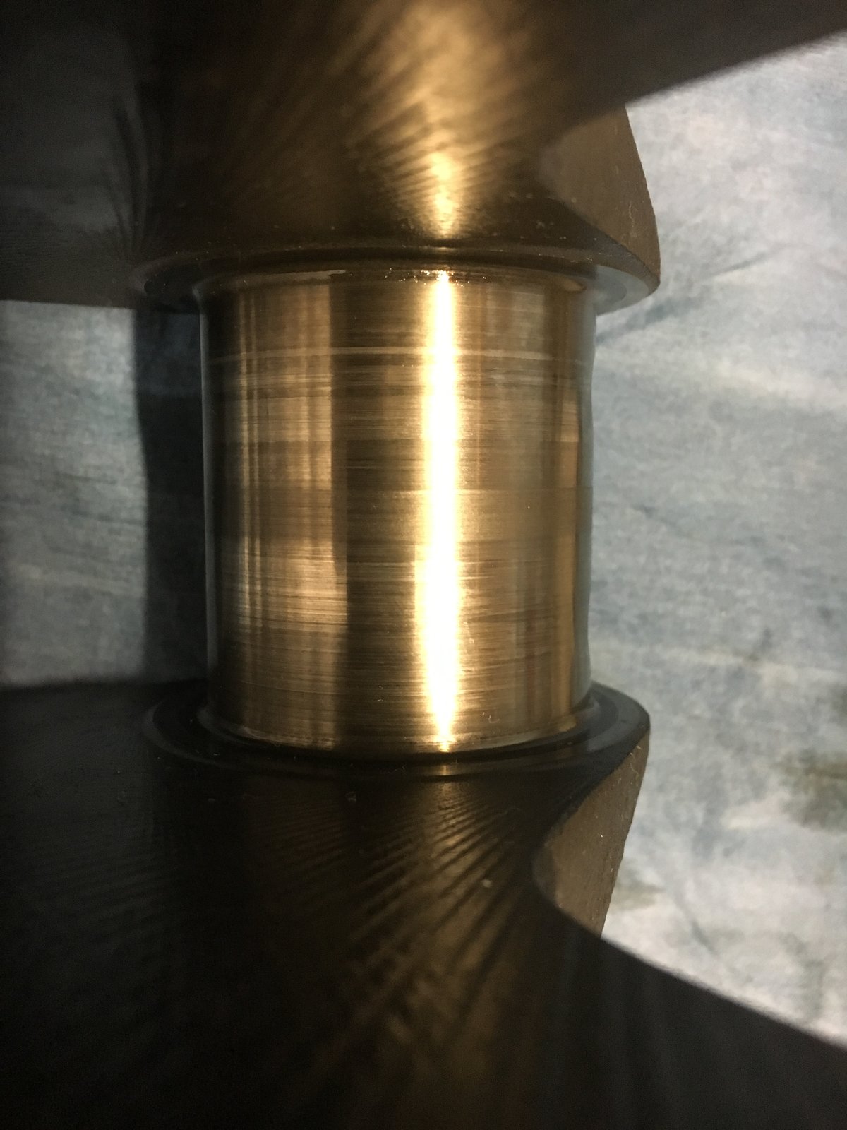

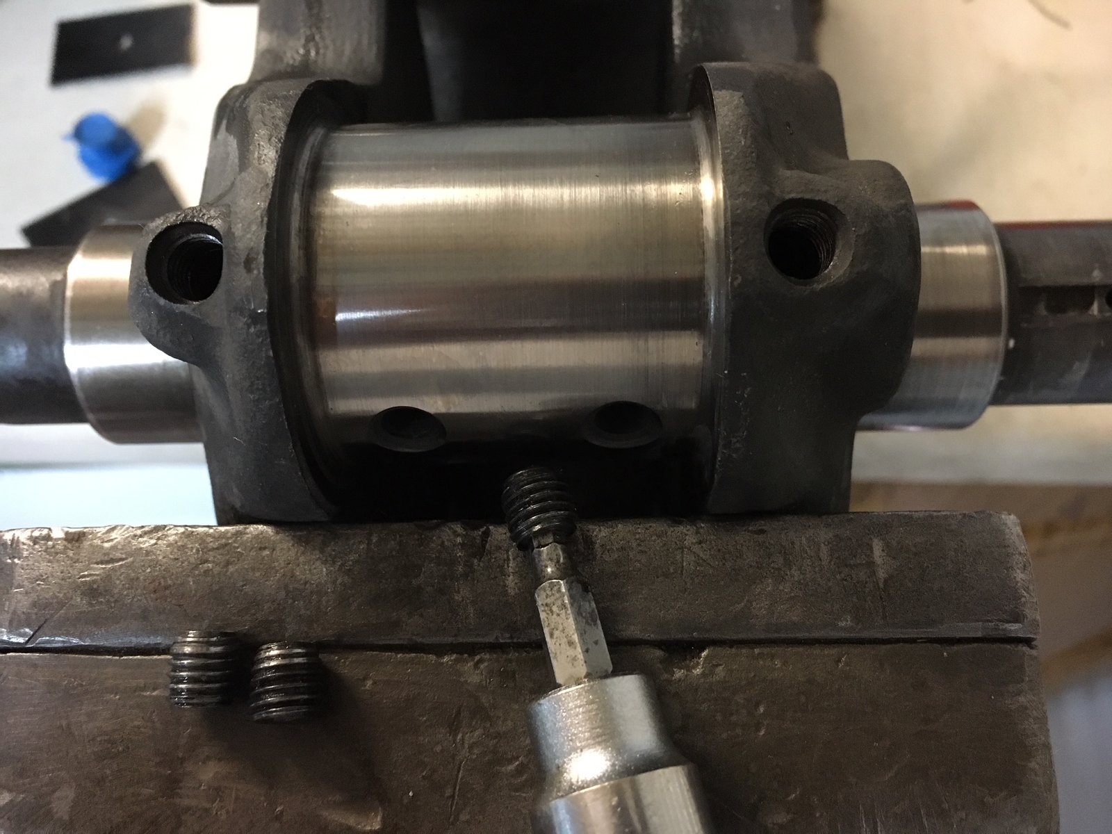

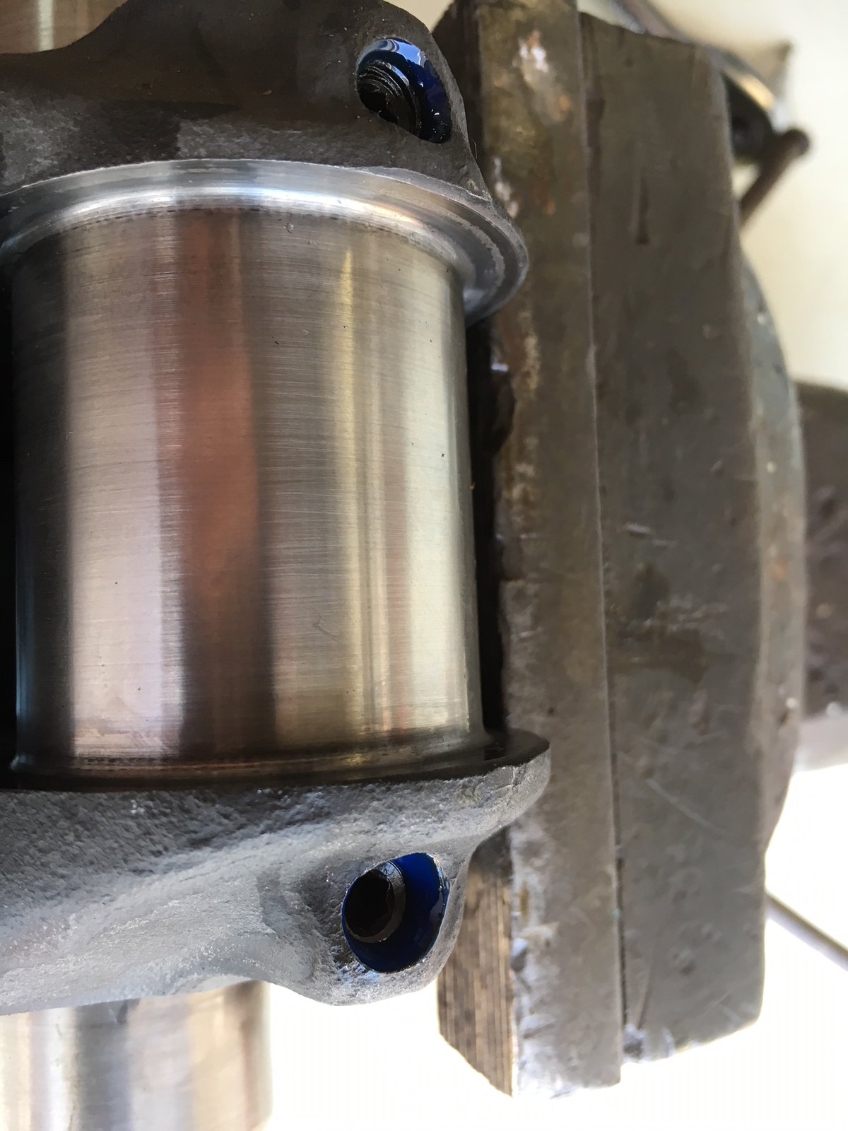

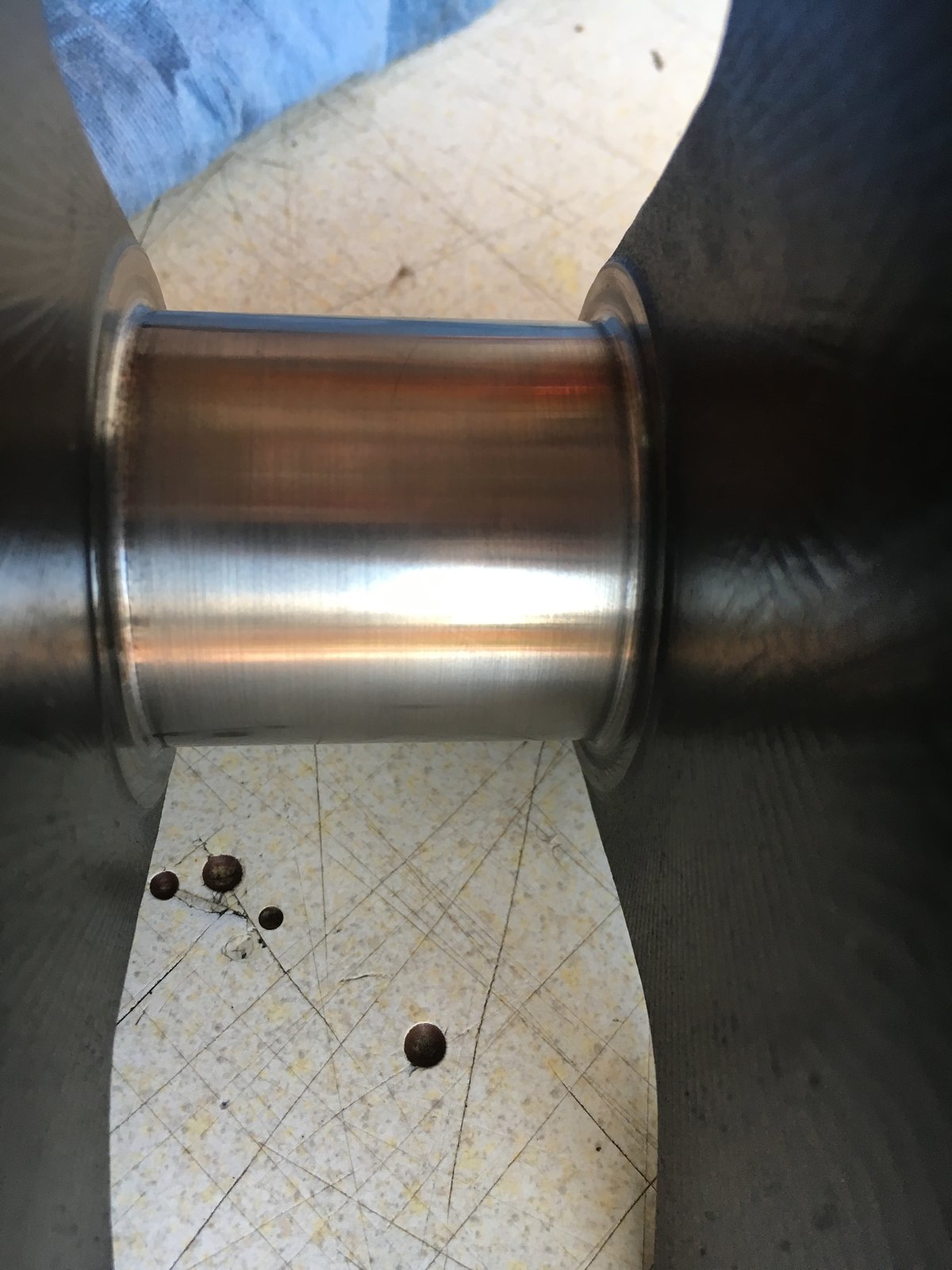

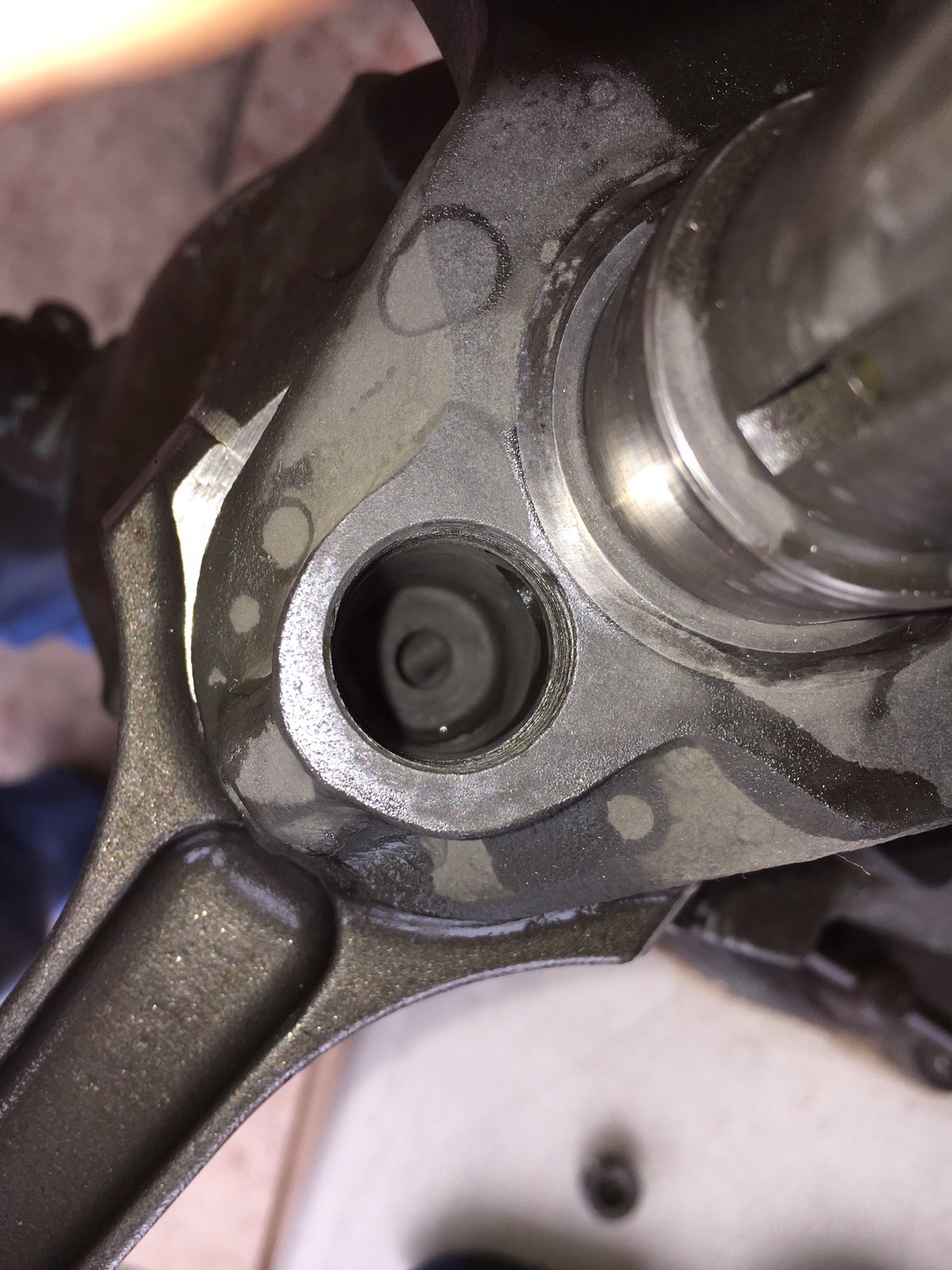

  9. I decided to pull off the conrods, even though there was minimum movement, just as well, pin was not really damaged but needed to be polished. Park engineering at Malton did a good job, and still in spec, so now waiting again for more parts, being a full set of blue BE shells and replacement screws.
    Before and after pics.

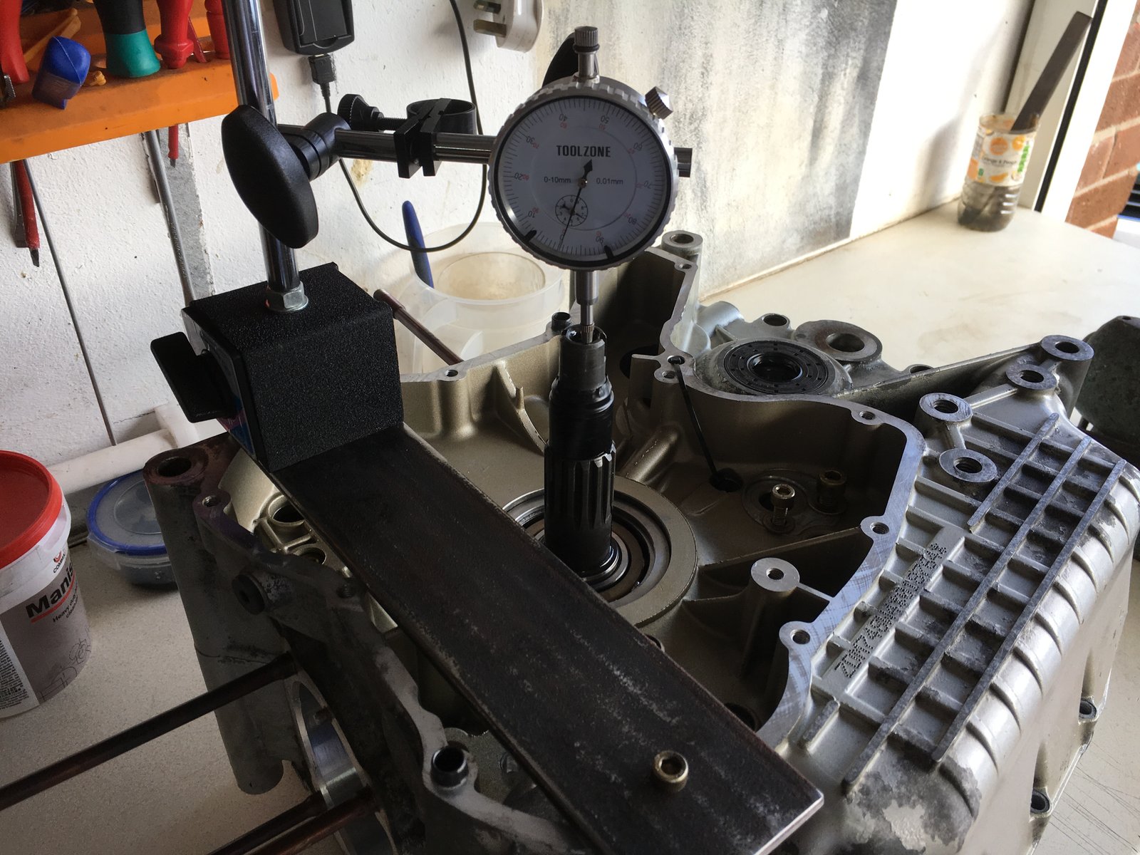

  17. IMG_2040.JPG Checked the end float of my crank, and after a good bit of thought, and googling, decided to go with the 0,15mm preload, this meant buying 2 new shims, 2,15mm Yellow 85211041F from fm_online via EB, saved a few quid on the Ducati price.
    New shims installed to-day for checking prior to doing the BE shells, it feels just as described on the forums, some smooth resistance, and the crank overcomes this when the weight is past the top of the rotation.

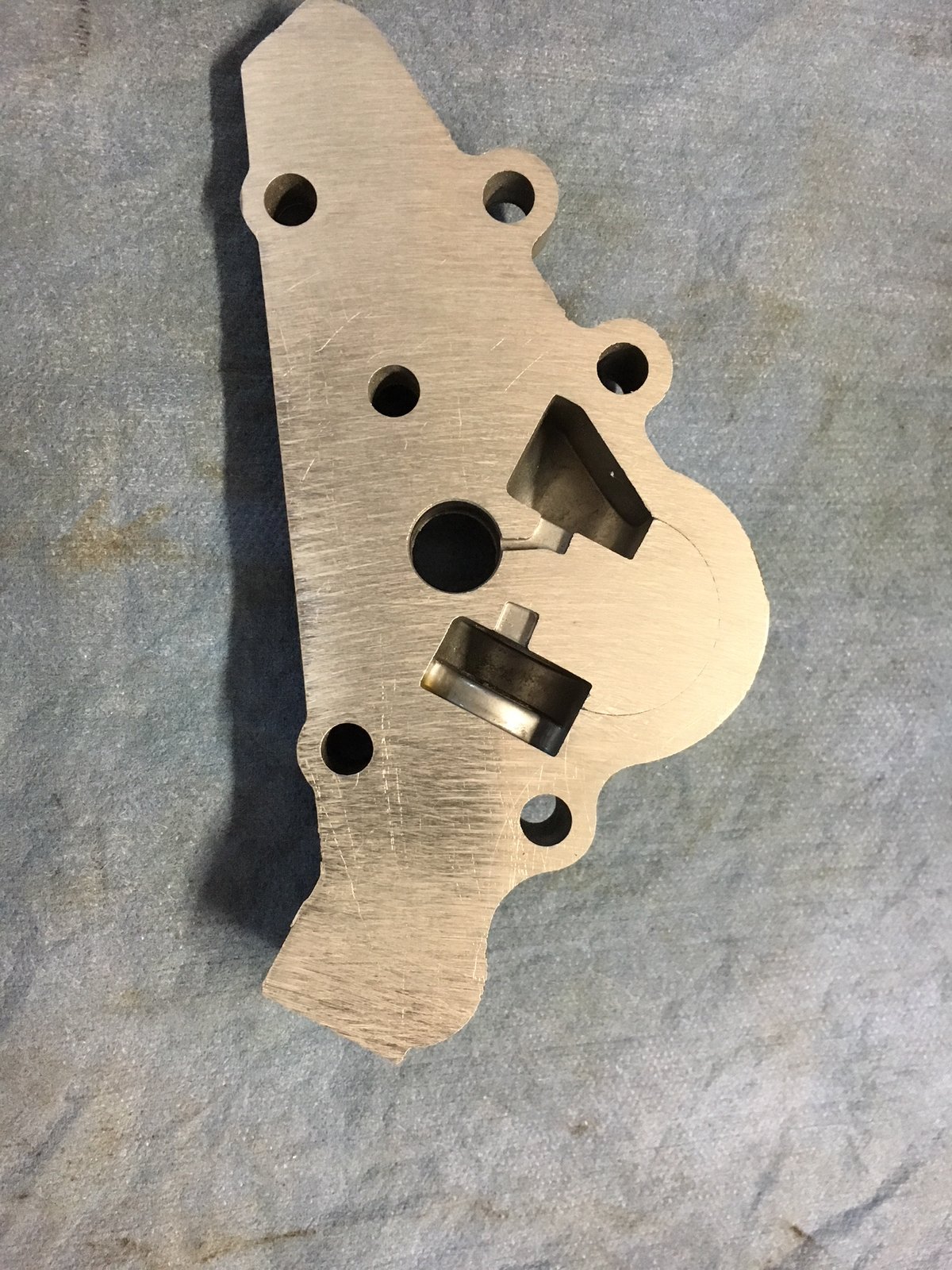

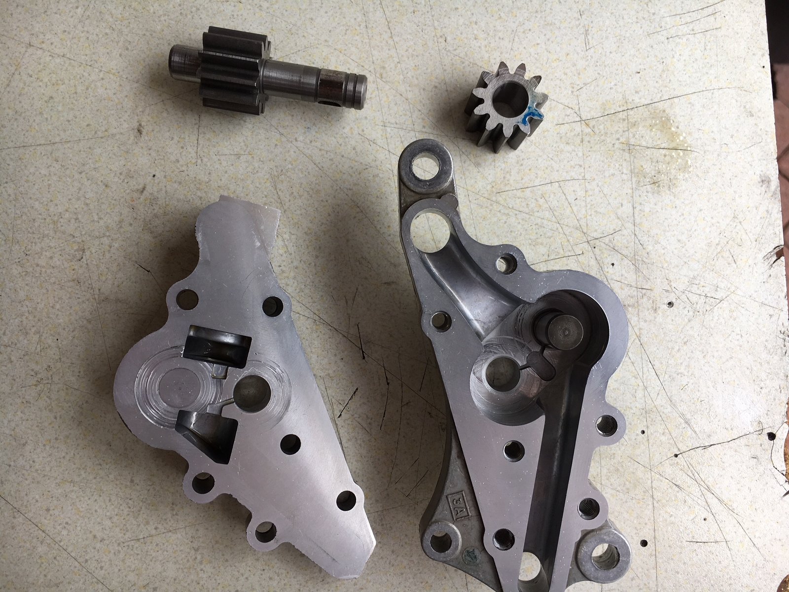

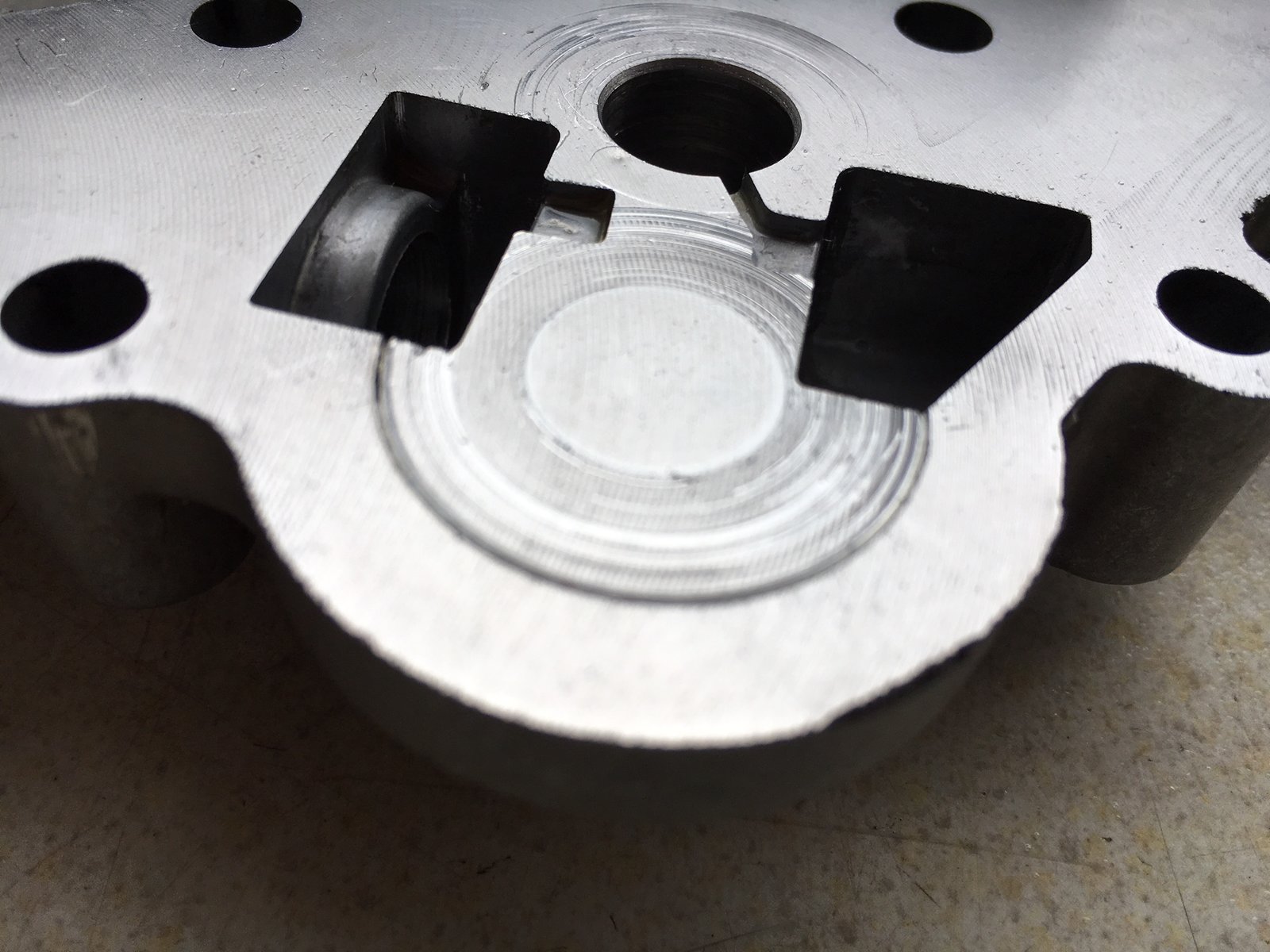

    While waiting for the shims, I had opened the oil pump to check the clearances, not a pretty sight, but all in spec according to the workshop manual, deffo been some debris throught there.
    Once again, Park Engineering at Malton soon fixed that, just need to polish it some more with grinding paste on glass.

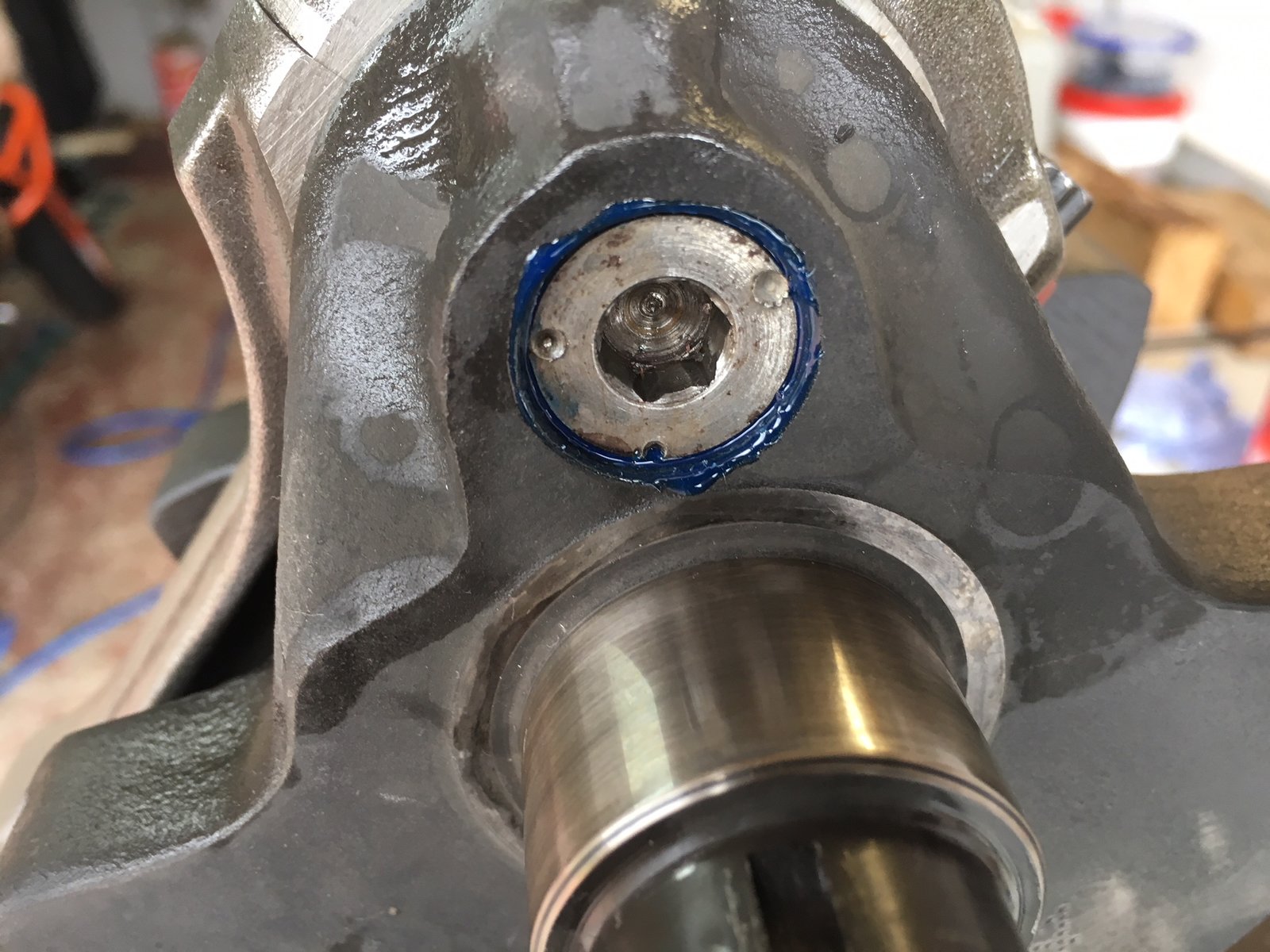

    I also pulled the gallery plugs on the crank to make sure no debris inside, was as clean as a pin, flushed out, and followed with compressed air, then reinstalled the plugs with loktight.
    Now still waiting for the BE shells....
