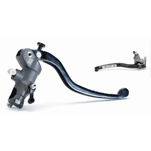

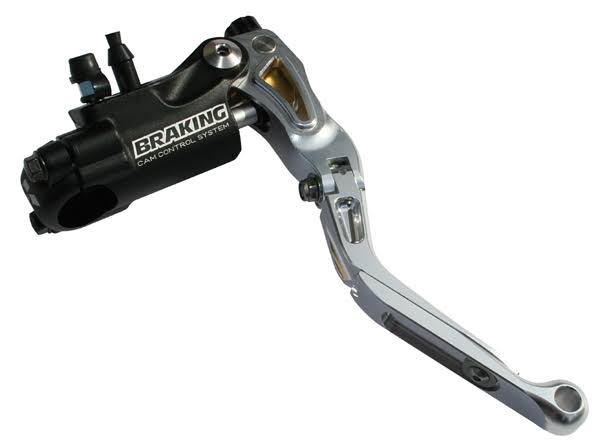

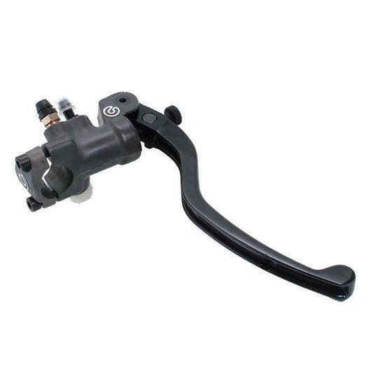

  1. Hi guys, I really want to uograde the master cylinder speed on my 899. I’m kind of anal, so I’ll be upgrading both, the brake and clutch, at the same time. I know brembo is supposed to be the holy grail of brakes, but what about the other brands I mentioned above? I’m sure I could get both the brake and clutch masters from Braking for almost the same as a brembo brake master. The Accossato units seem to be somewhere in between the two.
    Has anyone here used either braking or accossato master cylinders?

  3. No experience of the Braking stuff, but I've used Brembo for years and still do. I found the Accossato stuff ok, but there was a fair bit of mechanical clearance/play in the lever/pushrod assembly and this took away a fair amount of feel from the lever, for me anyhow. The RCS Brembo stuff takes some beating in my eyes.
    On the 899, bear in mind the switchgear can cause clearance issues with the aftermarket master cylinders. Clutch is ok, but the brake is tight. I ended up ditching the stock switchgear and went for a smaller pushbutton type from GPT in Italy. Works a treat.
  4. Can you explain a little more about why you feel the master cylinders you have need to be better ? Certainly the current generation of Brembo offerings give you a wide choice of lever pivot to piston lengths and piston diameters which will change how the lever feels. A longer lever pivot to piston measurement will give you a harder feel and less movement to apply the braking. Andy
