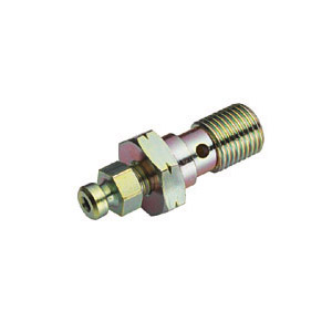

  4. Just a thought: Are the pipes into the ABS unit a banjo fitting? You can get banjo bolts with a bleed nipple built in.
