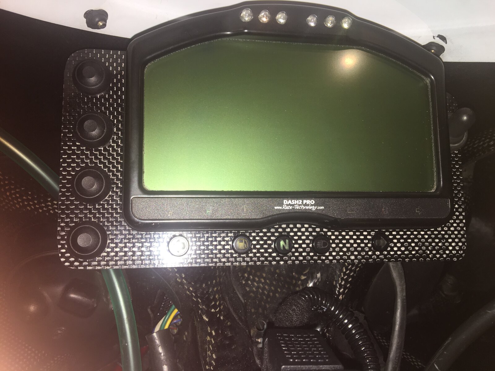

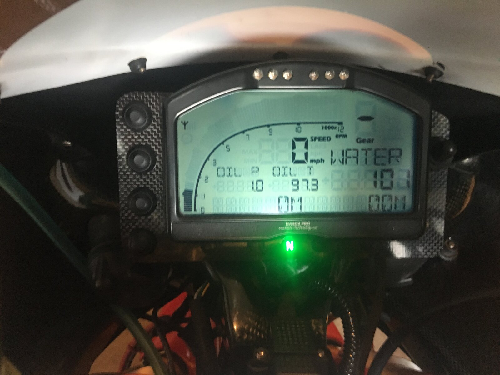

Same one I had at Donny, Paul. Just refined it a bit, got a few more bits working. The second photo shows the water temp at 101. I was just checking it this morning to make sure the first fan kicked in when it should. The gear indicator works from the gear box ratios Vs engine speed and it’s very accurate.
Thanks, I never saw that at Donny. I bet that was a bugger to wire in? Is there a thread on here about it? Edit: Just been looking into it. Would still like to know how you did it. TIA
Not sure mate. I had loads of help from both @Old Jock and @Dukedesmo. Not that hard to wire in, the tricky part is getting the sensors set up to give the right readings.

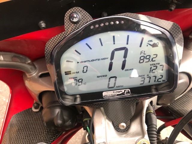

There is no plug n' play gear indicator for 916 models as they have a mechanical speedo and no way of actually detecting which gear it is in. Gear indicators require input for RPM (from ignition coil) and speed to make the calculation so you need some kind of electronic signal related to speed. I've got a Translogic dash on mine which does this but it uses a sensor on the rear sprocket bolts for the speedo and you would need something similar - not sure if there is something you can fit 'inline' with the speedo cable to give a signal? otherwise you'll need to devise a speed sensor from somewhere.

Don't know about the first one? but the Healtech linked to should be OK if you get the WSS (Wheel Speed Sensor) version but you'll need to work out a place to fit the sensor. On my 916, for the Translogic speedo (with GPI) I fitted it to the rear disc mounting bolts.
