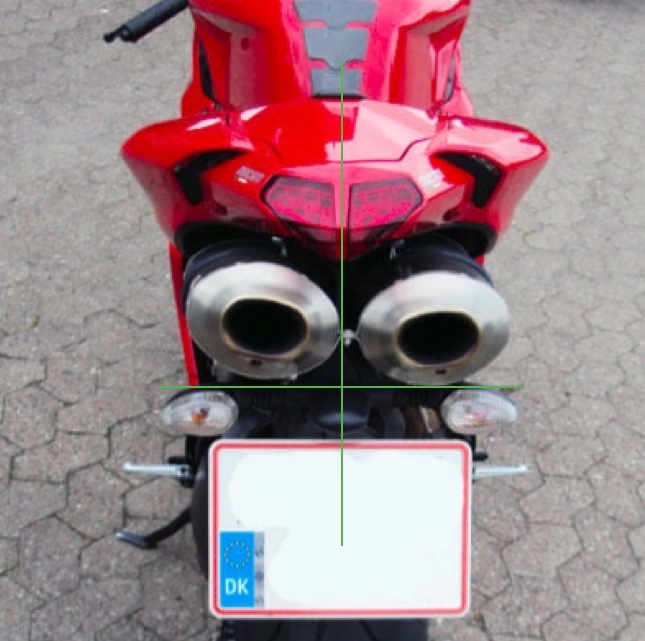

  1. Any suggestions on how to adjust fitment of exhaust mufflers? As you can see on the picture the mufflers are a bit out of center. So is it possible to adjust this, or should I just live the flaw?
  2. Its an art. You need to have all fixings loose. I used to work from the hangers downwards. The hangers are the most pain in the arse bit. Gentle persuation with a rubber mallet helps. Plus you may have the hanging straps on the wrong can. Swap them over and see how that goes. (Theyre maeant to be the 'same' but I always found mine were can centric)
