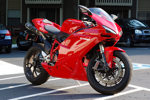

    The 1098 that was released by Ducati in 2007 and replaced the 999 model has been highly acclaimed as solid and fashionable bike; indeed it won several awards including Best Sportsbike and Best Design from the Motorcycle Design Association as well as Bike of the year in 2007 by 3 separate magazines. Performance wise it has come in for acclaim and criticism alike; with, in a strictly driving sense it has been widely praise for its performance, it did kick start the controversy with the WSBK and the issue over concessions relating to the number of cylinders each bike had.
    However, for purely personal use, the 1098 was and is highly popular. In saying that, many have commented on a particular design flaw of the bike - the high beam. Many have commented on the fact that, rather than simply lighting up the road, the beam on the 1098 instead is more aimed at the tree tops and road signs as opposed to the road itself. There is a cutoff plate in the projection headlight housing that is there to stop the beam from shining directly at oncoming traffic however the fact that the angle of the beam is set upwards instead of on the actual road is a pretty big design flaw. Not to worry however, we are going to give you a very short and simple guide on how this can be modified by removing the high beam blocker.
