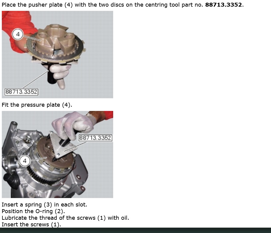

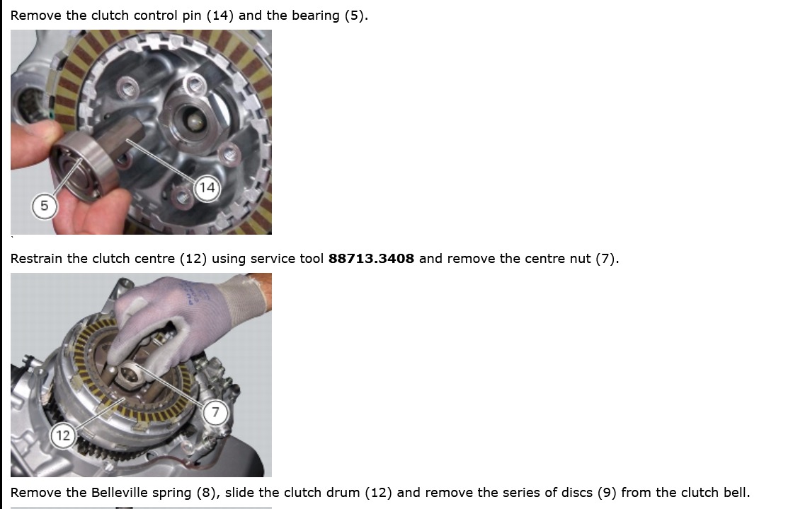

  6. It also looks like if I want to just look at the plates and in case then replace them i will need to buy 2 specialist tools to deassemble and reassemble them
    service tool 88713.3408
    centring tool part no. 88713.3352
    typical ducati.

  11. this is what I'm talking about. Just to be clear this is a wet clutch.
