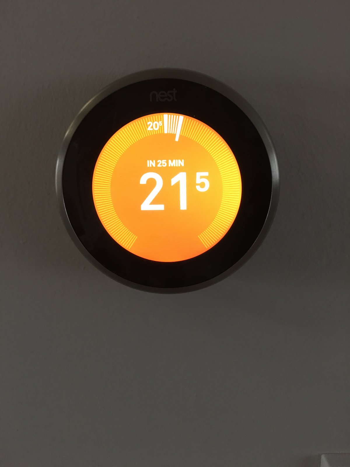

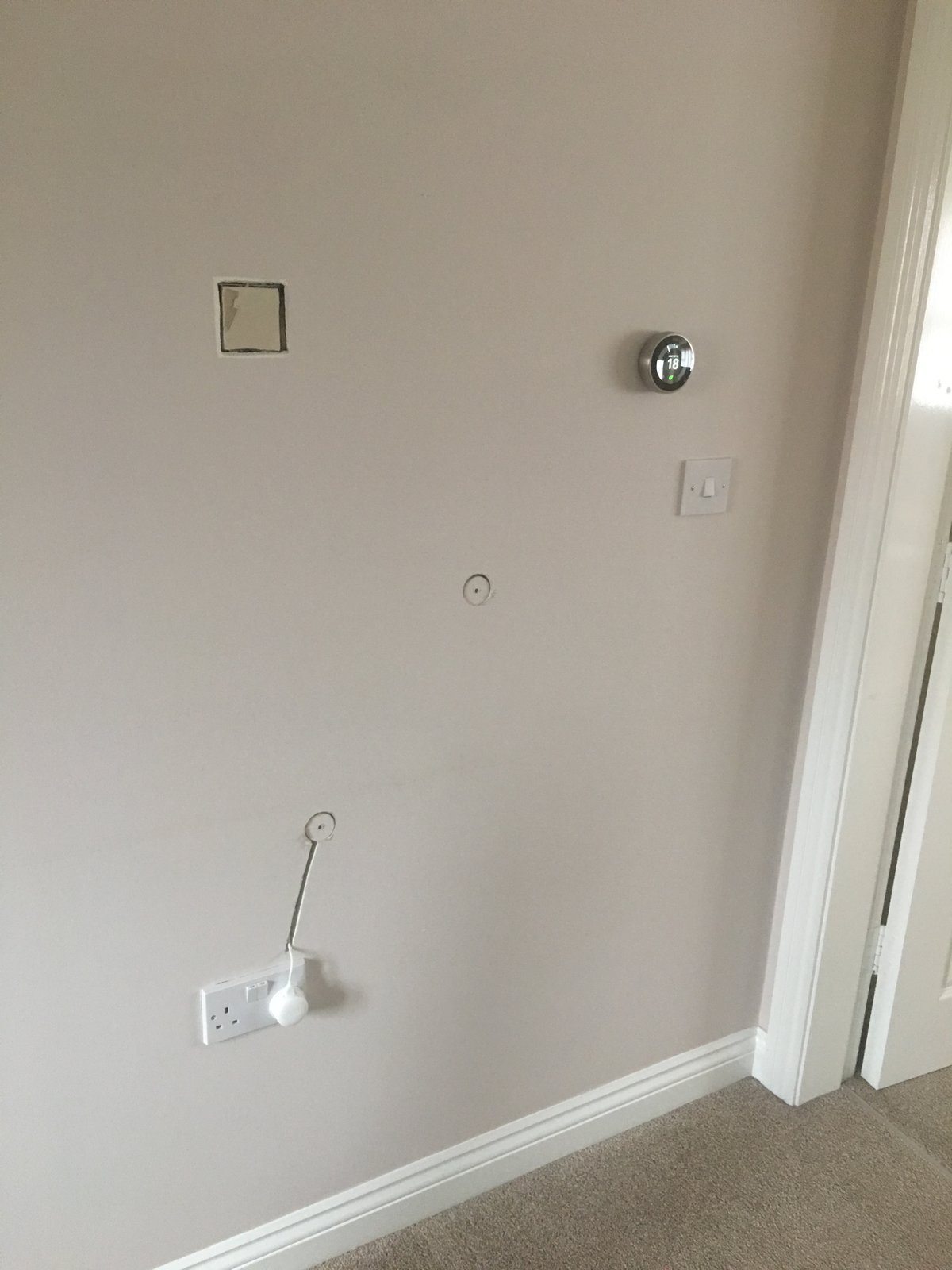

  7. I've a NEST.
    I can't say I've used it for the level of functionality you are looking for, but I can operate it remotely, it learns the patterns you tend to be in and out of the house and sets timers to suit. It also self updates wirelessly through my home network and looks nice enough. That's it really.
    Oh, it took about an hour to fit the remote unit to control the boiler, 4 wires iirc. The thermostat itself would have taken 5 mins, but I hate visible wires and fished the power cord behind the wall for neatness, a bit of plastering and painting required afterwards.
  8. Ummmm.... according to IEE regulations all hidden cables must be vertical.....
    I suppose it's only 5.2Vdc..... the guy who bangs the next nail in the wall is going to hate you.

  12. [​IMG]
    What Rob doesn't show you is the opposite wall he tried to mount it on first
  13. I wish Noobs. o_O
