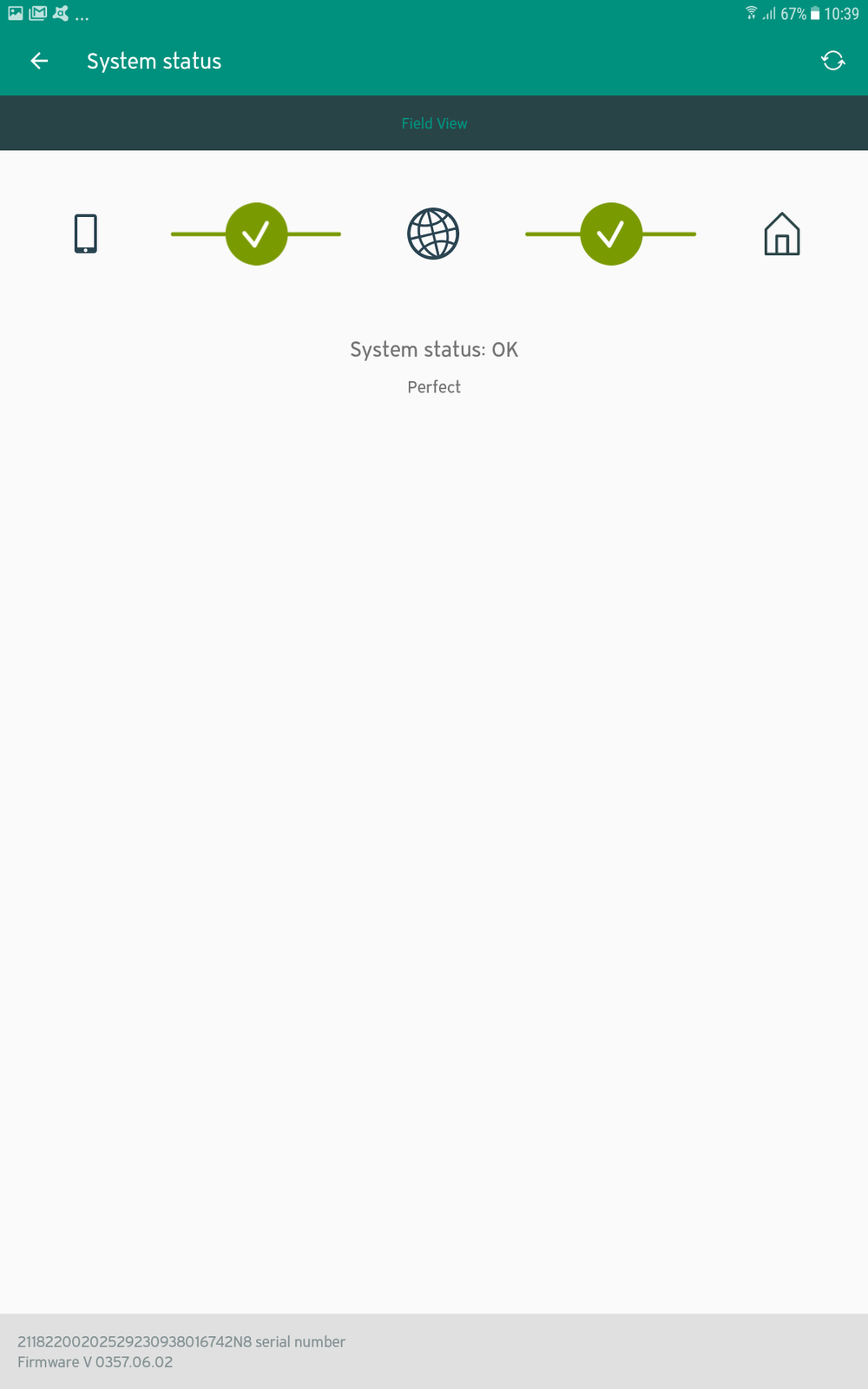

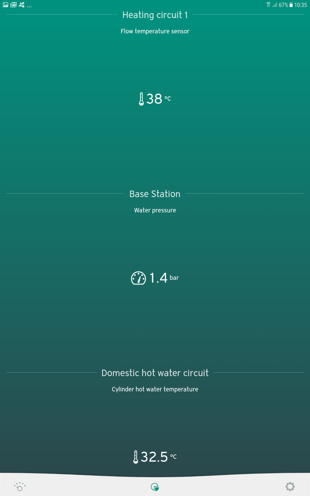

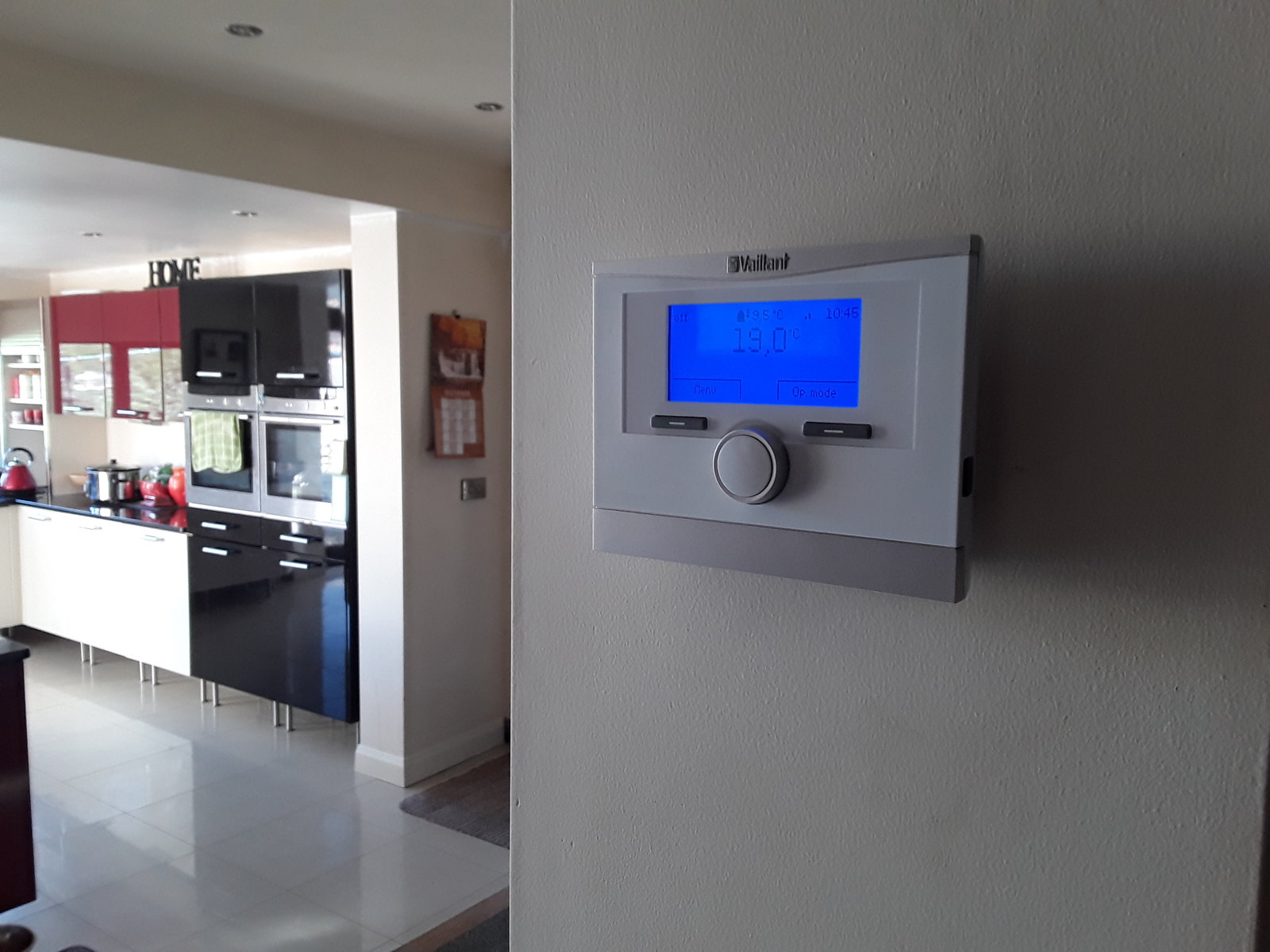

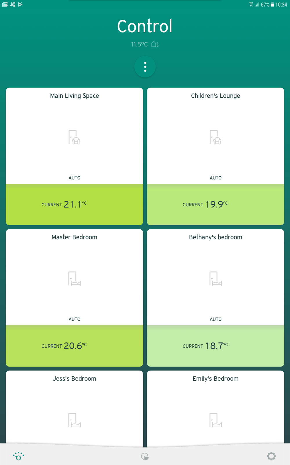

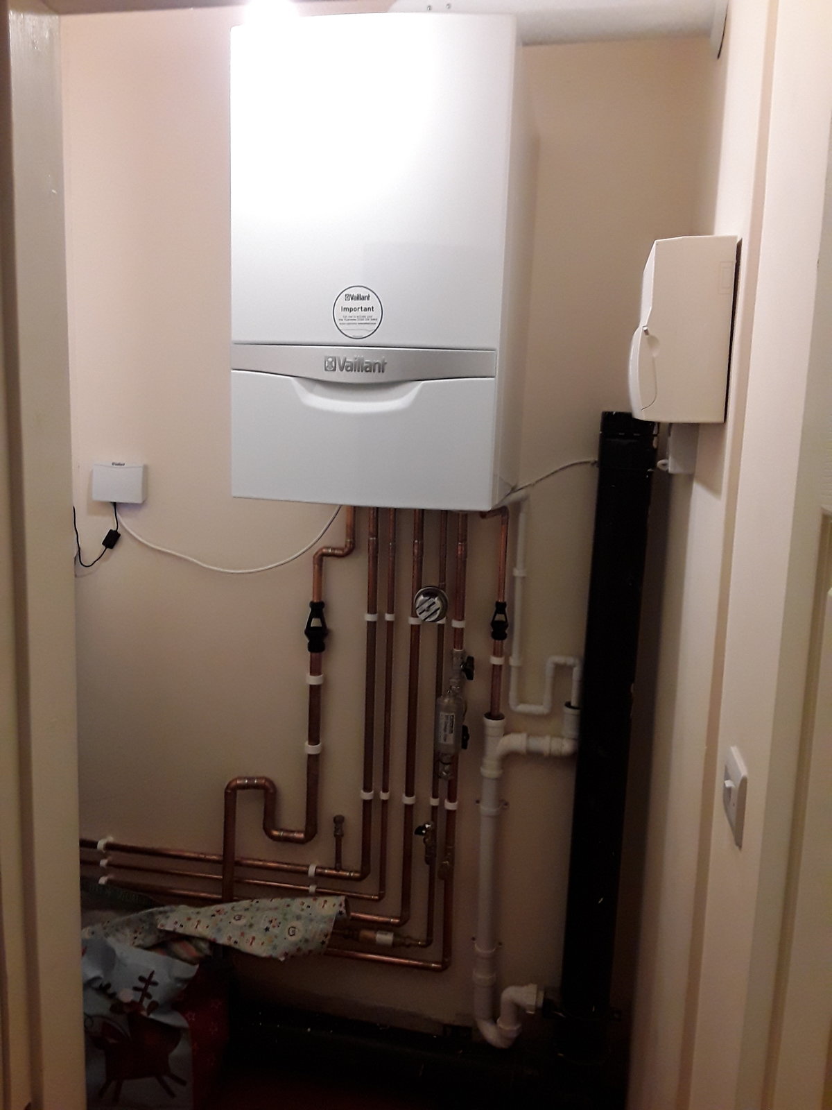

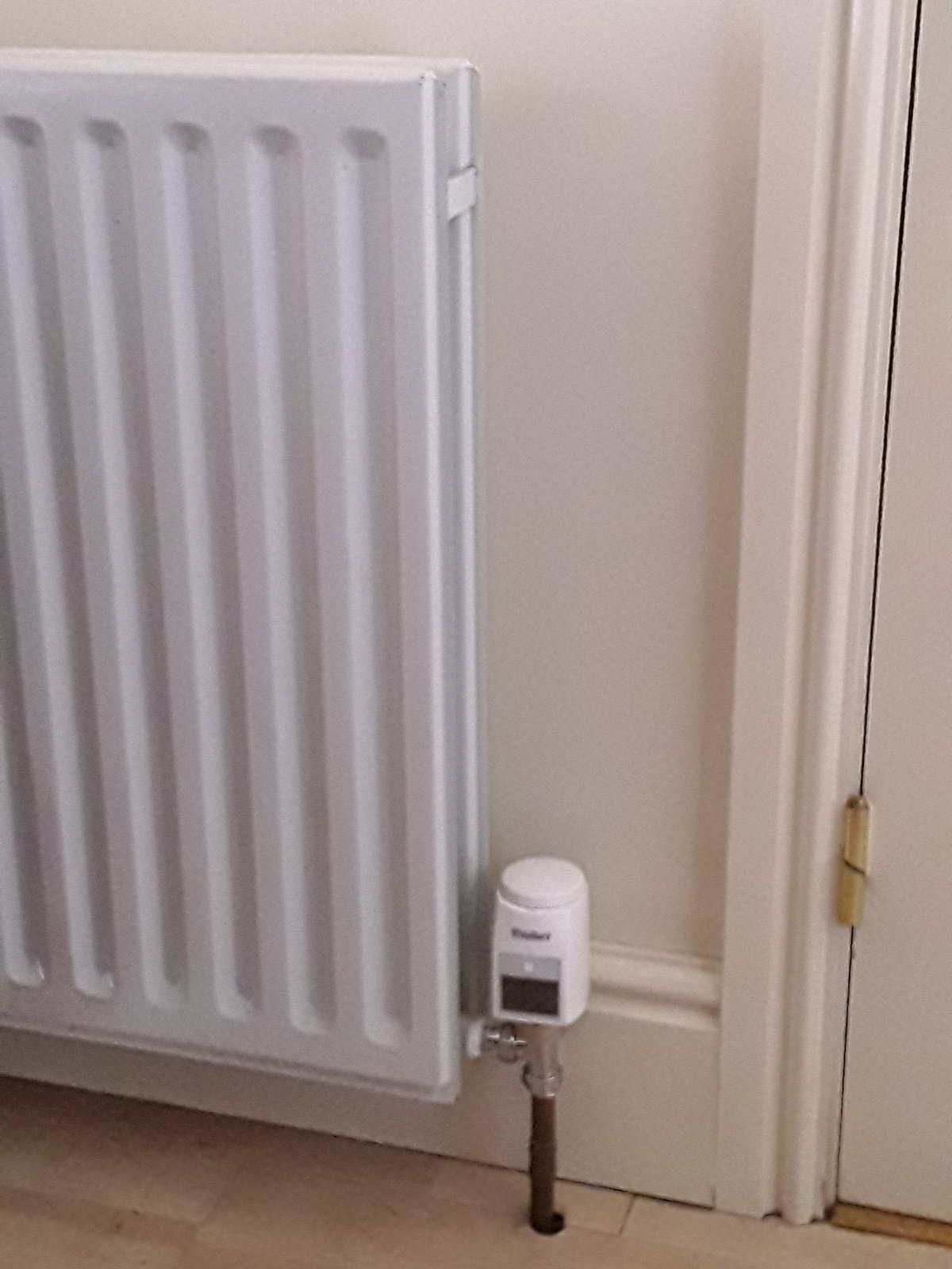

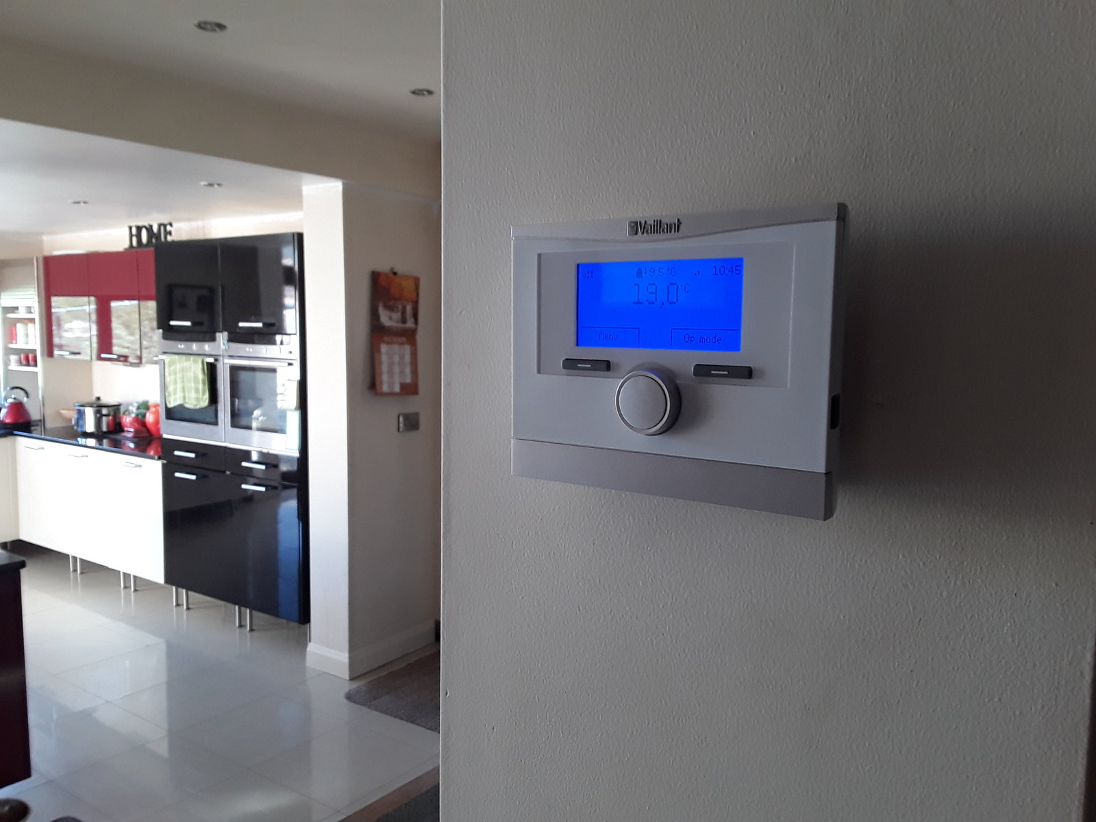

  9. Thought it was about time I updated this thread for those interested in our final decision on smart controls and the experience so far...
    In the end we decided to go down the Vaillant ambiSense route. Taking in to account our requirements and objectives, the Vaillant system enabled us to split the house in to multiple zones and also install weather compensation. An added benefit being that the boiler is Vaillant so installation and integration was seamless and trouble free.
    The post boiler installation works and commissioning was complete last time I was away at work. The controls fitted in order to meet the regs were intentionally basic as we knew we were going to remove & upgrade them ourselves shortly afterwards and the could also be sold on afterwards :upyeah:
    Mrs M mentioned a couple of times in the first couple of weeks that certain rooms were getting too warm at night and the main living space seemed to fluctuate quite a bit.
    Having ordered all the kit whilst away at work, it was sat awaiting my return last week. Installation and setup was an absolute doddle too! The VRC700 weather compensator system was literally installed within 30 minutes and setup after a further 15 minutes... The ambiSense kit was also very simple to install but took a little longer due to us having 8 TRV's to fit and setup. Once the internet gateway was installed and connected to both the boiler and WiFi, the rest was plain sailing...
    So we now have:
    - New Valillant ecoTec store 938 boiler (relocated to middle floor storage cupboard)
    - Vaillant VRC700 weather compensation
    - 6 Independently controlled heating zones (via 8 ambiSense TRV's)
    Following installation and setting the system up there was a notable difference in the radiator temps and comfort levels in each of the 'heating zones... The supply and return temps to the heating circuit have dropped considerably and it seems the boiler is happily running in its most efficient 'condensing' mode. We have the heating curve set to adaptive and it would seem the system is learning with each passing day. The time the system fires up to achieve the desired temperature by the programmed times seems to have gradually reduced which would suggest the system is still learning and adapting to the characteristics of the house, another positive sign the system is working well though.
    The reviews for the App were a little concerning to say the least when we first looked through them. So far though, everything has worked perfectly for us, changes to the indevidual zones are instantly cascaded to the system, the TRV's can also be locked out via the App which means the kids can't meddle with them and all zones have been both stable and comfortable since we started using this system.
    All in all, we're very happy with the decision we took following taking on board the thoughts and advice on this thread and after the initial experience & observations of the system, we're also hopeful that we'll benefit from reduced energy bills going forward too :)
    Lastly and most importantly for me... Mrs M and the ankle biters haven't moaned once about any room not being warm enough, being too warm, the showers not delivering enough warm water, baths taking too long to run or the radiators not being hot enough (anything below ouch ya b*a state hot was aparrenltly unacceptable previously)
    So, all in all - I am absolutely delighted with it and looking forward to a pieceful winter :)
    P.S Before anyone pulls me up on the wiring :joy:... There are still the finishing touches to do in the boiler cupboard once I have sourced the appropriate sized cable clips :bucktooth:
    #49 Ben Mallinson, Oct 21, 2018
  10. You could do with a bit of this.....
  11. That's one more thing I was considering strangely enough :thinkingface:
    Is it worth insulating them even though they are in a cosy cupboard in virtually the centre of the house?

  15. I'd insulate the hot water pipes as a minium.... You've hot water all the time, say +55°C.... so you are going to have losses all year, 24 hours a day.
    Why heat a cupboard? Grow lamps, CO2 generators... activated carbon extraction.... a drying room?
  16. As said, I was contemplating insulating them just wasn't sure it would be worth it... In the grand scheme of things though, the additional cost for piece of mind is a no brainer... Confirmed by your response ;)
    Thanks for your input once again @AirCon :upyeah:
