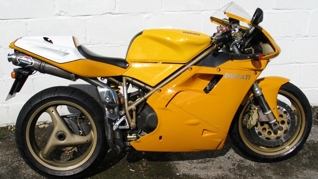

  10. I feel for your disappointment, I know I was fortunate to be in a position having found my bike to be able to do all the verification before I was able to see it in the flesh although I was prepared to walk if it didn't stack up. Andy
