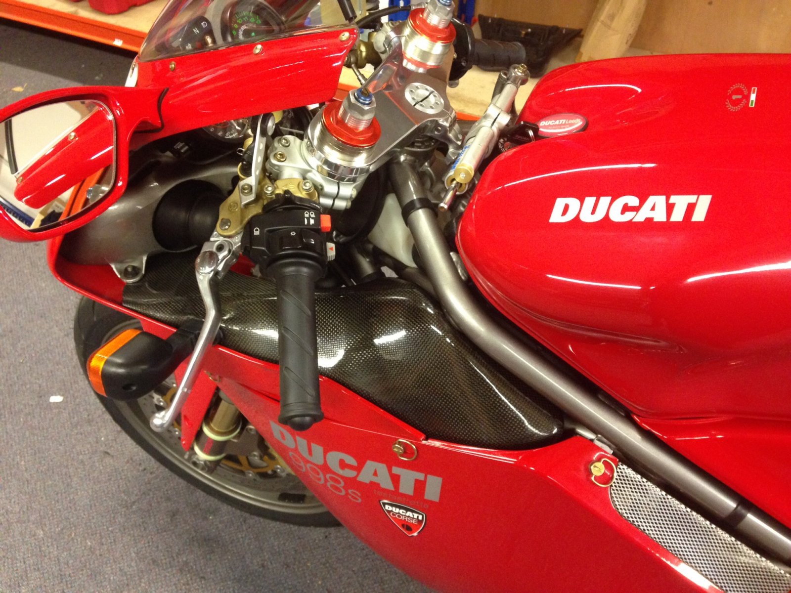

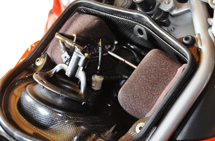

  2. Air filters fitted today. Wasn't as bad as I thought. Took @antonye 's advice and fitted them with the original air runners open.
  3. Nice ... just wait until you take them out to clean/re-oil and then wonder how the hell you got them in last time... :lol:

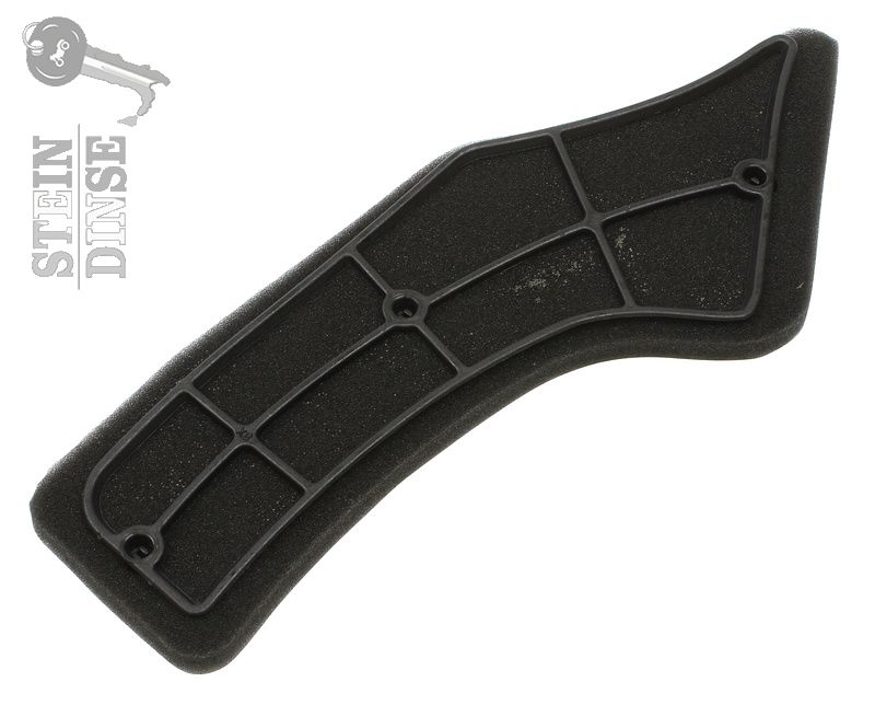

  13. I went down the BMC airbox panel route after my sock filter collapsed when I tried to remove it to clean, so I think I dodged a bullet there...
    BMC were a little expensive but simple to fit.
    on the dyno I had my 996 set up without filters ( because of above) and when I re tested it with the filters fitted there was only a 1.2 ps difference.
    ill get it remapped this year to match the added filters though to make sure all is well.
    I do like the look of the MWR set up as I would expect the increase surface area would assist in the longevity of maximum filtration vs blockage.
