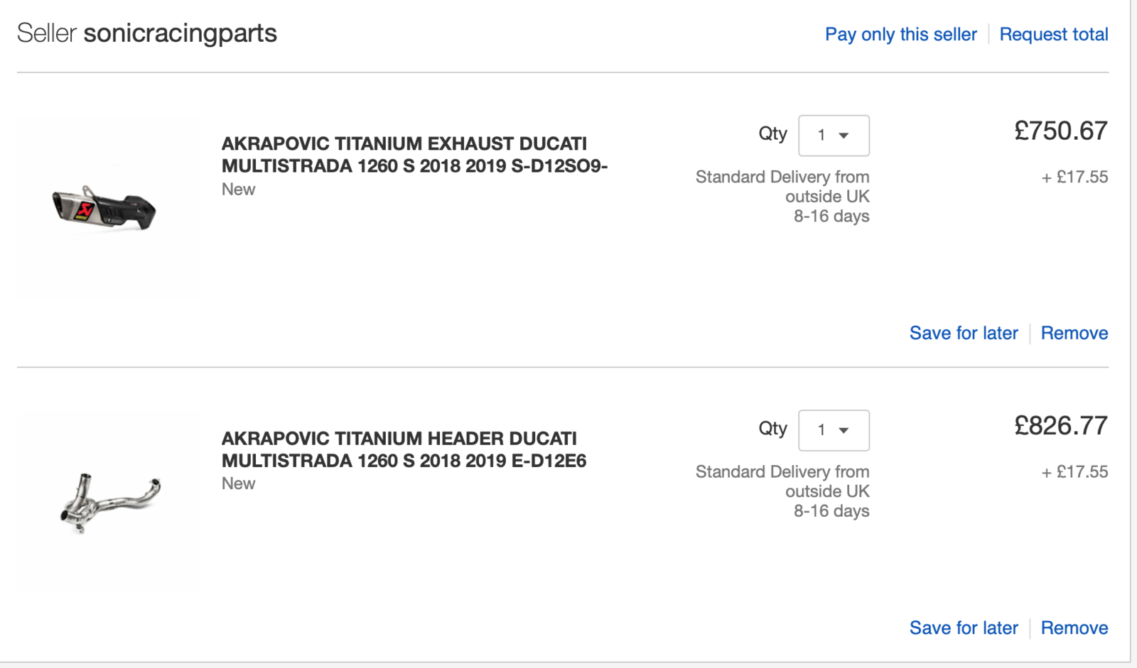

  4. Came with the DB killer as well, he will do a deal for both items. Screenshot 2019-08-18 at 14.04.52.png

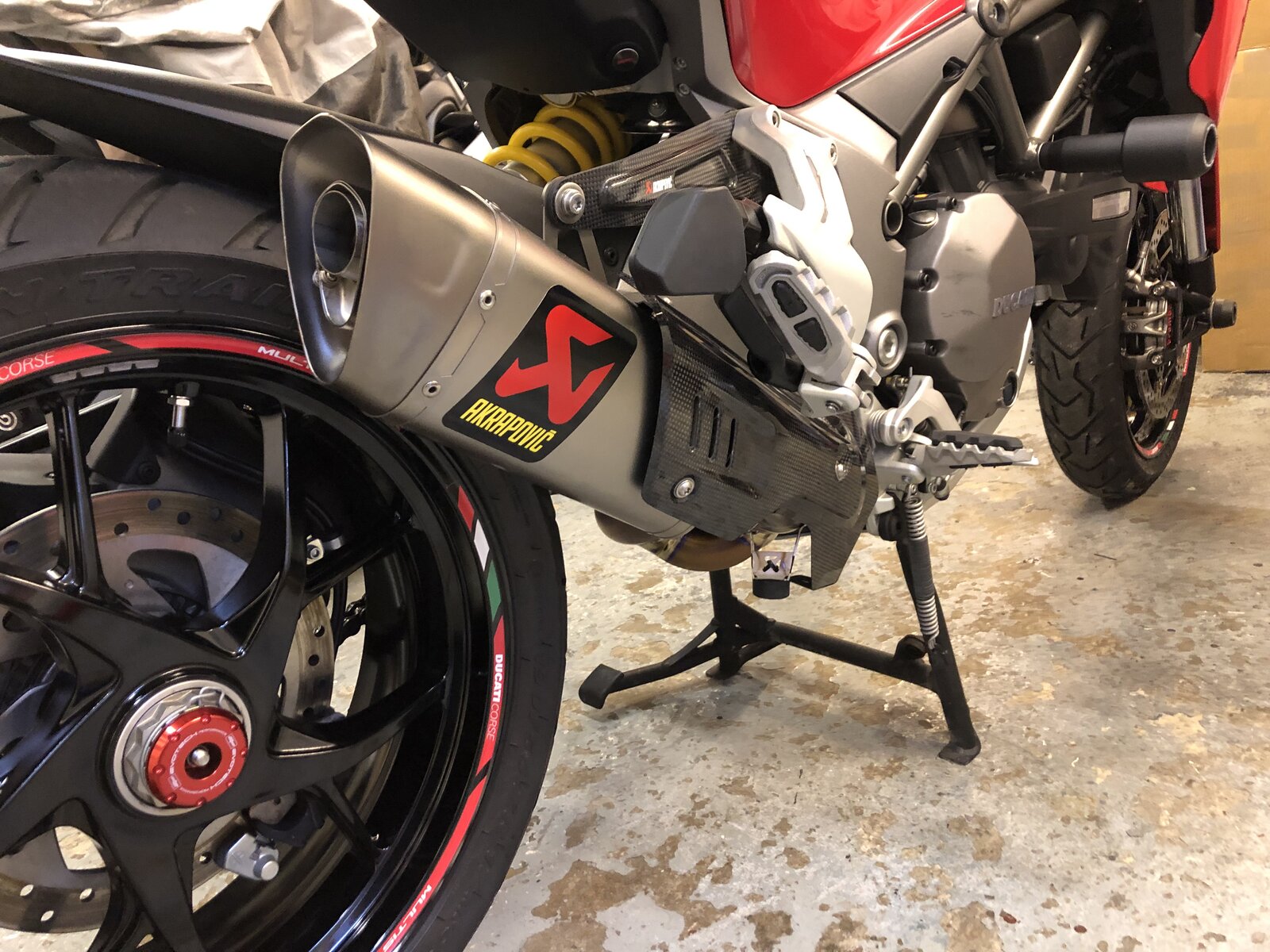

  8. Question regarding the mounting bracket and panniers shown in this picture.
    A mate has just fitted a silencer to his 1260, and the thickness of the bracket the same as this pushes the rh pillion footrest bracket out such that his pannier is now a 'right b@stard' to get on. The rubber block no longer goes in square and needs a bit of force.
    Does anyone else find this, and how have you dealt with it ?
    Cheers,
    John.
  9. Hi John, you are 100% correct.
    I found this out while trying to mount the pannier for a European Tour, I am looking at getting made up some wedge type washers to angle the footrest bracket, putting the rubber block back into the original position or near abouts, or getting a spare rubber block and reshaping to allow easier mounting of the pannier, it not a problem at the moment as no more touring planned for this year

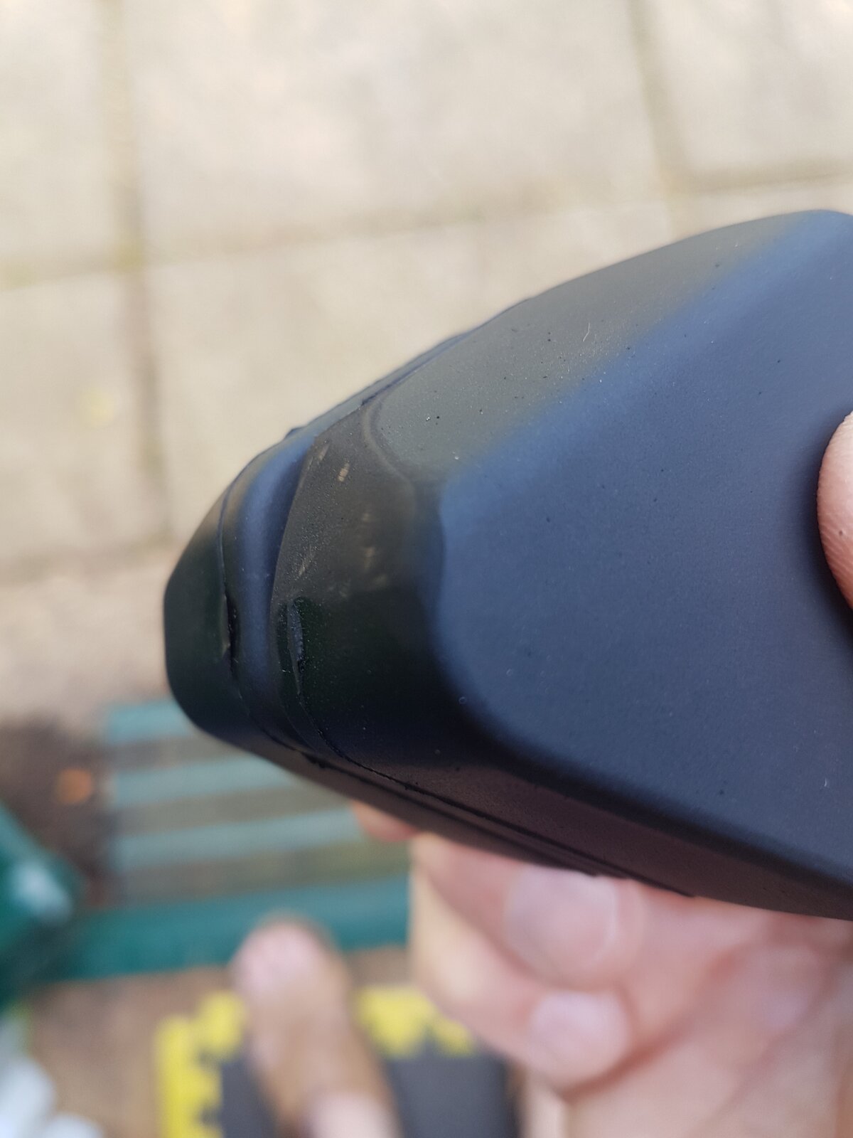

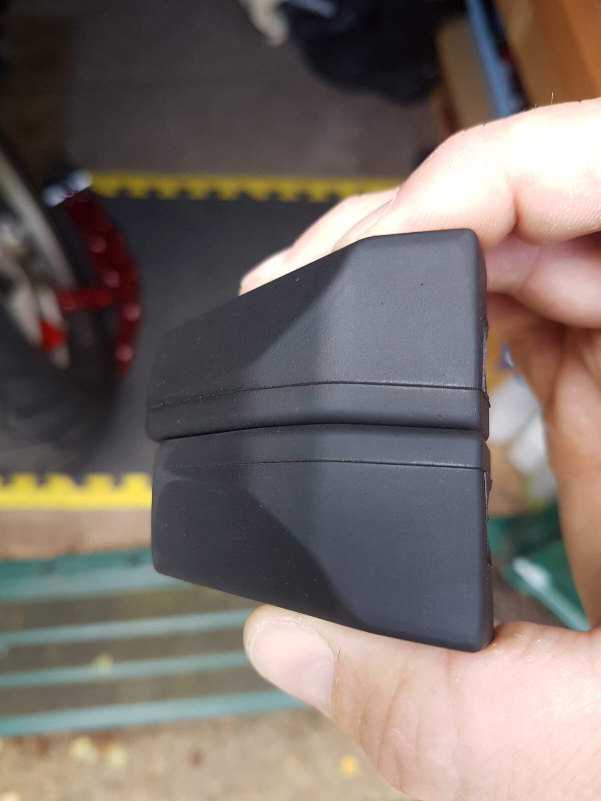

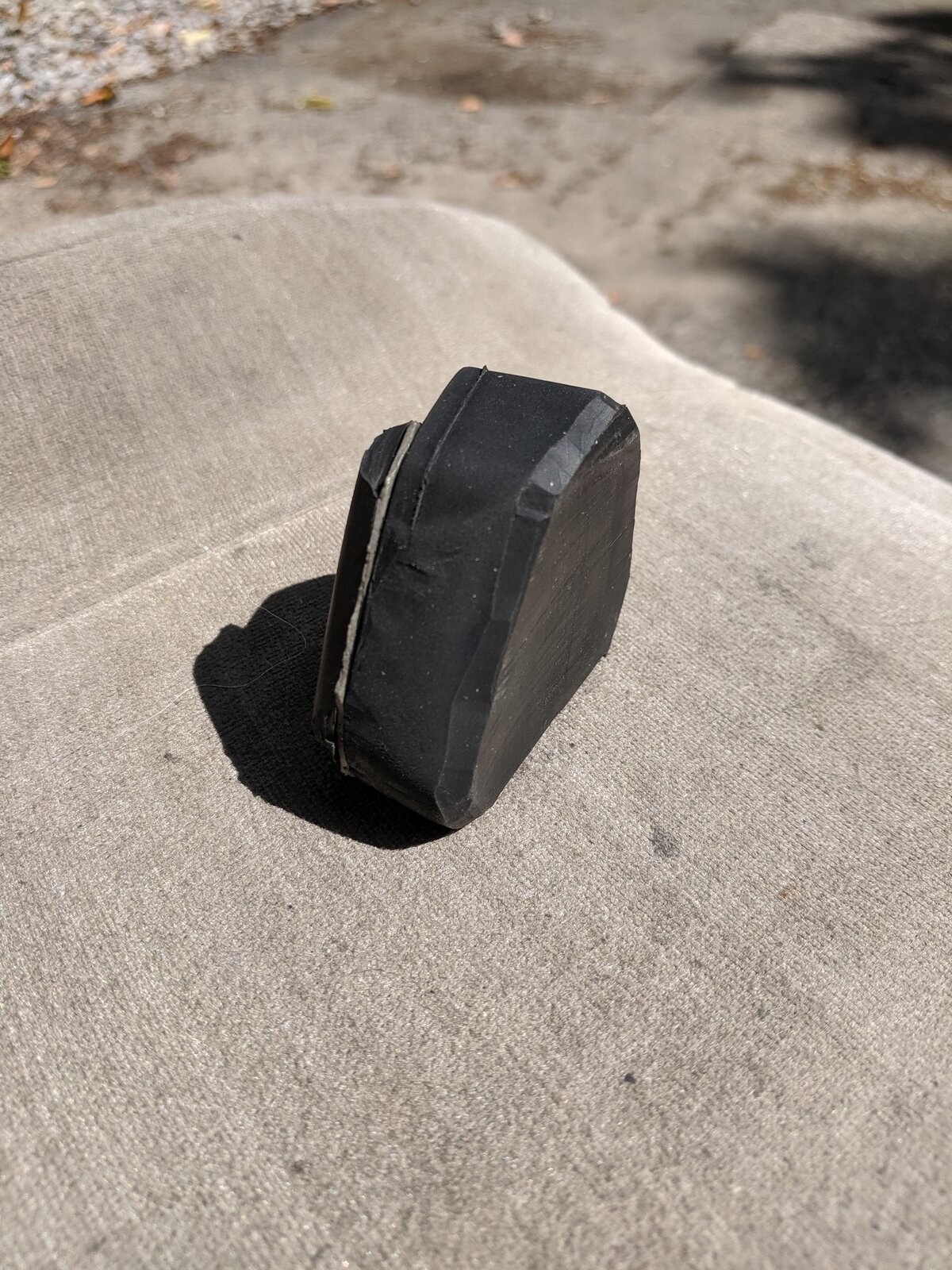

  13. Cut some rubber from outside and stick it to inside using a high quality double side 3M tape. 10 minutes and problem solved! Did few thousand miles this year without any issues.

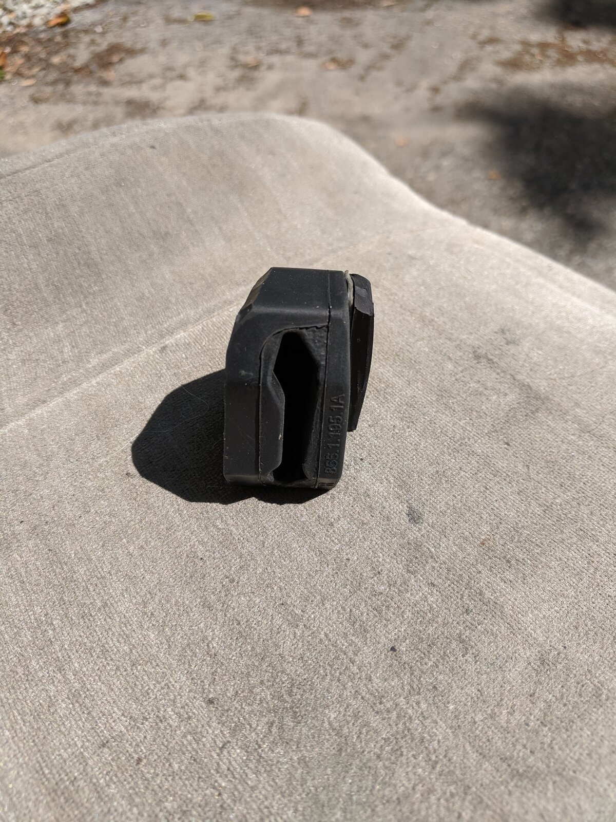

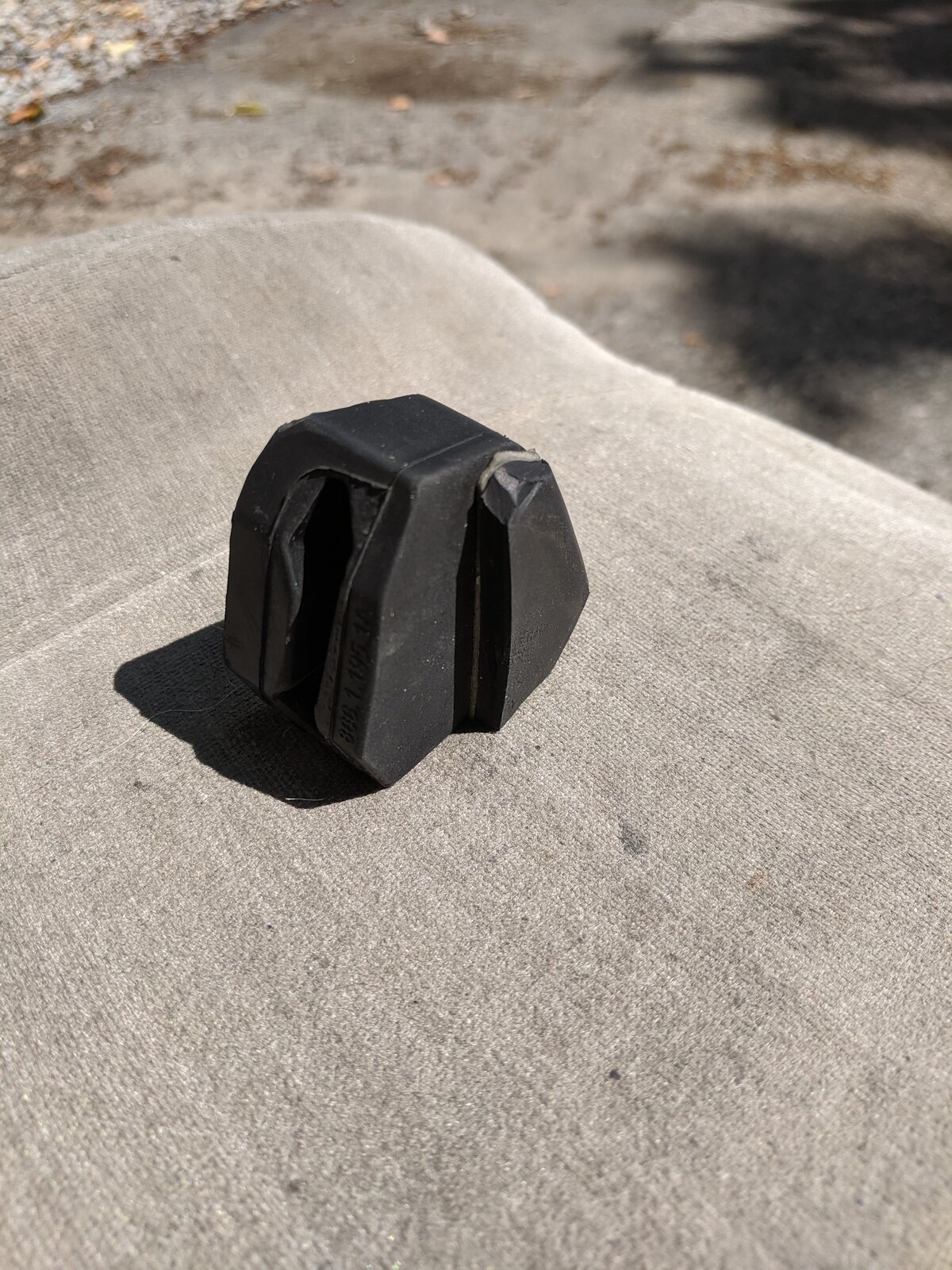

  15. Hi John,
    I had the same issue so I just shaved a bit if rubber from the stop block on that side, about 2mm and it is a lot easier to fit the pannier now. Post some pics 20190824_111805.jpg 20190824_111805.jpg 20190824_111518.jpg
