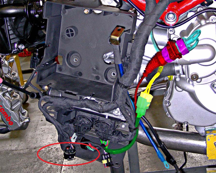

  1. I was just gonna ask you where you were trying to connect to.....
    No it's in the left hand side panel near the Ecu, tucked down the left of the battery.
    It's quite well hidden.
    The one under the seat is for the DDA.
  2. The one under the seat is for the USB data capture device. As Anth says, the diagnostic port is here 1098 diagnostic.jpg . It has a plastic cap over it.
    The leads listed above, the Ducatidiag and a licence for the software are what you need to reset the TPS yourself.
