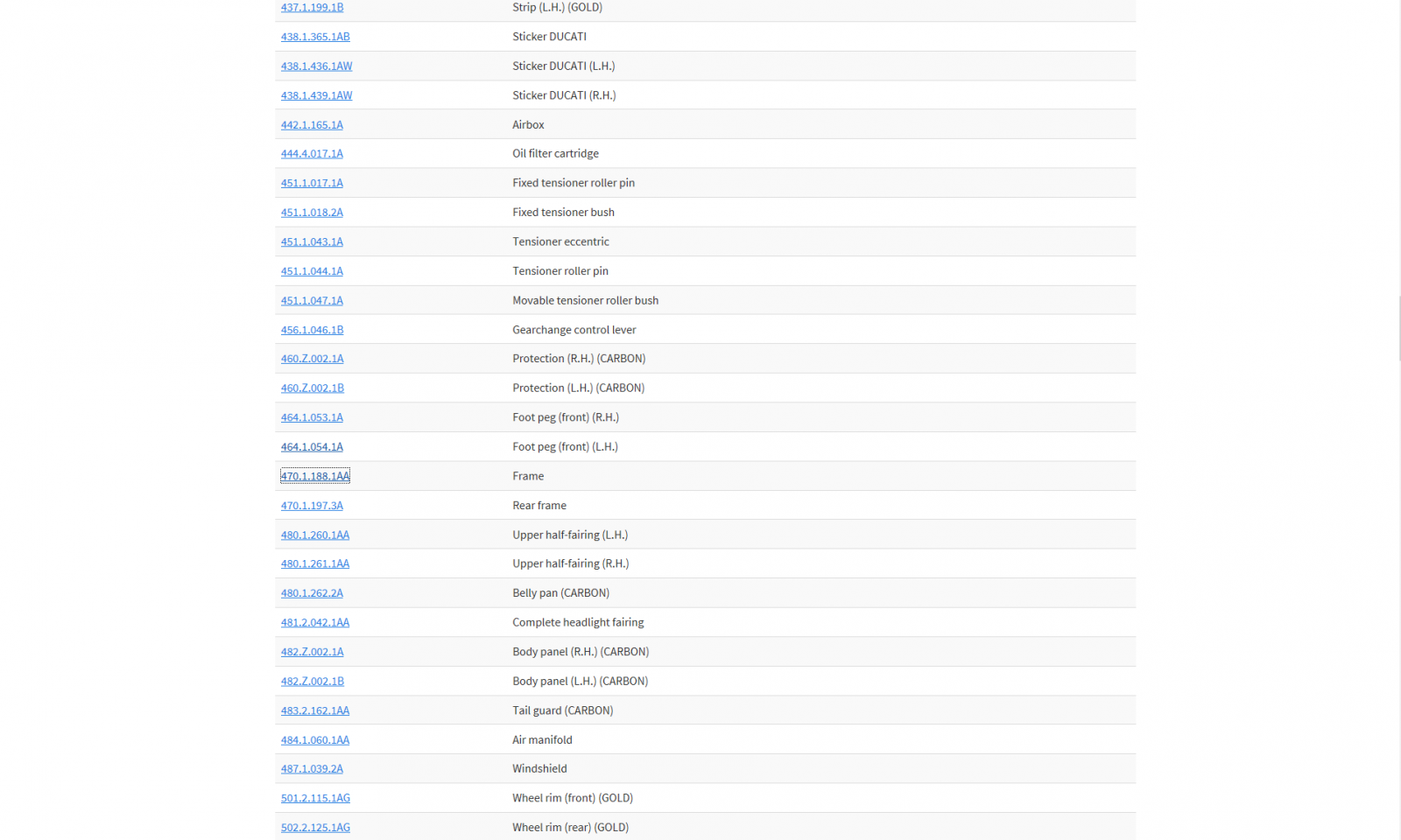

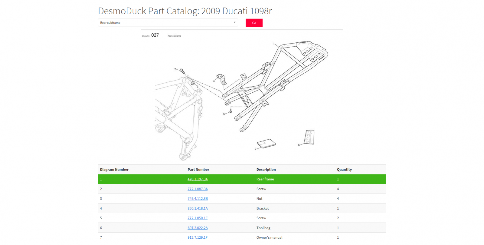

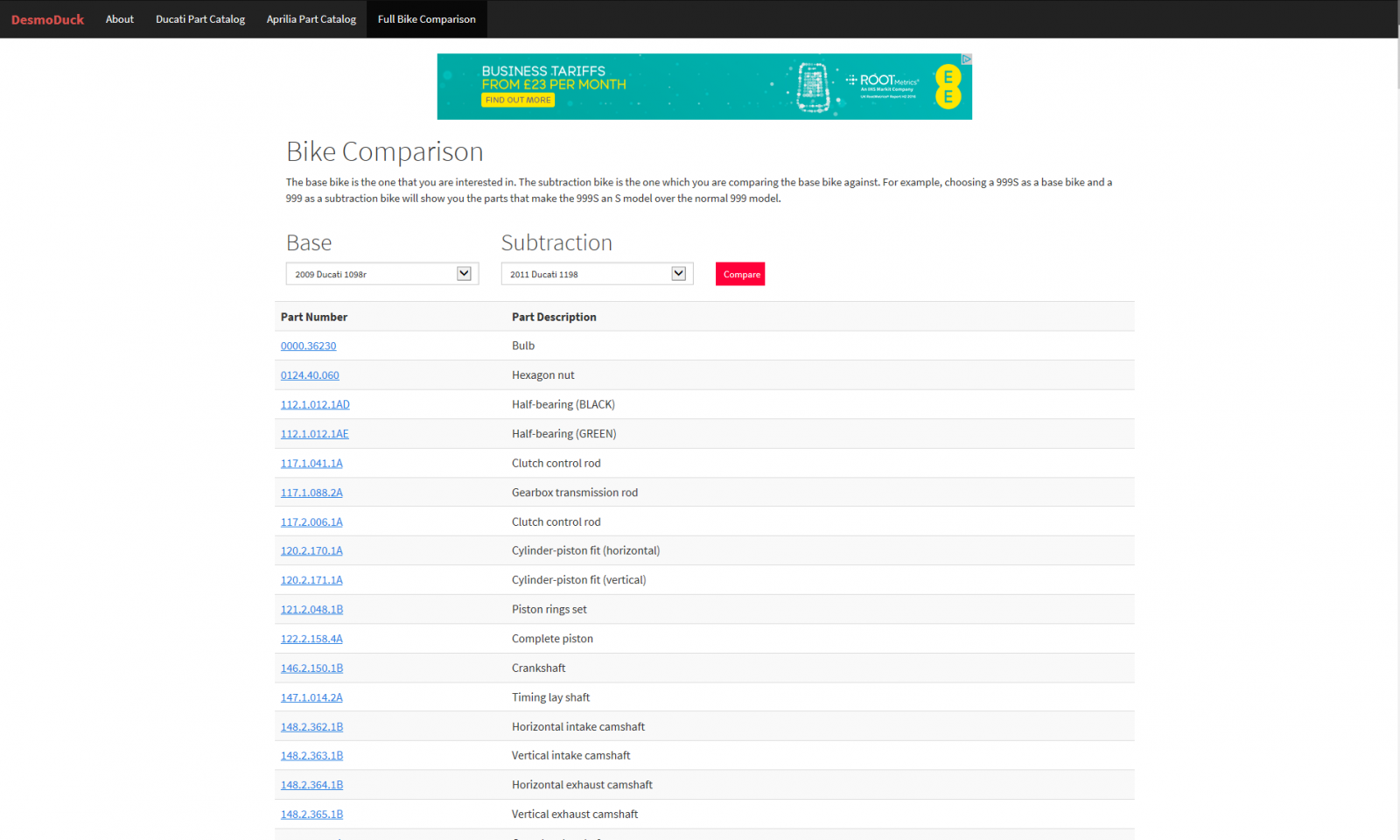

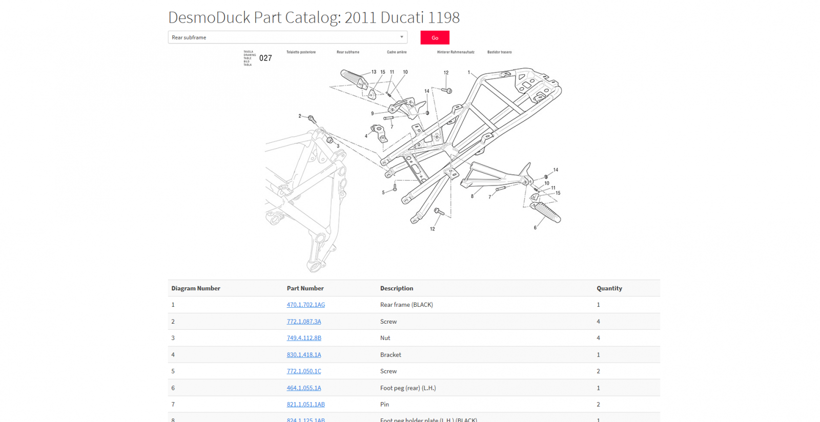

  6. By using the comparison tool on the desmoduck website here: http://www.desmoduck.com
    Comparing the 2011 1198 to the 2009 1098R it suggests that they do use different frames. See below...
    And by doing a quick Google on the part number below, it would appear the 1098R is indeed an aluminium rear frame...
    Which may well have just answered your question and provided you with the information required @cookster
    HTH
