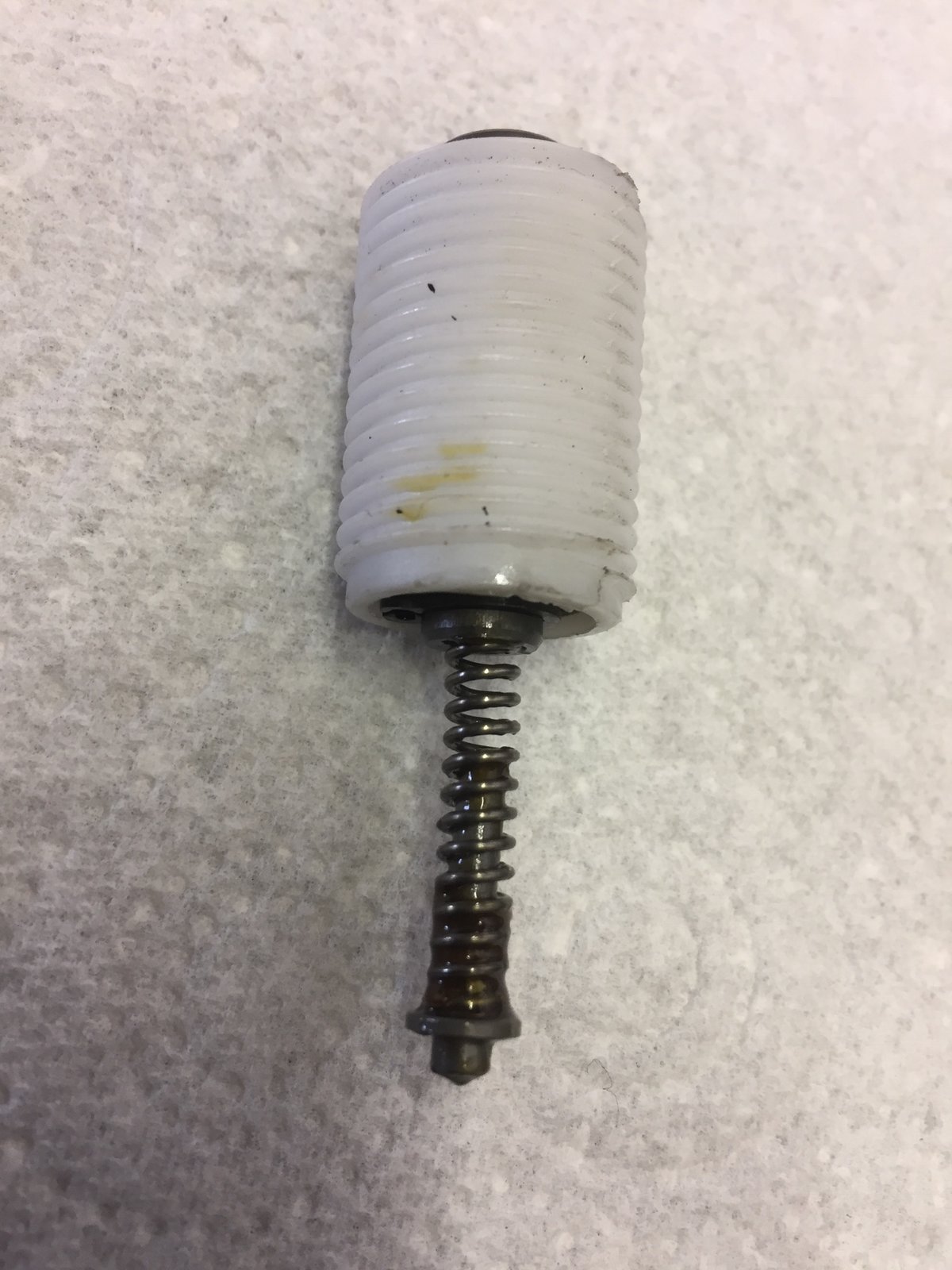

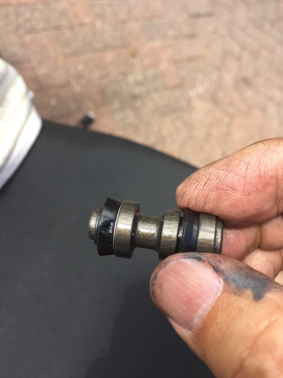

  1. Hi if you have a ST3 then you may find that you can replace the actuator on your clutch switch without having to replace the whole switch unit at a cost of £45.00. The switch is a Burgess V4NCS but the push button actuator is available separately from most electronics outlets for £4.00 (Long overtravel actuator kit from Saia-Burgess Mfr. Part No. QA4). You just unclick the broken part and click the new fitting into place. If you need to replace the whole switch then order a V4NCS and the actuator. I used RS Components for mine. Safe riding. Barry

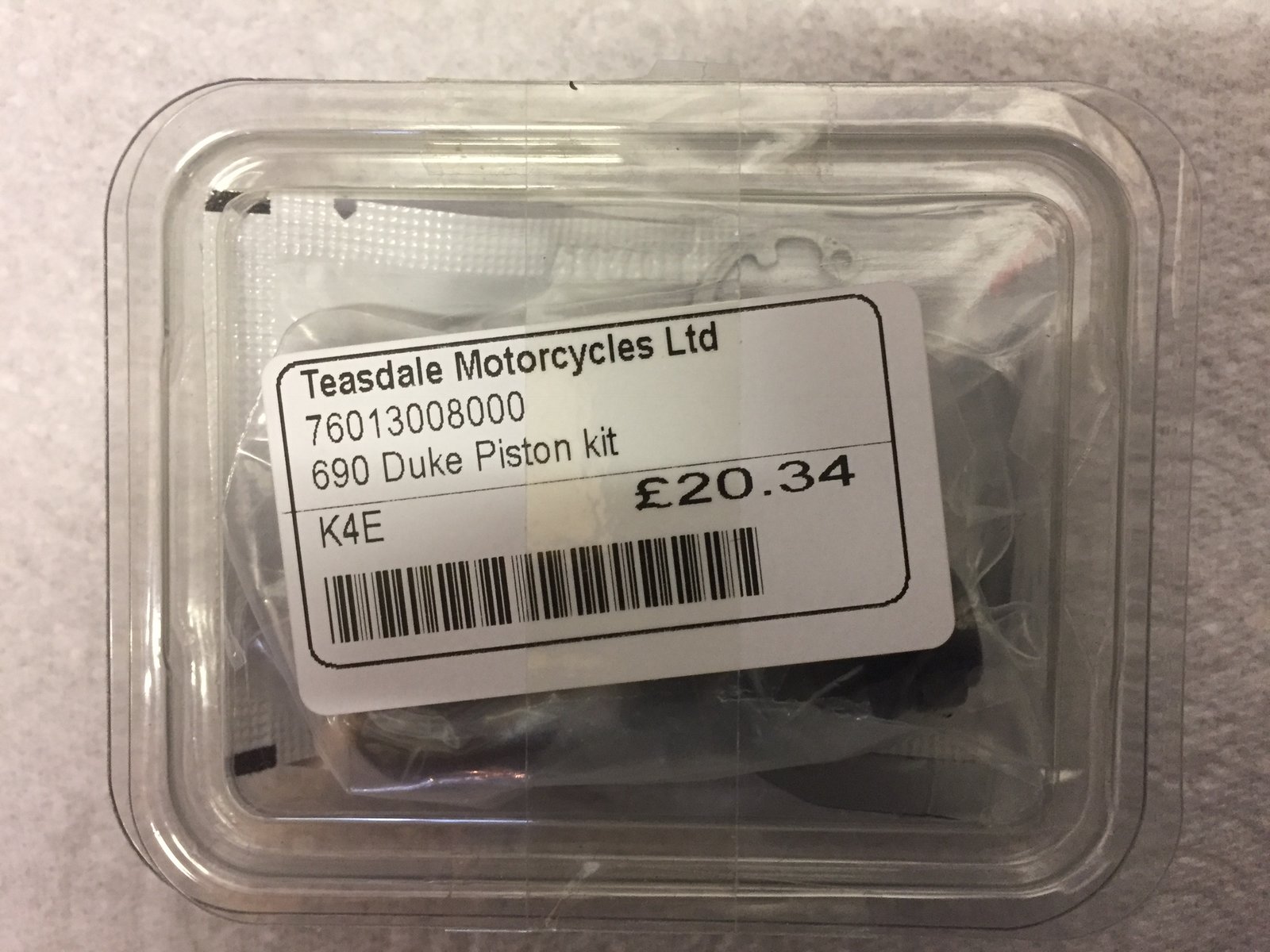

  15. 899 PANIGALE CLUTCH MASTER CYLINDER OVERHAUL
    During a recent biking holiday in Germany, I started getting problems with my clutch, it was dragging badly in the heat ( 34c !! ) so I bought some dot 4 and bled it - no better at all!
    So this made me think that some of the seals may be breaking down, I didn’t think it was the slave cylinder as I was loosing no fluid, but you could hold the clutch lever in and after about 5 seconds you could feel the pressure disappear...Hmmm.
    With the bike engine off, but in gear, I could pull the clutch in and push the bike for about 12 feet before the engine compression would stop me ☹️
    It was a bugger getting the bike back on the ferry with a dodgy clutch and not being able to slip it, you could see all the other bikers thinking “ That bloke with the Panigale’s a right nob, can’t even ride it!! ”

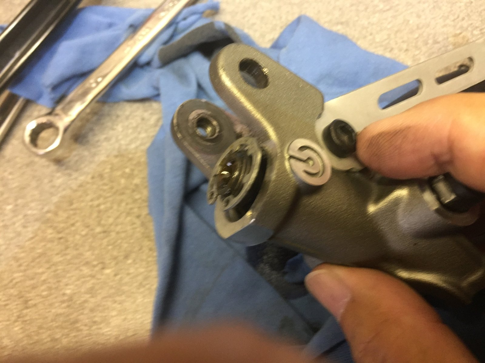

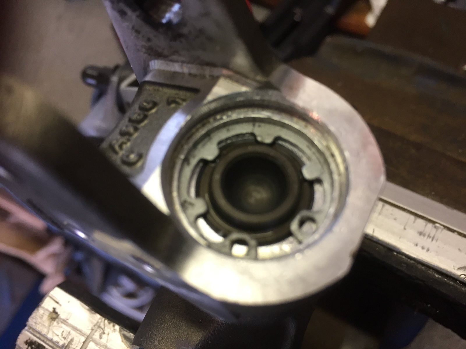

    Anyhow, I pulled the clutch master cylinder apart when I got home and discovered that the front seal had some strange scuff marks on it and under closer inspection, one of them had a tiny hole through it ( see pic below) just enough to make your clutch work for about 5 seconds before it bleeds through and you loose pressure....
    Aha!!.. I knew it was a problem with the bloody master cylinder
    So I rang up my friendly local Ducati “stealer” to try and buy a seal kit for the clutch master cylinder, only to be told that Brembo don’t sell the seals separately, you’ll have to buy a complete master cylinder assembly...
    Including vat, £240!!!.......but I only need a five quid seal??
    Well Mr Ducati / Brembo...you can kiss my big fat hairy Geordie arse before I pay that when all I need is one poxy seal !!

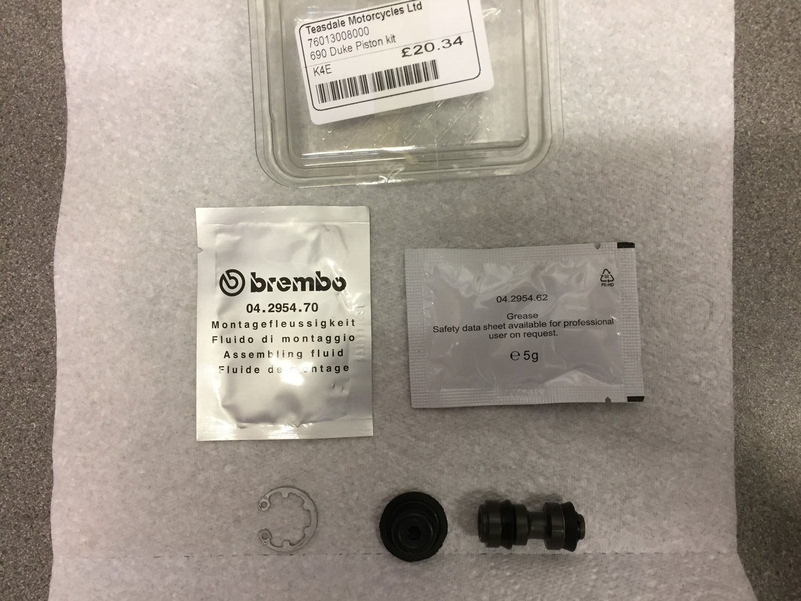

    So I had heard that KTM stock a few Brembo seals, but the hard part is knowing what KTM part number is the equivalent of the Ducati Brembo seal...only one way to find out,so I took myself off to Teessdale motorcycles at Thirsk armed with my trusty vernier calipers.
    A big thanks to Andy down there for having the patience to let me measure virtually every seal kit he had in stock, but it was worth it in the end.....WOOOHOOOO!!!!
    After five minutes of “fist pumping “ and high fiveing all his customers I finally calmed down enough to pay him the grand sum of £20.34......result!!!
    That’s a saving of about £220 on what the Ducati stealer wanted.
    Must remember to nip back there sometime and buy a V4 Tuono

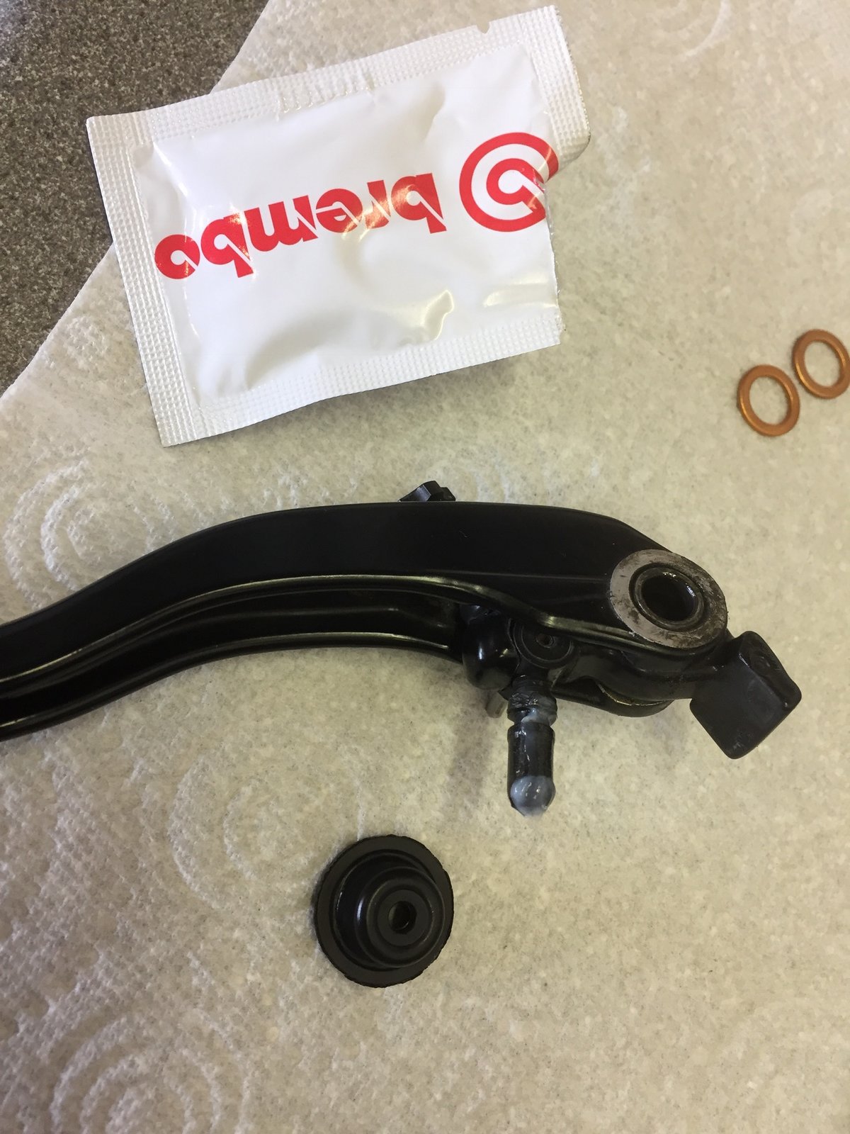

    This is what you need, the long part number is the KTM reference number to order- 76013008000
    Contents of the seal kit -
    Assembly fluid to coat the seals and cylinder bore
    Pack of grease for the clutch lever pushrod pin
    One circlip
    One rubber dust boot
    One piston assembly with both seals

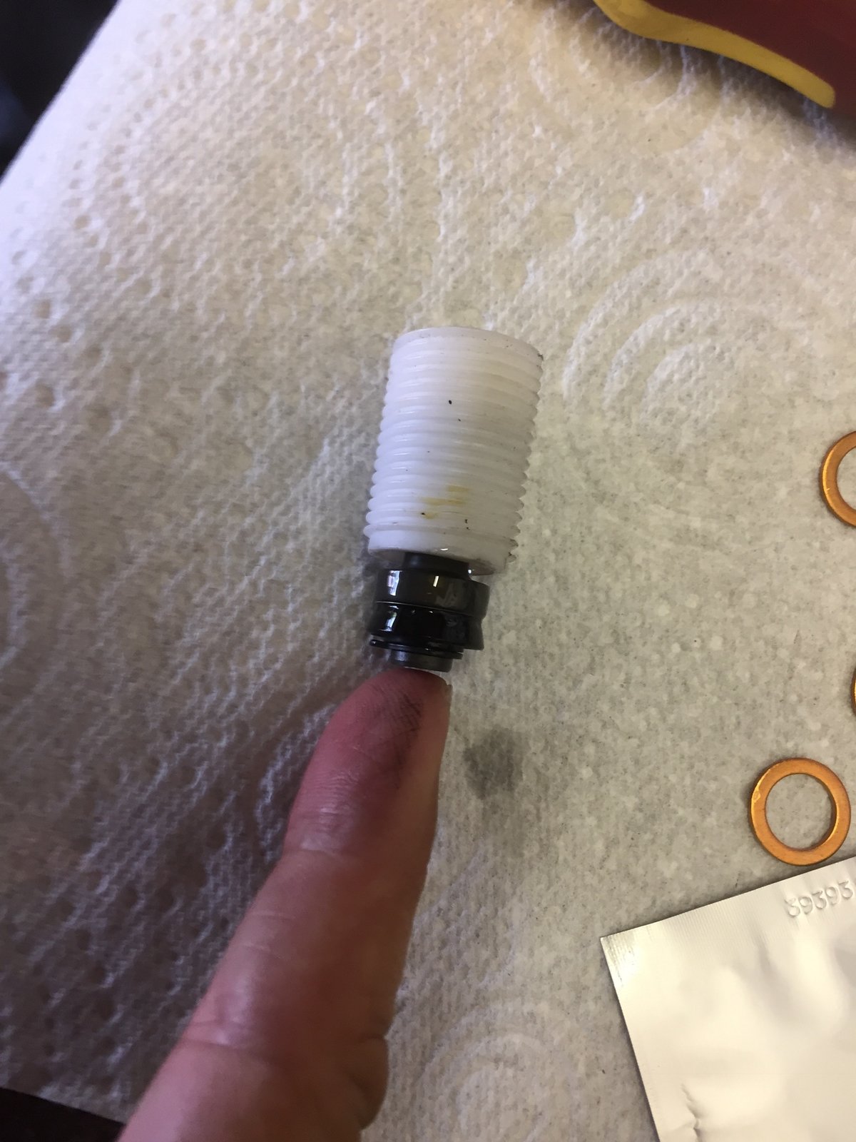

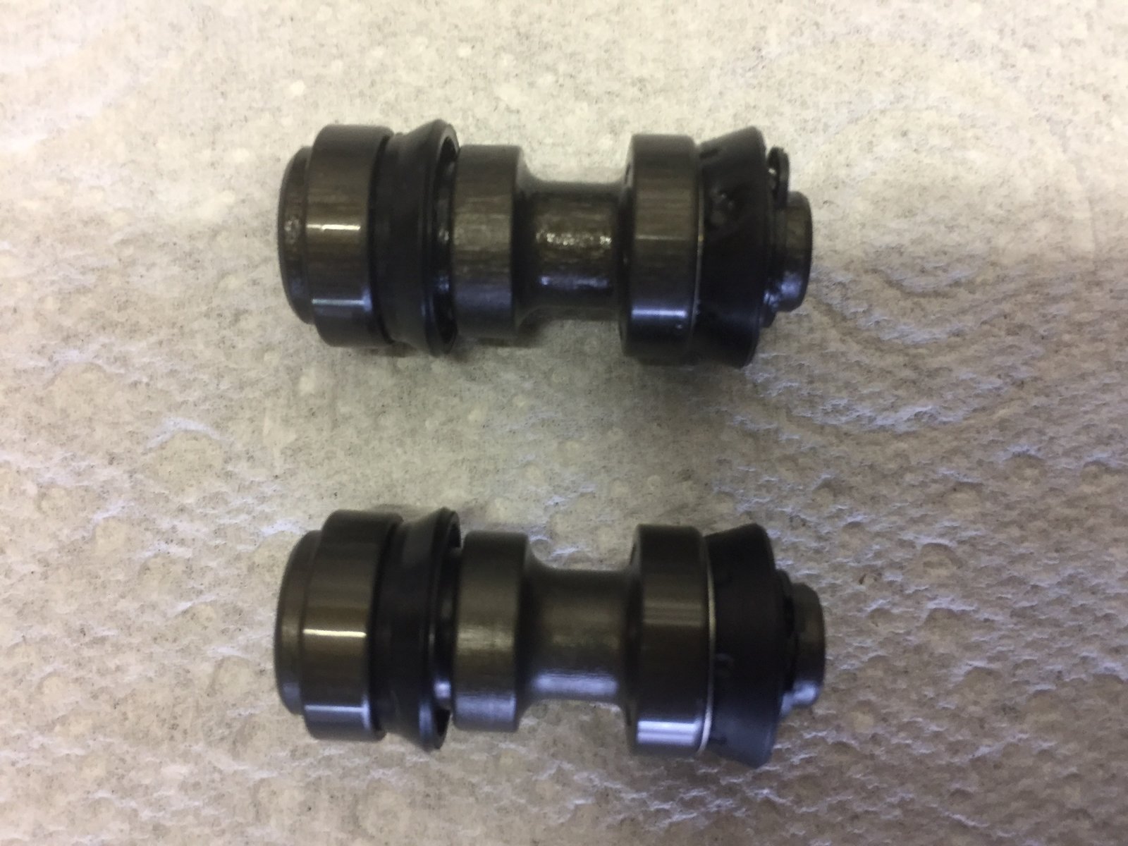

    Old piston top, new one bottom
    Apart from a few drag marks, it’s only the front seal on the old piston assembly that’s knackered
    I think where the drilling’s for the reservoir break through into the master cylinder slightly shave the front seal and it’s a really soft shore hardness rubber and eventual it just wears through.

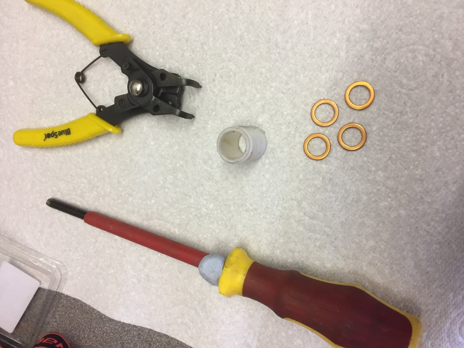

    Some tools you will need ,
    internal circlip pliers
    New copper washers
    A 40mm length of plastic pipe with an internal bore of 15mm diameter- I’ll explain later why.
    And something to push the master cylinder piston back with, I’ve modified an old screwdriver and ground the end off so it’s just nice and smooth and round, also note there’s a great big blob of Blu-tack near the handle- explain this later as well

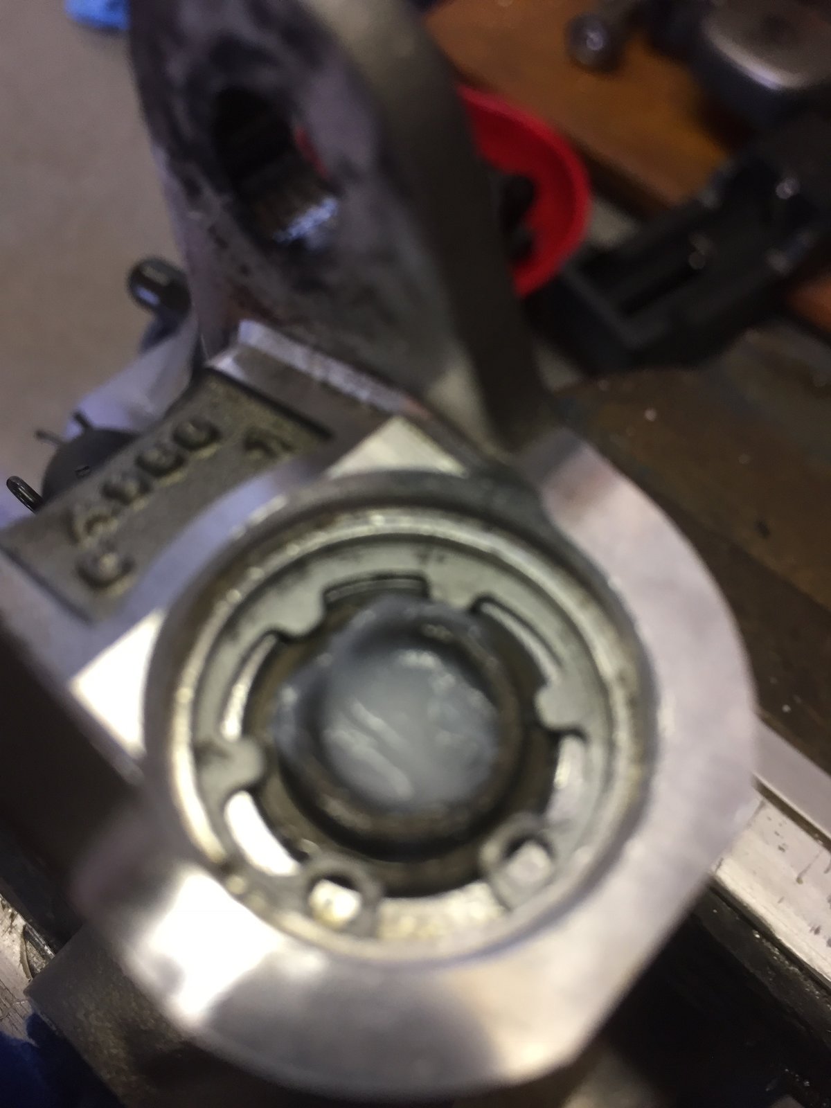

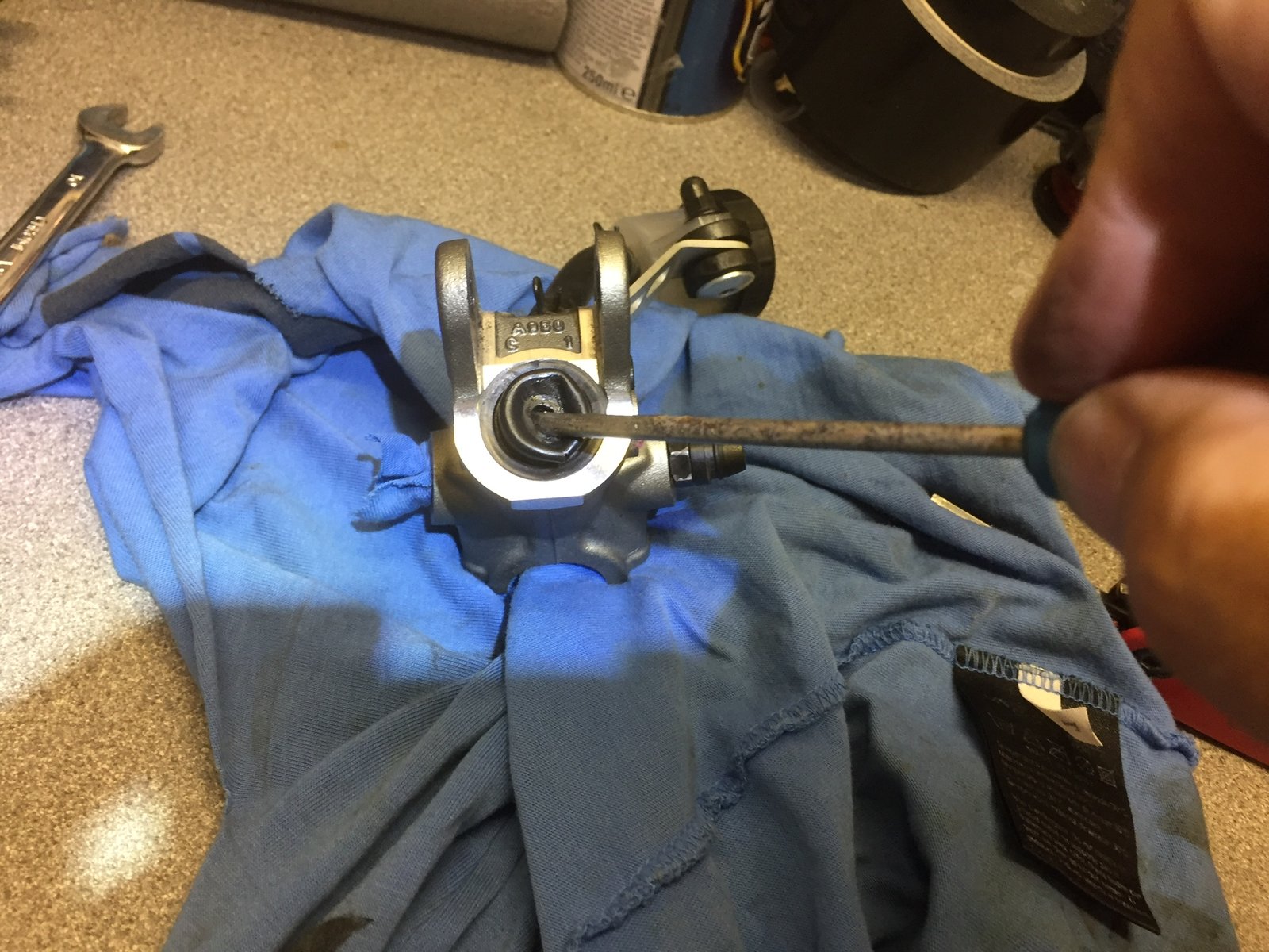

    Undo the pivot nut, and unscrew the clutch pivot lever and remove clutch lever, now GENTLY prise dust seal out by inserting a small electricians screwdriver inside and levering gently at the harder edge , obviously use two hands for this, I’m holding the bloody iPhone don’t forget!
    Undo circlip and piston will pop out by 5mm or so, withdraw the piston assembly, the spring and the locating pin that fits in the end of the spring

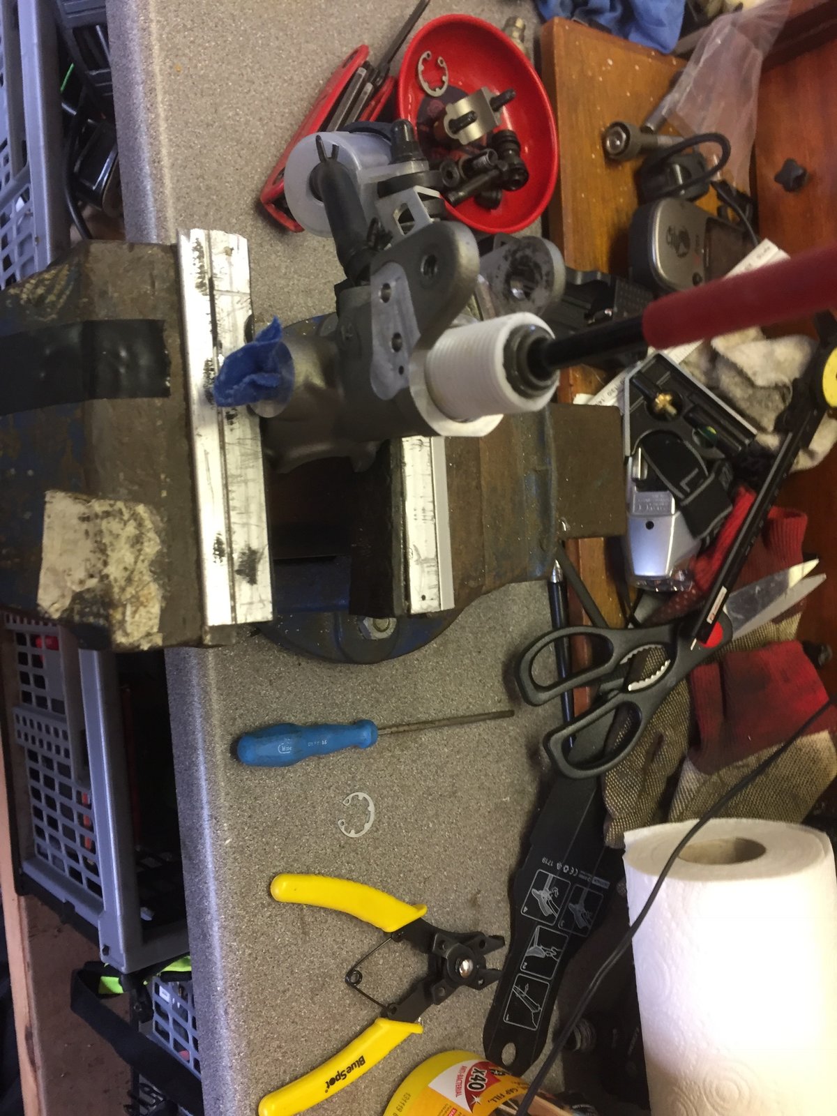

    Now, this is where that bit of plastic pipe comes in, you need the 15mm bore to be able to load the new piston assembly into backwards so that it compresses the seals to make them easy to get back inside the master cylinder.
    There’s too much going on in a very small area to be able to get your fingers in there, so this loading “cassette “ will make the job so much easier .
    Smear the piston assembly, plastic tube and master cylinder bore with the assembly fluid And load the piston assembly backwards into the tube as below
    Now using some thick grease ( I have a pot where it’s gone slightly dry at the edges, that’s ideal ) put some on the end of the spring that fits inside the piston assembly and then some on the location pin and put the whole lot together as an assembly, you need to be able to hold this lot vertically without anything dropping out, you now have a Piston assembly “cassette “ as below

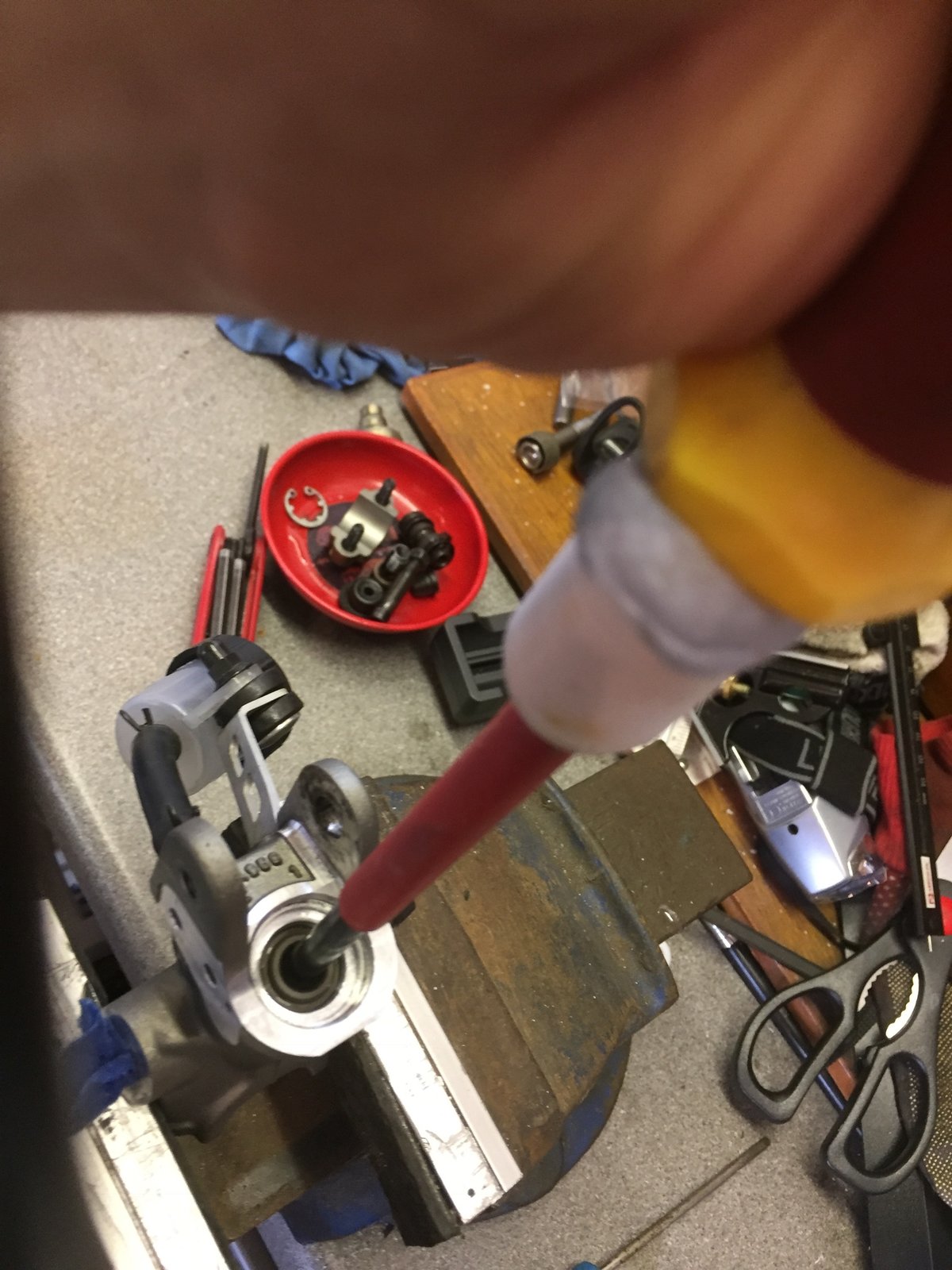

    Drop this lot vertically into the master cylinder ensuring the location pin engages correctly, Using the pushrod in your left hand, feed the assembly back into the master cylinder, don’t go nuts, you’ll just feel a couple of bumps as the seals go into the bore,

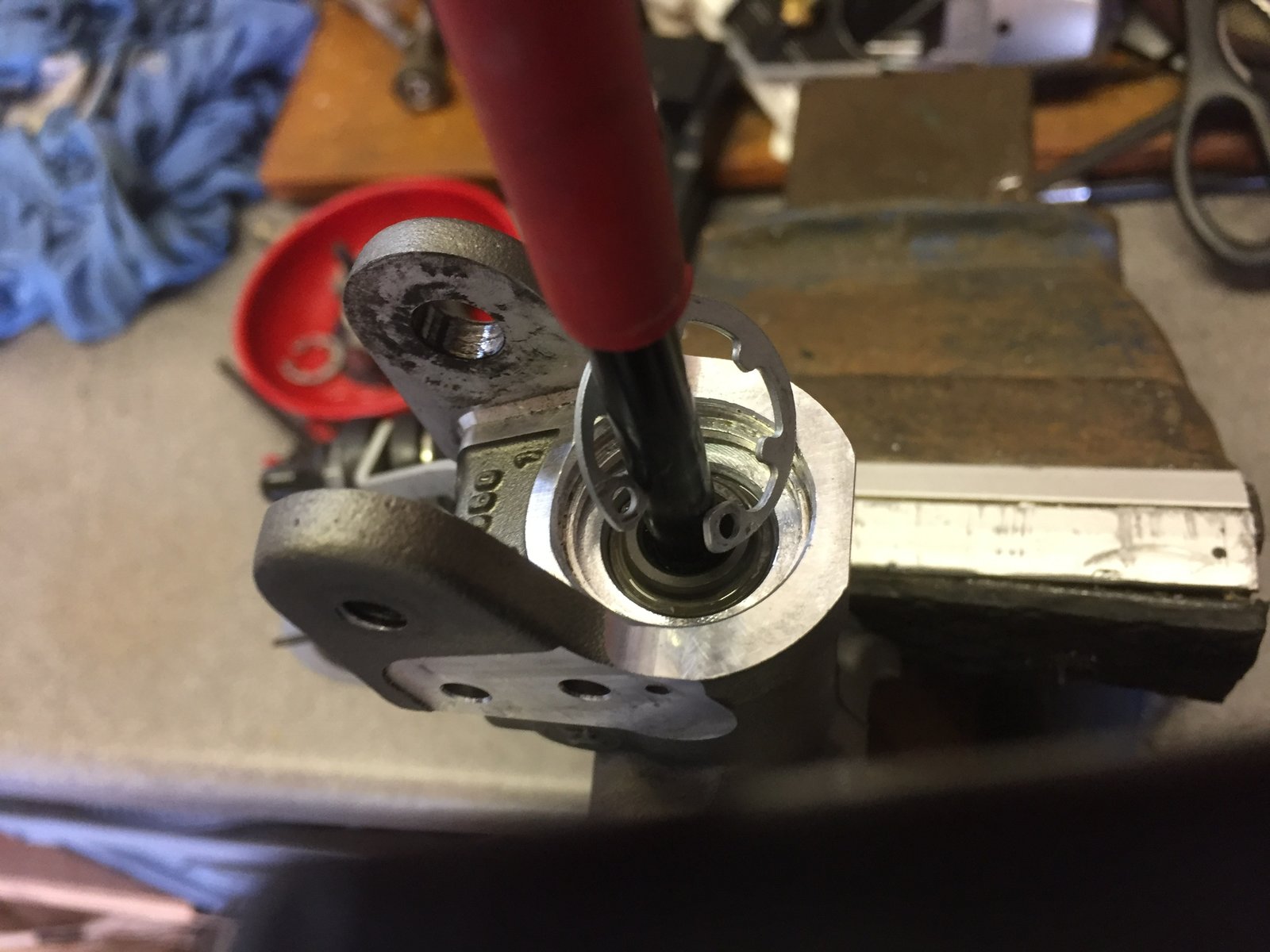

    You don’t need to push it too far in, just 5mm or so below the circlip groove and hold it there, note you’ll need the circlip, circlip pliers and small electricians screwdriver within easy reach of your right hand
    Now slide plastic pipe back up out of the way and the blu-tack will hold it back and keep it outta your way to make the next stage a bit easier
    Drop the circlip over the pushrod and clip it back into position
    Make certain it snaps into the groove by giving the ends of the circlip a bit of a push with the screwdriver, it’s important that you check it has clicked into the groove, you don’t want it dropping out when you’re halfway down the road!!

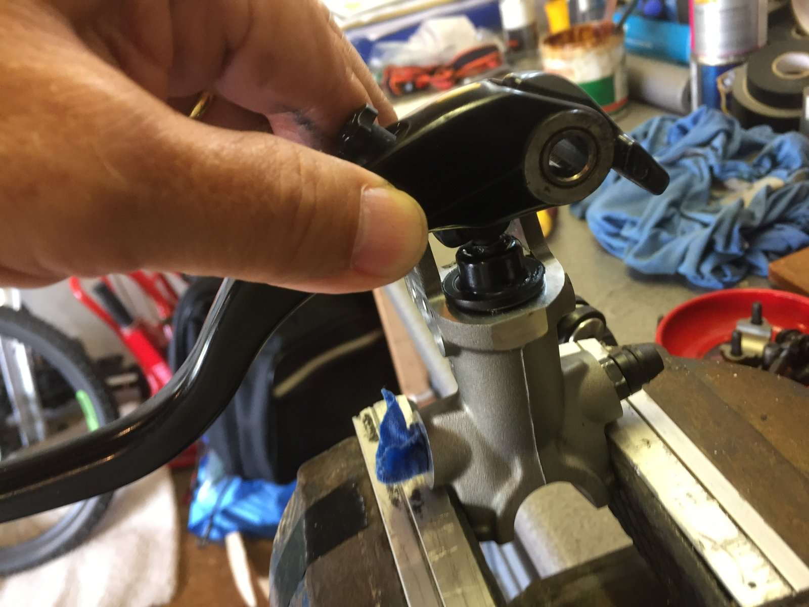

    Grease up clutch actuator pin and push dust cover back onto pin making sure it snaps back into groove on pin

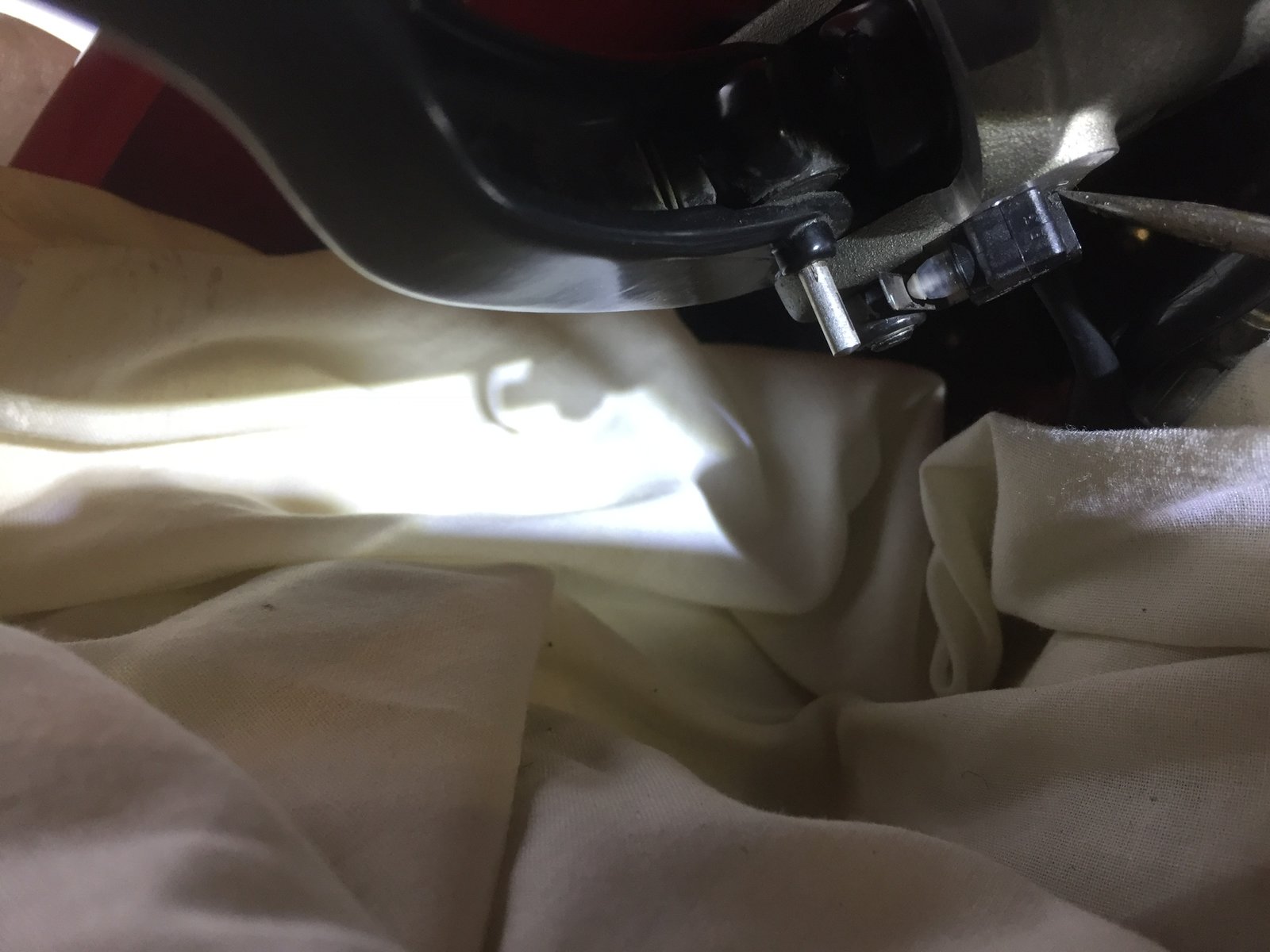

    Offer clutch lever up at 90 degrees to master cylinder as it makes it easier to snug the seal down into its counterbore gently using a flat screwdriver, once it’s in place, rotate the lever to its correct position and screw the pivot rod back through it and fasten nut at back
    Pop it back on the bike, put some new copper washers on the hydraulic hose nip it all up and bleed it.

    One more thing, there’s a big green elastic band in the packet as well, once you’ve bled it, pull the lever right back to the bar and use the elastic band to hold it in position overnight, take it off in the morning and it’ll be nice n hard...fnarr, fnarr!
    Once that’s done, crack open a beer of your choice and congratulate yourself on saving 220 quid !!
    Hope this is clear and it’s helpful to someone, any questions just ask
