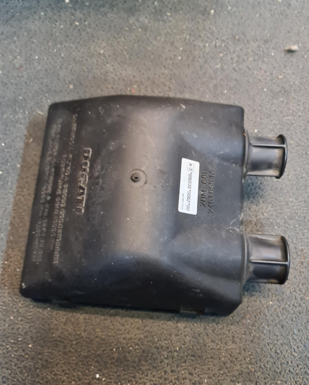

  4. I have an ST2 lid you could cut up, its higher than the SS but the base is the same. £25 inc postage
  5. I just bought a complete top and chopped the surround off- its all the ducati performance one was.

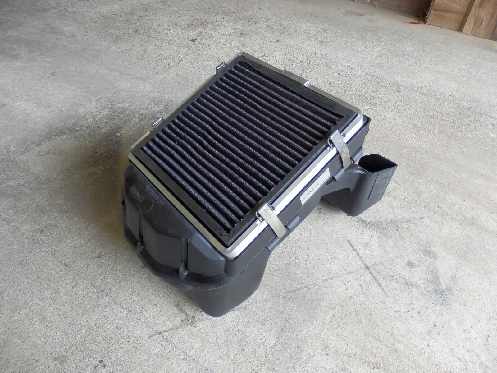

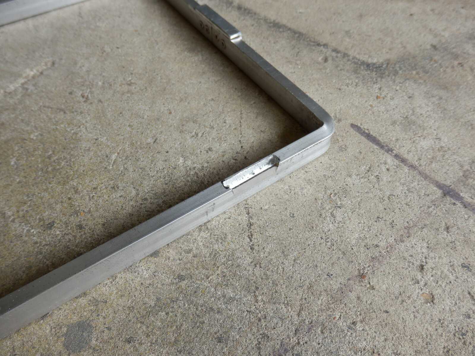

  7. Made one myself for my M900 from square section ali bar, and milled out some slots for the clamps.
    i might think about making some more, but have a couple of weeks of fitting a new kitchen for Lady Nasher before I could think about it.
    Nasher
  8. Nice job that! :upyeah:
    Certainly looks a lot more respectable than my hacked up plastic lid o_O
