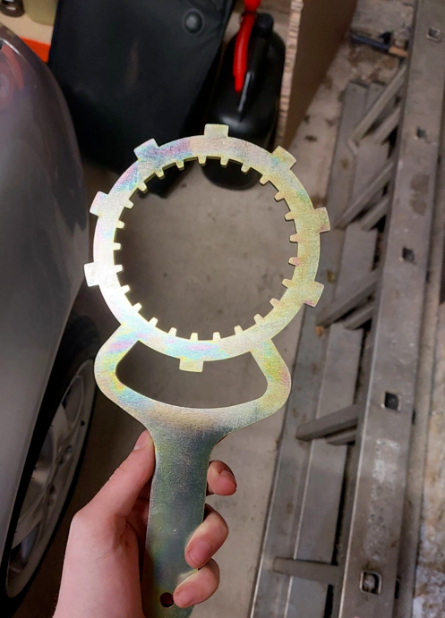

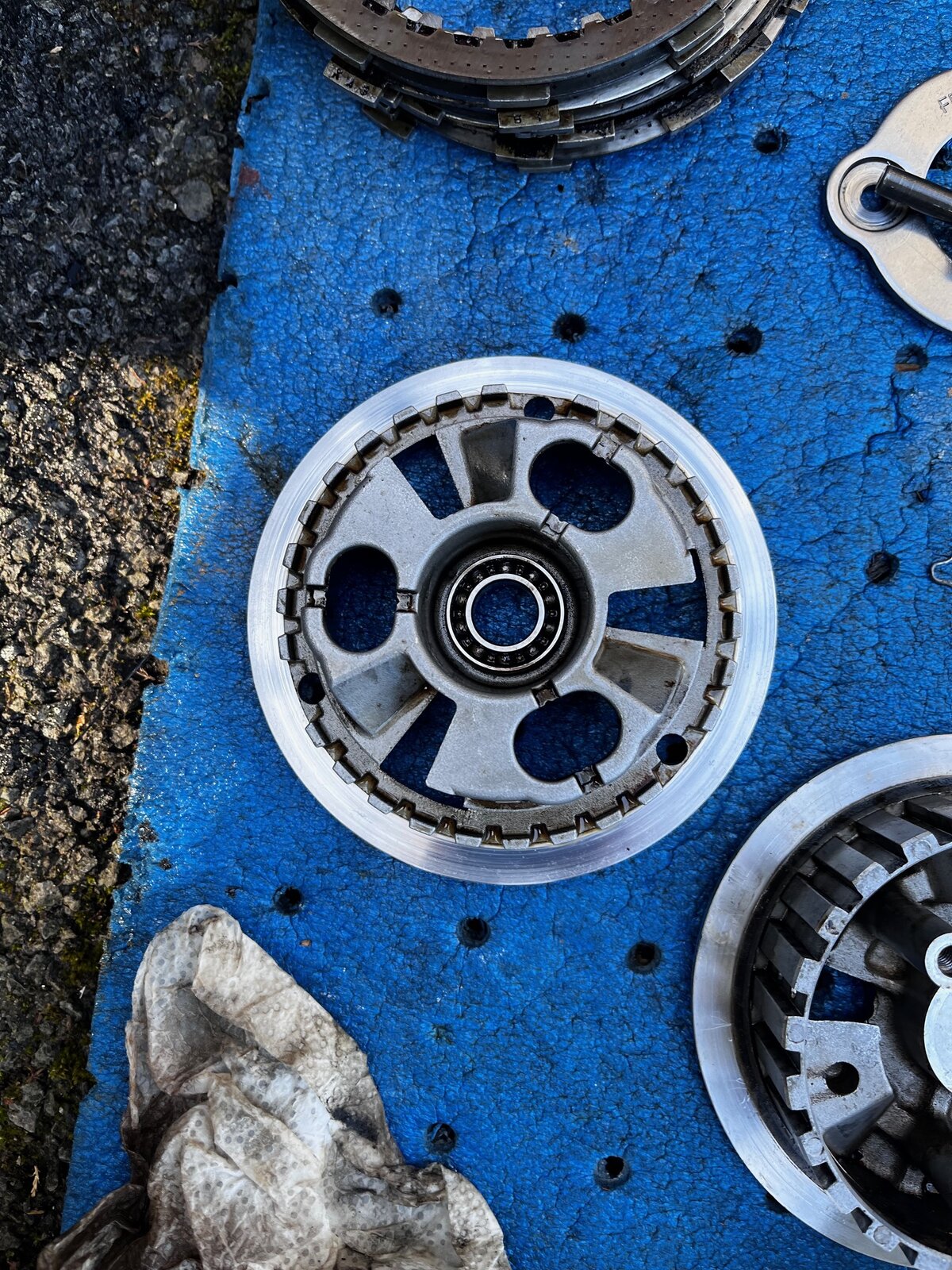

    Renewing the clutch

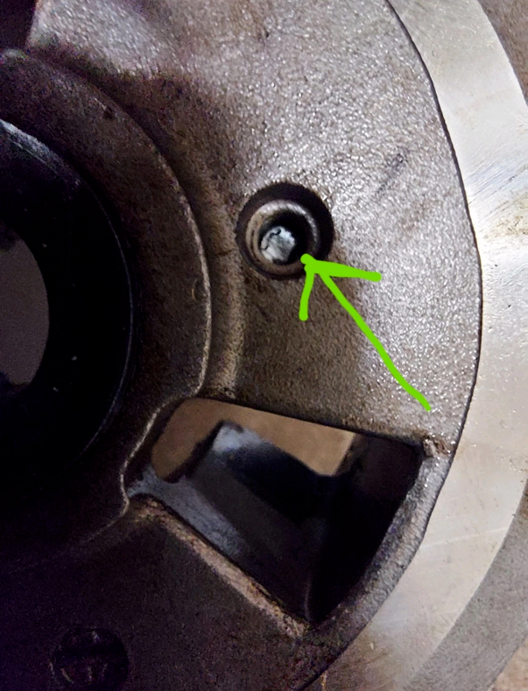

    When I bought the bike the clutch came separate -in a plastic bag. Unfortunately, I discover a bolt has been over-tightened in the inner clutch hub resulting in the bolt shearing. Happily I was able to drill it out with a modicum of swearing and no helicoil. I’ve never installed a clutch before, but my manual was pretty good and after looking at the diagrams, I pile in. Now KTM 390’s have two types of steel plates in their clutch (perhaps most bikes do?). The Newfren set only contains one type. At last my luck with parts is less bad as the totally fubared -blue and bowed- ones are the type they have sent, and I can reuse the originals of the other kind. It all goes back together with a bit of loctite and the special clutch tool - I've never seen one of them before!
    Quick insert of Motul, plus 3 sieves, rubber washers etc and all is well.

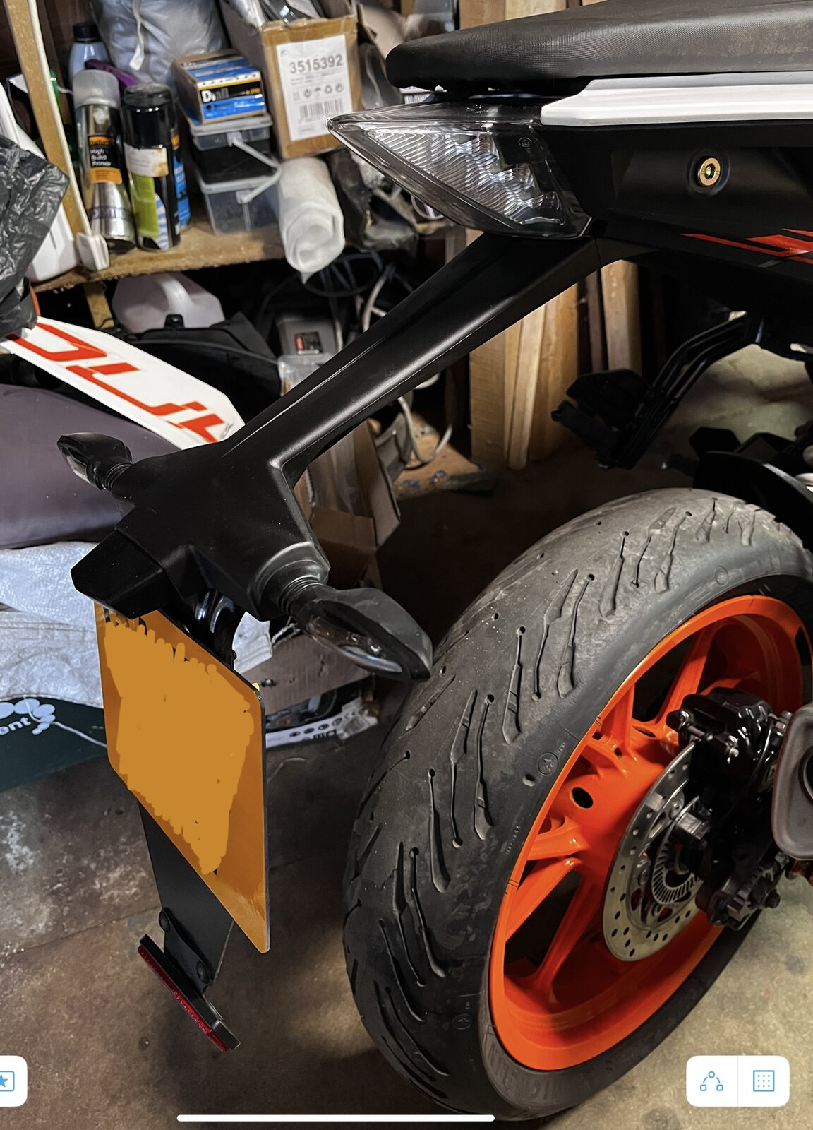

  6. The bike had an aftermarket tail tidy -a tatty & crooked thing which had seen better days. A total barstardo to remove, as three of the four allen bolts had semi seized in place. Unrepeatable muttering and cursing for some time turned the air blue in my little wooden "workshop", but eventually it came off and straight onto the bin. I replaced it with the OEM weird/ ugly one that came in a box with the bike. Lets face it, this is a quirky looking machine and a zen origami miniature tail piece is somewhat incongruous. The original long stalk thing looks far more in keeping with the overall look methinks. Plus it positions the reg plate to dramatically reduce the amount of wet road dirt I’d otherwise be wearing all over my back!
    Once the reg plate was drilled and in place, remounting the tail section and rear light followed. The light has somehow lost one of its locator tabs but a little strip of aluminium, a couple of blobs of epoxy putty, together with some black silicone (to stop vibration) sorted that out nicely.

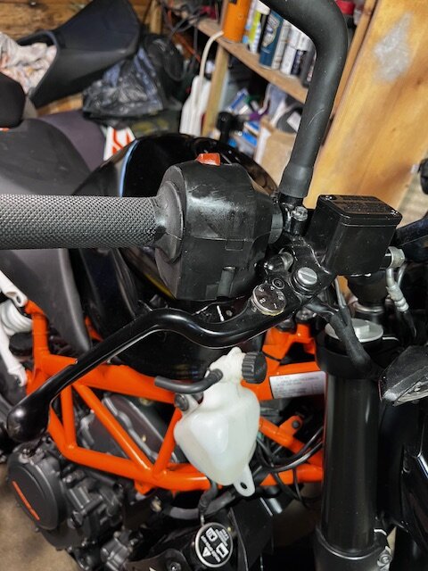

    I then switched out the front brake master & lever as it was all scuffed up from someone else's misfortune. Bled the brake, added a small top up to the rear reservoir and as the pads are fine, thats the braking all serviced.

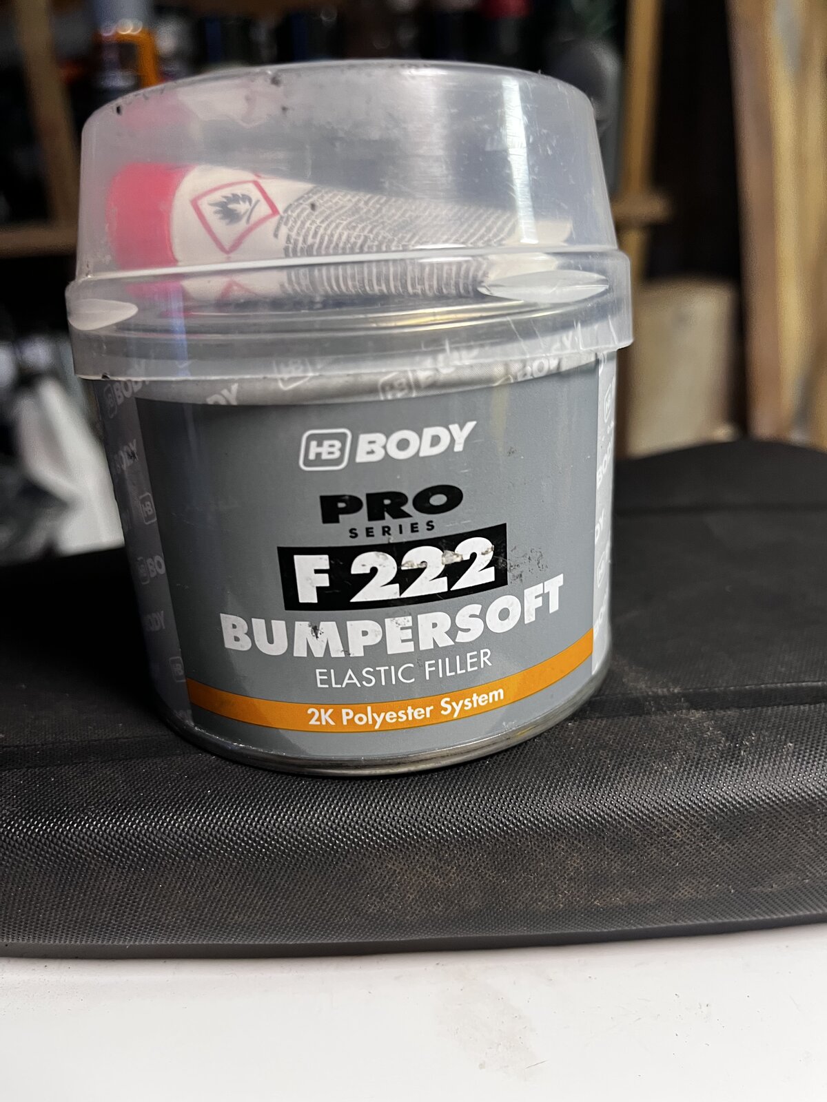

    Next I mixed up a little of the black plastic filler and used it to repair some scrapes on the righthand switch surround and the edge of the speedo. Once the repair was done, a little finishing with 2000 wet & dry, plus a small amount of polish and damage is almost invisible. Result!
  7. A tail tidy is all well and good but if you ride in marginal conditions and not just heatwaves it’s an essential.
    Nice that you’re tidying up the 390, but can we have some pictures.
  8. I did take a couple for myself but they don't really show a great deal.

  9. What’s the black plastic filler? Have you got a link or the name of it please?
  10. Yes here it is.
    Works really well. If you can’t find any around your neck of the woods let me know and I’ll send you a can.

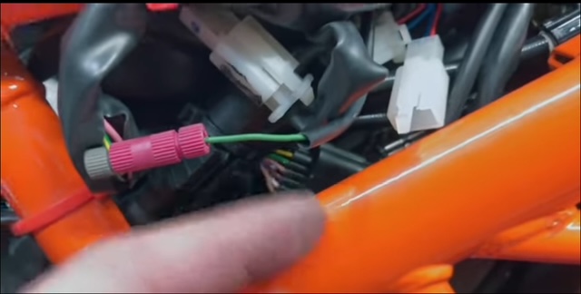

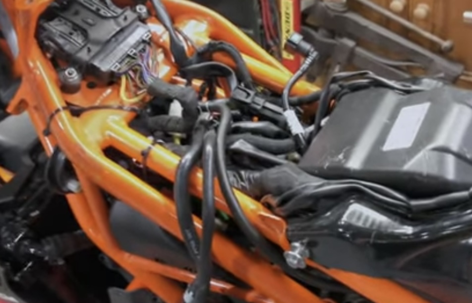

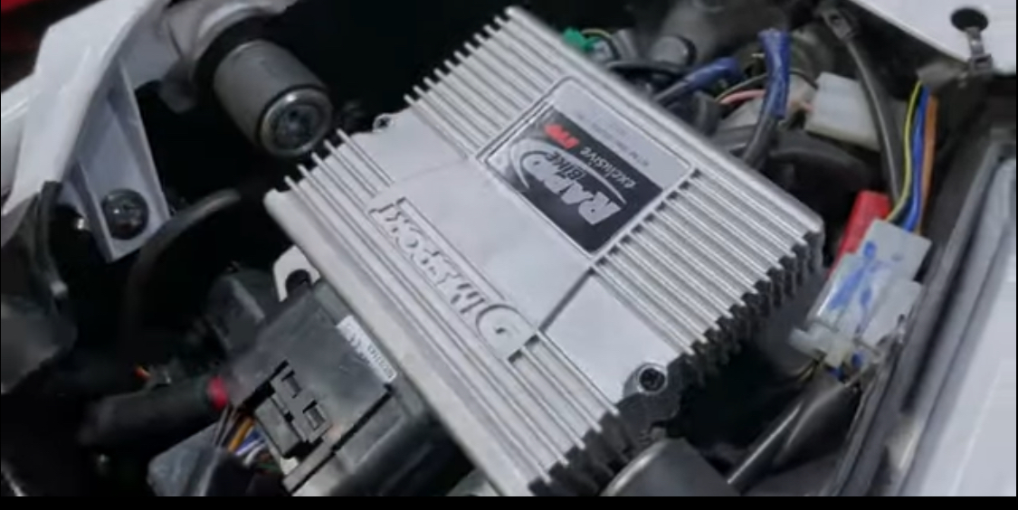

  12. Next up is the Rapid Bike Evo piggy back. Its a little gizmo which smooths out the fueling. The ECU on these bikes allegedly cannot be remapped. Maybe thats something to do with the A2 rules? The bikes leave the factory already tuned with a lean fuel set up and the Euro emissions rules prevent the ECU adding extra fuel to meet Euro emission regs. If you then add a lot more air, you may run in engine problems. This box sits in between the sensors & the ECU and re-calibrates the readings to trick the ECU. Meaning that most fueling/airbox mods can be done without the risk of running the engine too lean.
    I had to remove the tank to access the wiring but the Indian manufacturer has done a great job of making the install itself easy. The connectors are all compliant with the stock KTM wiring, so it's literally a plug and play and took maybe 20-30 mins in total. It sits nicely in the tail piece under the pillion seat.
    There's no EML lights on the TFT so I haven't cocked it up. There's no change in how the bike runs -which there shouldn't be- so another good sign! Ideally I will never notice any differences now when I make (minor) changes to the air intake & exhaust.

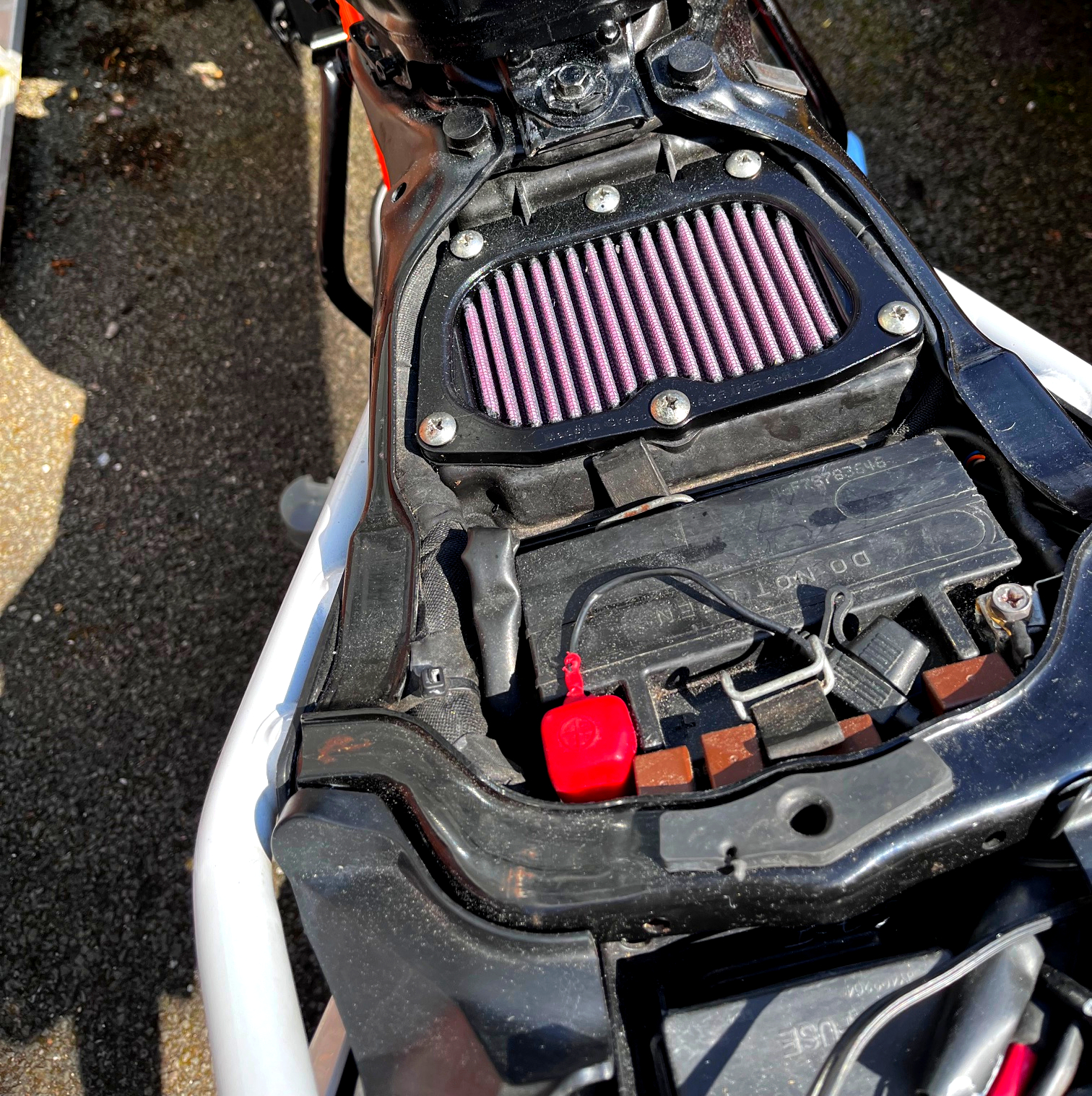

    Though I did cut the tank some more and added the air box mod! I thought the filter expensive at £52, but since I won't ever need to buy another its OK.

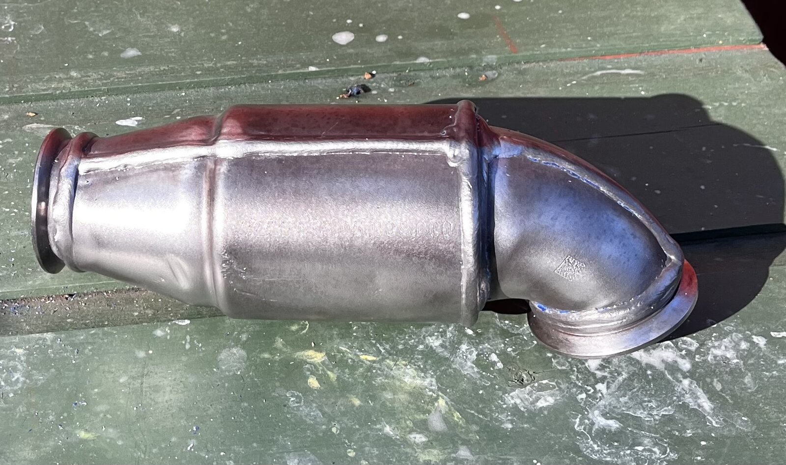

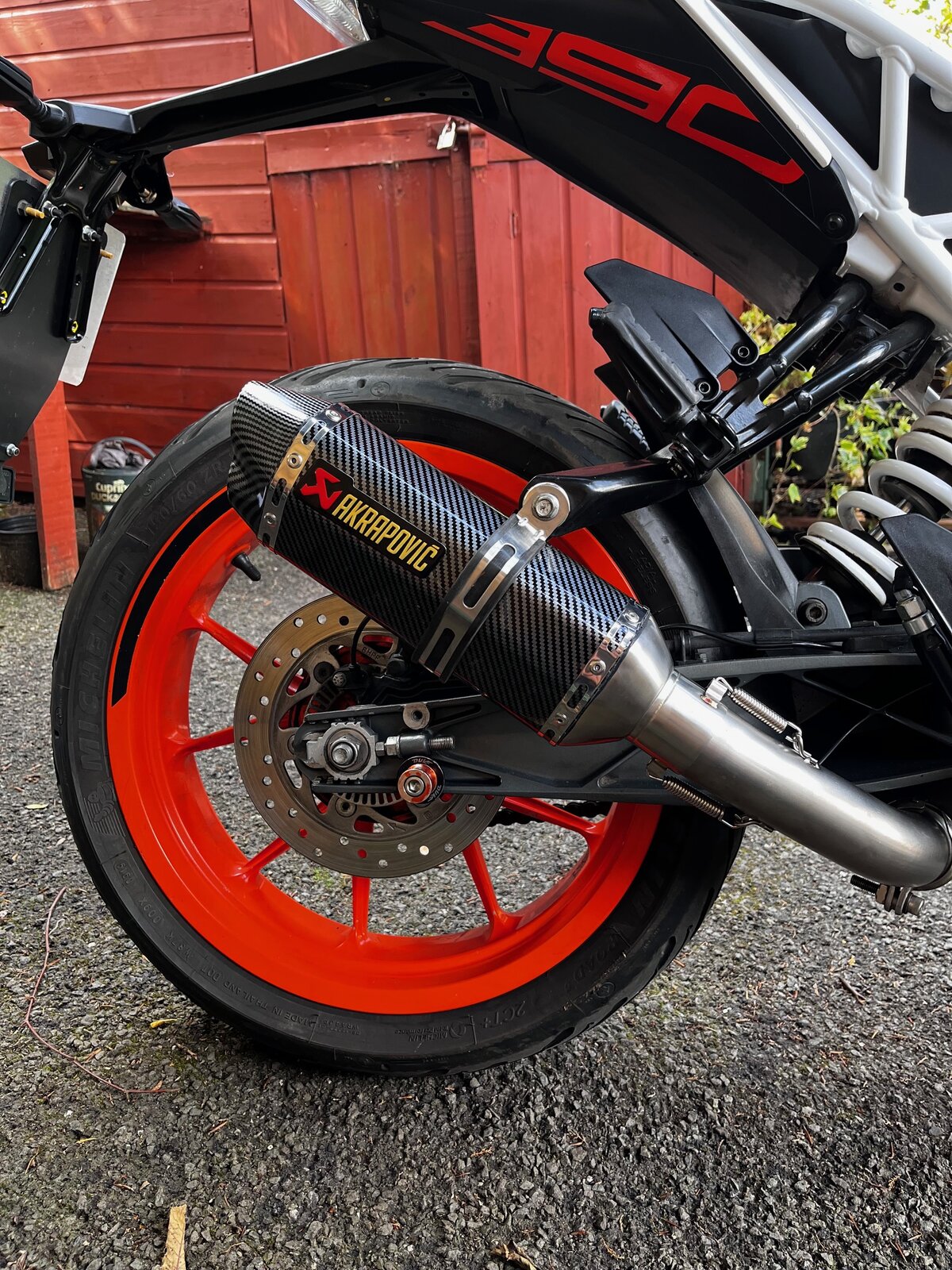

  16. Pulled off most of the manky exhaust and gave it a good clean up. The brown heat discoloration I don’t mind. Its the burnt on road crap and slight surface corrosion -thats got to go!
    The finish on these exhausts is similar to a sand cast, so with the brass wire wheel on the buffer/ grinder it was quick & easy. That buffer is one of the best (and cheapest, most used, time saving) tools I’ve ever bought! I didn’t want the faff of removing the header/down pipe as it requires the rad removing to access the studs and they are likely to be rusted solid. That can be a job to look forward to this autumn. I cleaned this part in situ using emery tape wrapped around once and pulling on alternate ends. Simple and quick.
    I also put on the £30 "replica Akra". The OEM has road scars and a few mashed rivet heads where someone has attempted to mod it? I will sort out now its off. My faux end can isn't super loud, its the same as the standard one, I measured the db using the Apple communicator. None of the deep thrumming, rumbling of a Ducati though -thats for sure! More of a brap sound like a dirt bike. It’ll do.
    Barstardo springs were a right pain. Is there a special pair of pliers or something similar that stretches the springs easily? There's no way everyone buggers about with a small screwdriver levering the things then looking for them again on the floor -like I did!

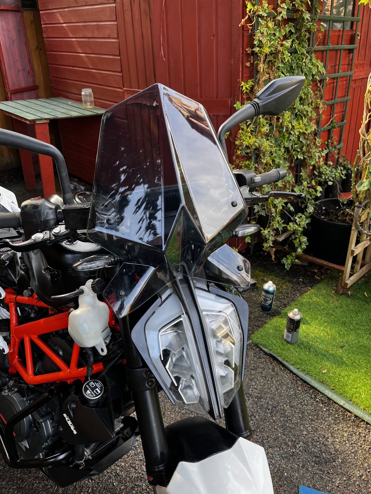

    I've added a screen. Not too sure about this. TBH, I only got one because I was mindlessly scrolling through Ali Express just after I bought the bike and had a momentary loss of reasoning. I can remember wondering back in the day why all the ol’ boys had them on their Honda 90’s -my mates and I thought maybe they used them as a sail to go faster. But times change.
    I’ve seen so many of you guys fitting them to Adventure bikes so its time to give it a try... It doesn’t look too bad. So we’ll see how it is out & about. I could get used it? Though I’m still not totally OK with having grandad (Saga) insurance, so the screen will have to earn its keep or it’ll be on eBay. LOL.
