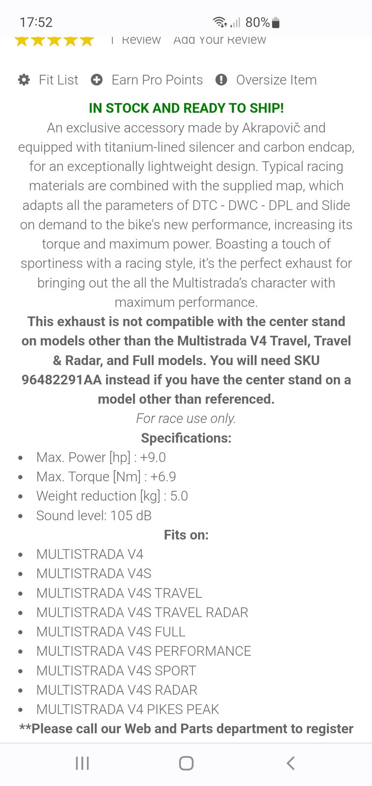

  1. Your screen shot shows 105db, you were right the first time. Way too loud for me ‍♂️
  2. And my neighbours!!
  3. Trackside, it’s 0.5m at 45° to the outlet and I’m guessing at around 6000rpm. I need to check what the Aprilia is. Ducati claim the Panigale V4 with race system and version 2 db killers is 107db. The Multistrada race system uses less complicated db killers and I have no doubt it will be closer to 105db. My MoT tester routinely adds the advisory ‘loud exhaust’ on anything not original road spec, even if it’s EU homologated. One of my regular destinations in the Eiffel Forest has banned bikes at weekends during the summer and as said, Austria is getting very strict. Had no issues in France but my 1200 end can, whilst quite loud, is EU homologated :D Andy

  6. 105db is not offensively loud to other motorcyclists but it gets you turned away from standard track days across the UK where the static test is 102db. Andy
