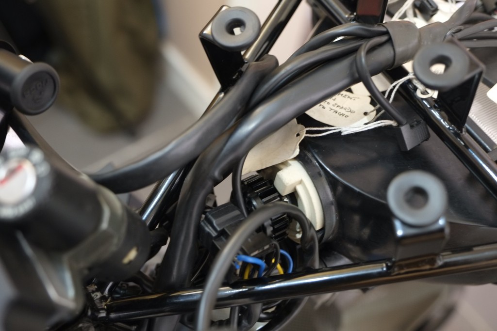

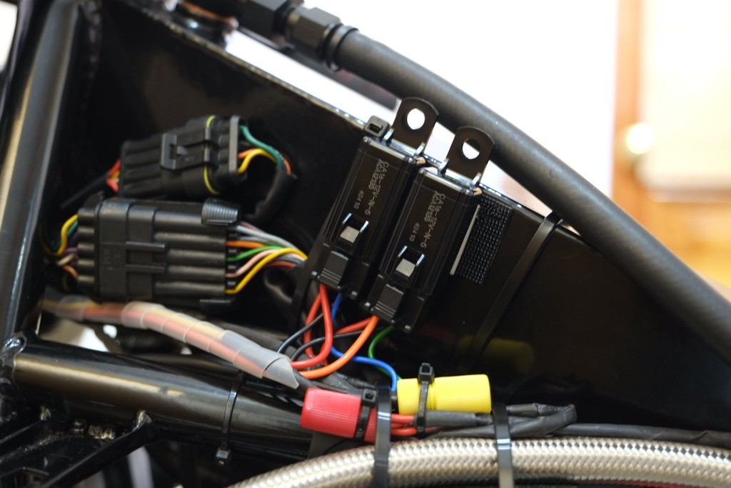

    I've installed a relay mod for the headlight. 2 reasons Guzzi have a seriously twisted electrical designer, I'll spare you the details but the relays make the headlight brighter and stops the switch from getting toasted. It also prevents the battery from exploding as the reg sensing line sees about 1.5 volts below the battery. This should might prevent that.

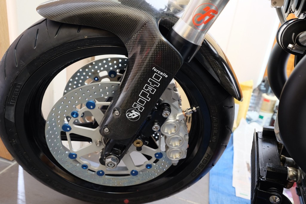

    Finally discs and calipers arrived from ISR, wife's goanna swing for me when she sees the next bank balance

    Big :upyeah: to @bettes for gettin me bars anodized black top class.......look great, pity I'll mark them like the complete clutz I am

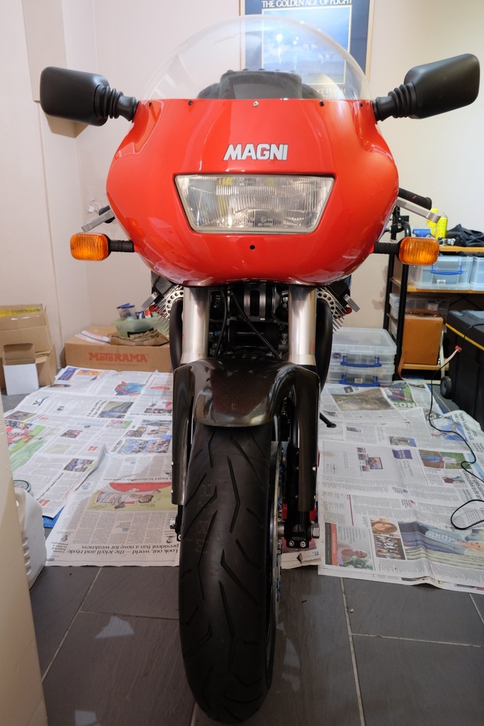

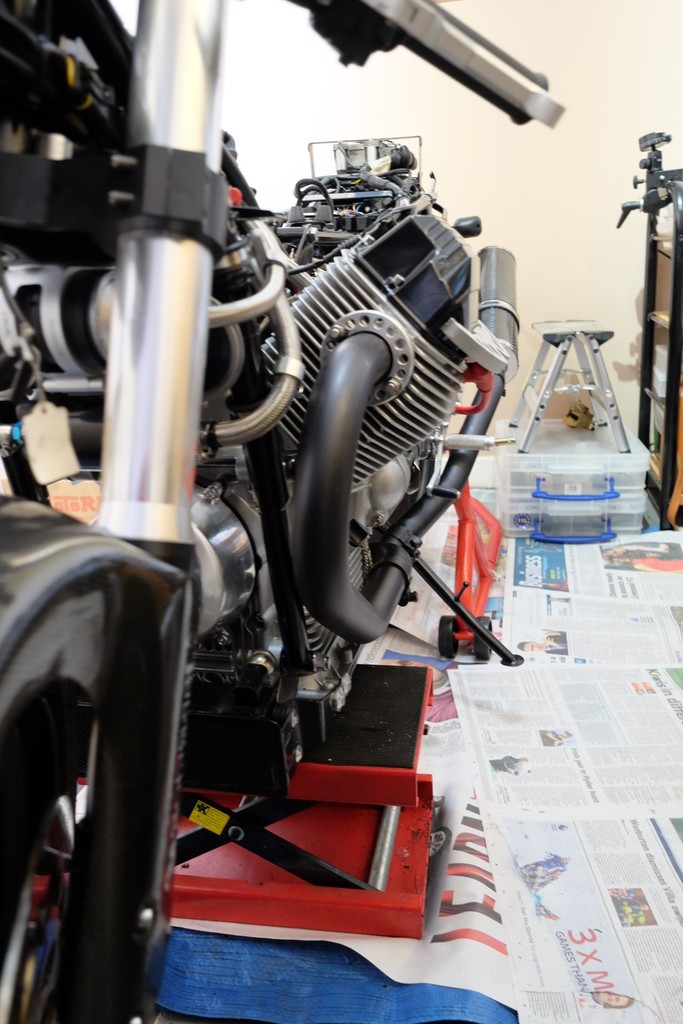

    Couple of overall shots
    The next shots are unsuitable for people with aesthetic sensibilities/taste & the fashion police already have a warrant out for me

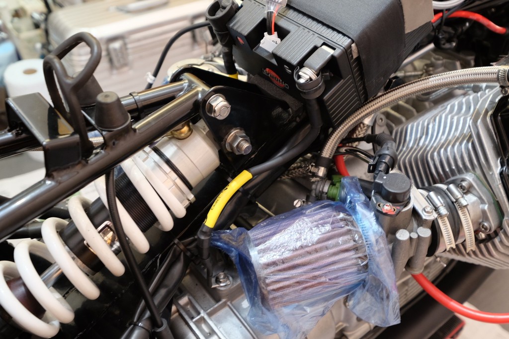

    @Exige helped me out with a custom set of battery cables for the battery relocation so a big :upyeah::upyeah:

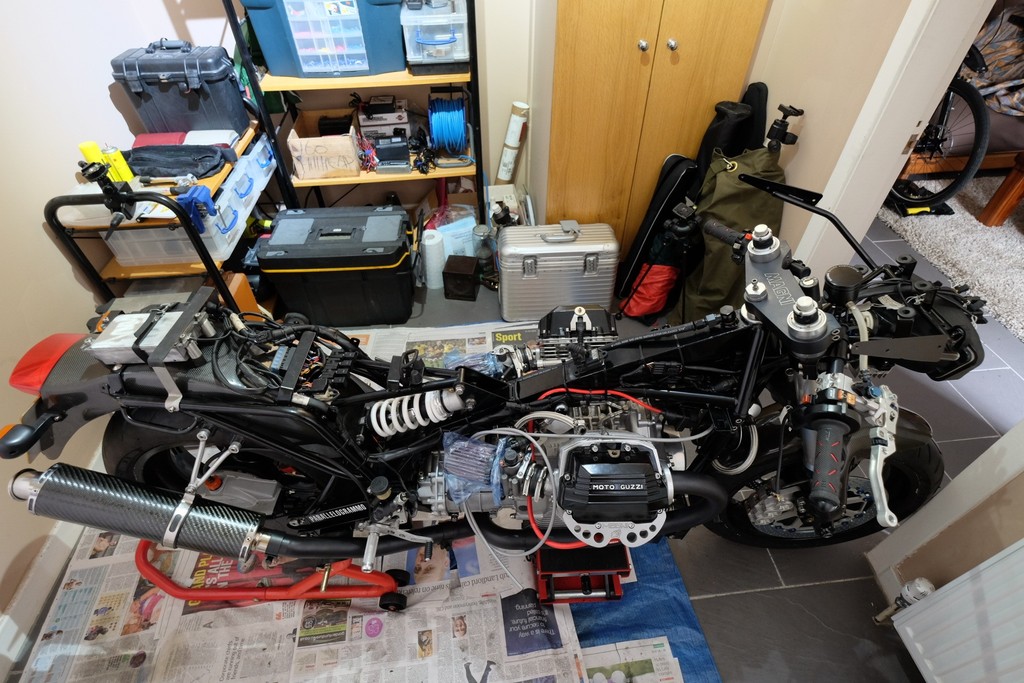

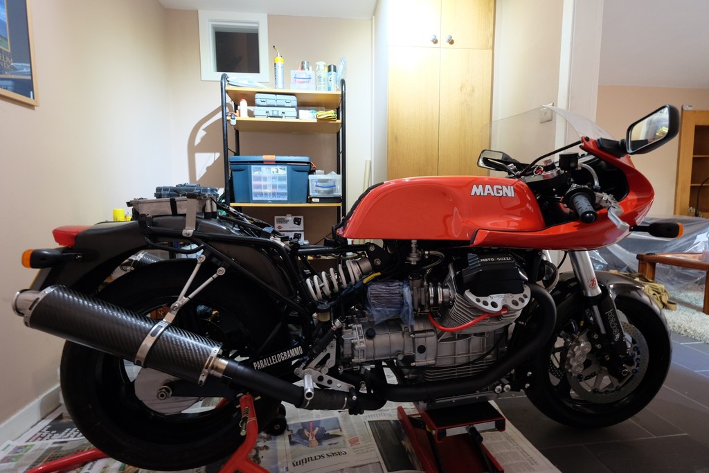

    So here are a few pictures of further bodging to date
    I know Guzzis are not everybody's taste and I seem to remember a certain forum member who'll remain nameless (@bradders) telling me it looked like Guzzi copied the Hayabusa's styling and made a complete arse of it..................wish he'd stop sugar coating to save my feelings
    I can't help it if I like Fugly bikes

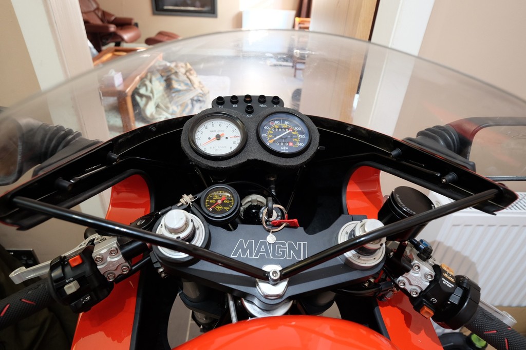

    Oh that pressure gauge is getting replaced with something a little more tasteful. Note to self only order shit when sober
    The mount also is a bit of a shit BUT........I didn't have to drill anything, it works and it's easy to take on or off, so as far as I'm concerned it works and its staying that way :scream:
    and lets not forget the battery cables (the middle cable is the balance plug for charging the individual banks of cells
    All in all this bike has been a bloody nightmare to strip and build. First everything was seized to strip and then everything has to hang off the spine frame on the build. Its chocka with with wires and plumbing for the FI and breather system. On the plus side share in Cable Tie makers have risen considerably.
    All I'm waiting for is aforementioned pressure gauge and some parts of the seat unit back from the painter..............then the fun begins

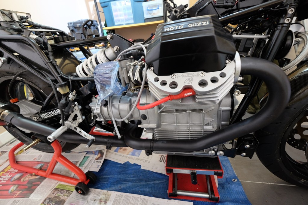

  10. do me a favor OJ. fit the correct size of hose clips to the throttle body's. there messing with my OCD.
  11. Okay dokey I'll get around to tidying some of the odds and ends..................would just chopping some of the excess do?
    They are JCS Hi Torque clips I think marine grade dunno if that's got anything to do with it @finm
