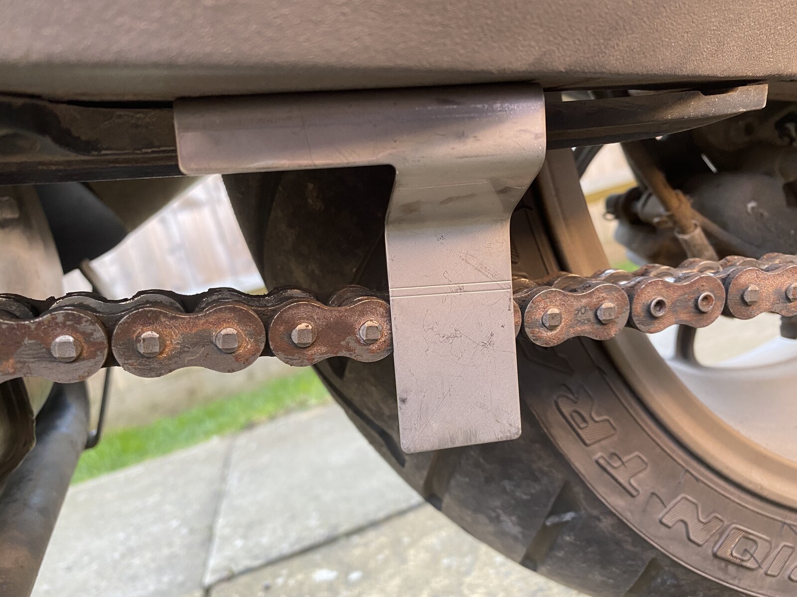

  2. Just measured the difference on my 1260S chain gauge - I set it as per the book (side stand, Urban, solo etc) then measured on centre stand in Touring mode, which is where it is most of the time, and the rivet centres are then 4mm down from the engraved marks on the gauge. Not a lot of difference really but enough to notice chain slap when it needs a little adjustment.

    I know this thread is probably more related to the 1200/1260, but out of curiosity, as I have a 2020 950s, does anyone know if there is the equivalent chain gauge tool for my bike?
    It seems so much simpler than faffing about with a steel rule and lets you attach the tool whilst adjusting as necessary.
  4. in the toolkit (red pouch) under pillion seat, the gauge & adjustment tools will all be in there, if you never received a toolkit, I would contact the dealer

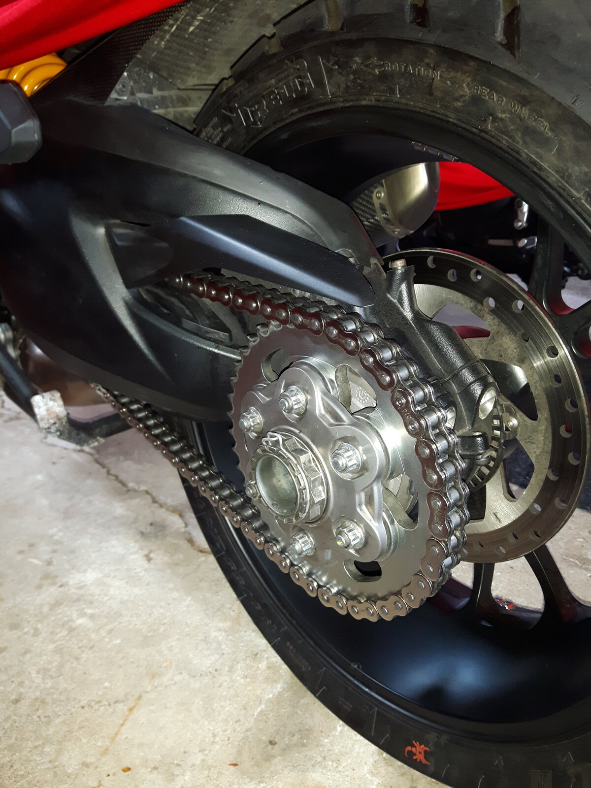

  13. When you actually ride a bike in real world conditions they're not going to look like that garage queen just cleaned chain

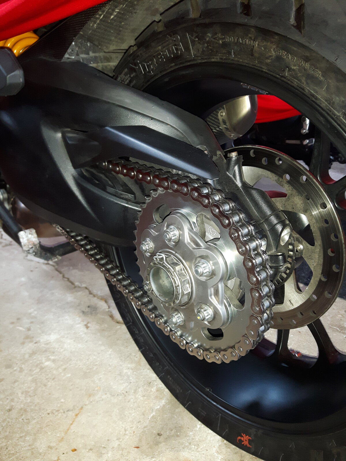

  14. IMHO, there's no excuse for a chain that looks neglected like that:
    https://www.ducatiforum.co.uk/attachments/img_0576-jpg.236666/
    FYI, I'm retired and ride aprox 12,000 kms per season. BTW, our season is only seven months.
    Considering that I don't tour, I think that's a lot of riding.
    The takeaway here is that I clean the chain after every day's ride without exception.
    It always looks like this:
    Keeping your chain clean is much easier than an overdue deep clean.
    Moreover, your chain and sprockets will last much longer.
    Slip-in the rear stand,
    Hand spin the chain with a rag doused in Simple Green,
    Brush it and repeat with SG if it needs it,
    Spin the chain with a clean rag to dry it,
    Then spin the chain with a rag doused in gear oil (or any motor oil),
    Spin the chain with a dry rag if you have to remove any overage.
    The whole process only takes a couple of minutes.

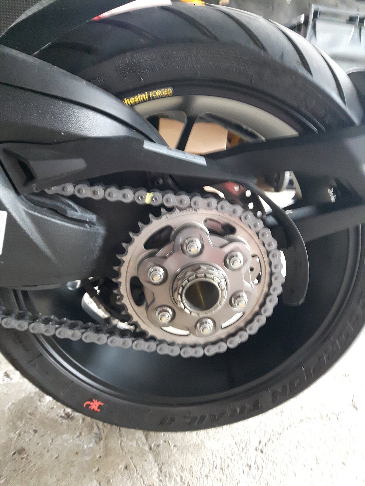

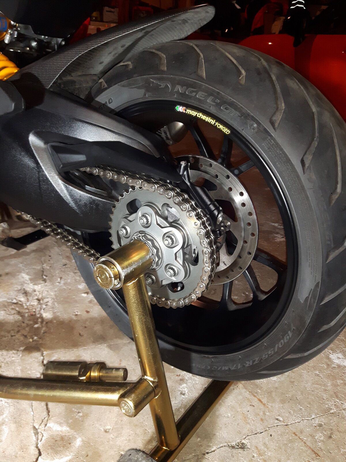

  16. That's exactly what I have and shown in the above post albeit it's color is silver not gold.
    It will still rust if not taken care of.
    The message for everyone is simple: "Clean It Regularly"
    Notice what it looks like now at 13,157 kms (minus 1000 kms) when the OEM was replaced.
    However, it's been cleaned after each ride day.
    #37 DarR, Apr 12, 2021 at 1:45 AM

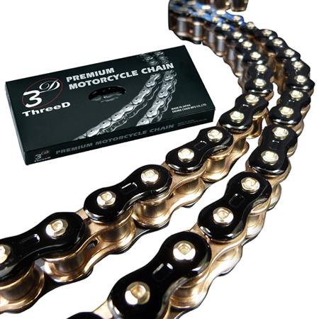

  17. The best chain really depends on what you're looking for.
    Strength:
    Drag Bike: RK 530 Pro DR Drag Racing Chain 11,900 lbs tensile strength.
    Screenshot from 2021-04-13 08:31:39.png
    Street Bike: EK ZVX3 11,100 lbs tensile strength.
    Bling:
    EK 3D 530Z the jewel necklace of chains
    EK 530 MVXZ Quadra-X Ring Powder-Coated colored chains
    Screenshot from 2021-04-13 08:45:45.png
    Versatility:
    EK (SLJ) screw-in master link
    Value:
    A slightly used (1000kms) Regina OEM chain
    Sold mine for $20
