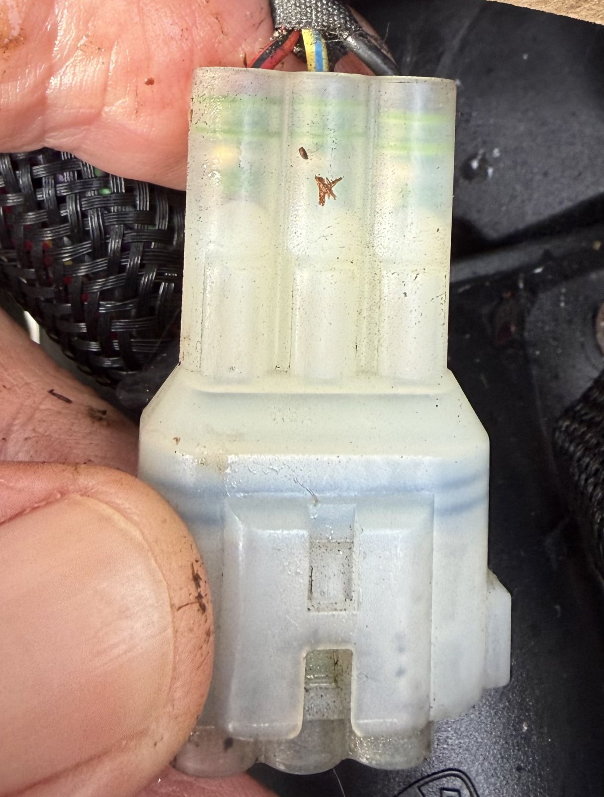

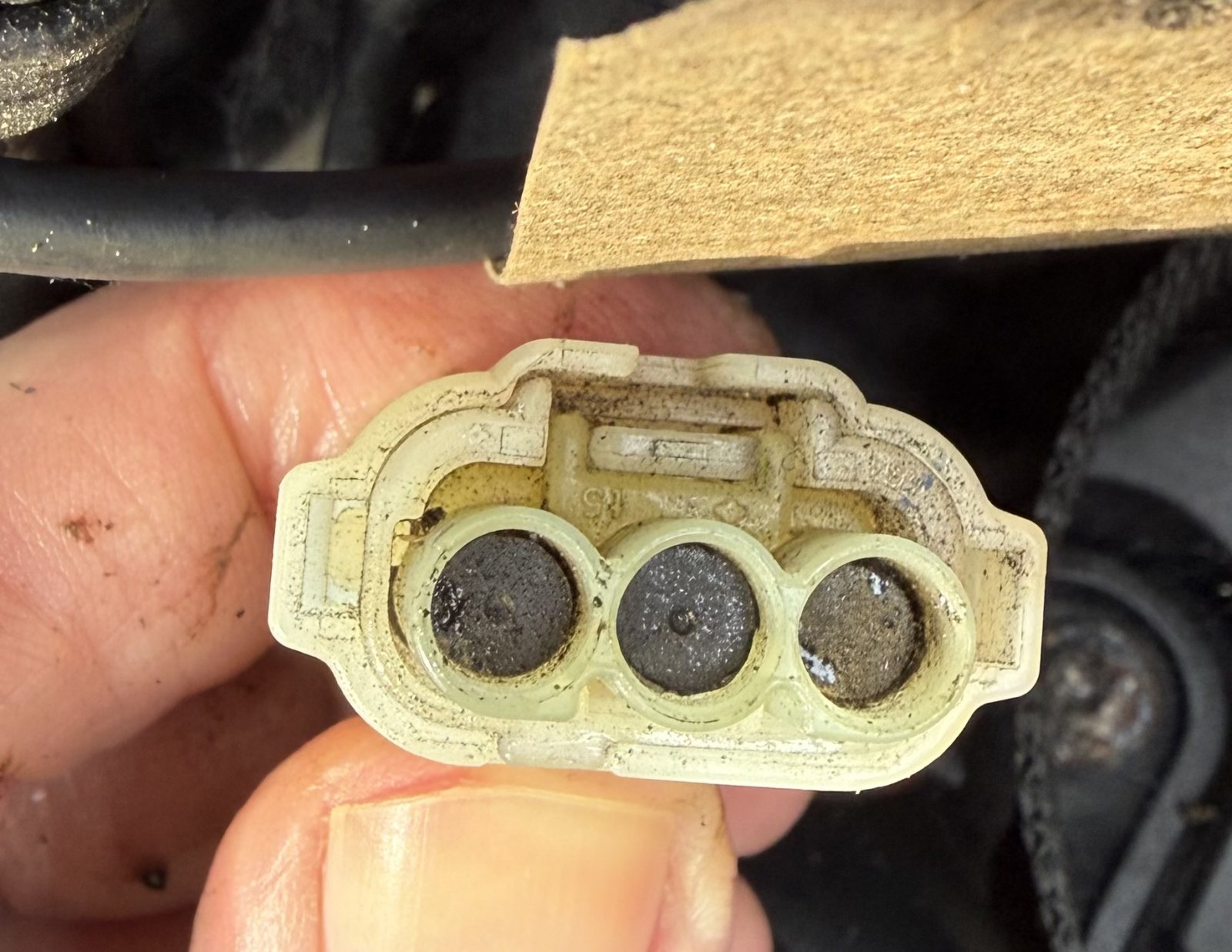

  2. This is the connector.
    I can’t help with the signal output as that bike is awaiting a new dash unit from Ducati, plus he doesn’t have fog lights. It’s a 1260S, not Enduro, but at least you can see what the connector is. I’m fairly sure it’s called a Sumitomo connector - 3 pin.
  3. It's possible to unplug the blanking dummy and plug in the small aux lights subloom without removing the tank. Well, on a regular 1260 anyway. Have done it twice. It's a complete PITA though, lots of fiddling a swearing involved as well as a curved pointy nosed pliers that I inherited from my dad. Pretty convinced they're from a 50s dental surgery but they've been pretty useful. Father wasn't a dentist but a military man and then a farmer but had a large workshop, he died 44 years ago today.
