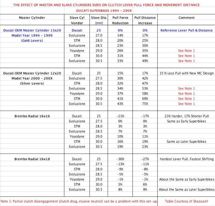

  5. I don't know if you've seen this chart, but with with a bit of juggling you may not have to resort to any specialist machining yet. There are many threads on here from memory, and some users with problems due to injury found that the inevitable further throw at the handlebar lever was something they couldn't tolerate despite there being less effort required.

  6. If your not too concerned about a bit of slipping, many years ago there were threads on making the clutch lighter, they did it by removing a couple of springs

  8. Smaller master, larger slave, both does what you want. Taking out a couple of springs or finding lighter springs is a good idea. Keeps the lever throw the same and reduces force. Considering the clutch has 2mm tolerance on the plate/disc stack and the springs are still able to prevent slip at the lower stack height some lighter springs, perhaps 20%, are more than likely going to be fine and help with force at the lever.

  16. I don't blame you, spring mods are far easier, and there are other tricks other than removing two spring posts completely. A lot of the aftermarket stainless steel springs are far stiffer than the original spec springs, which doesn't help.
