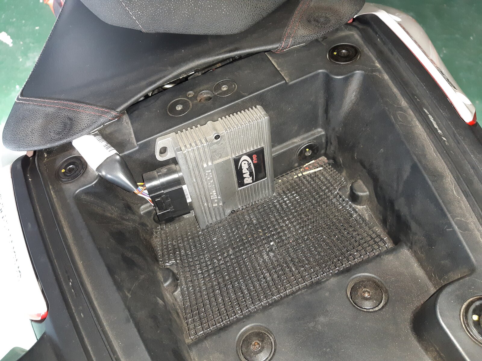

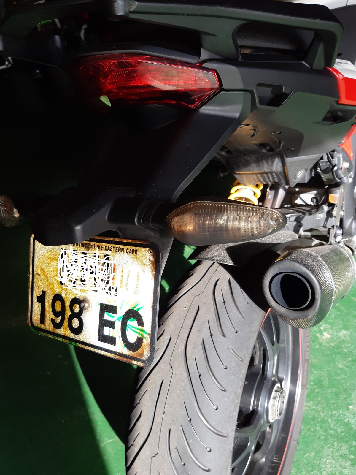

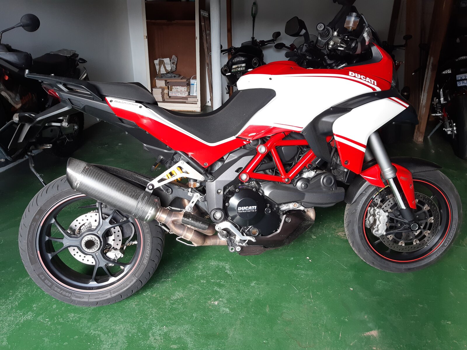

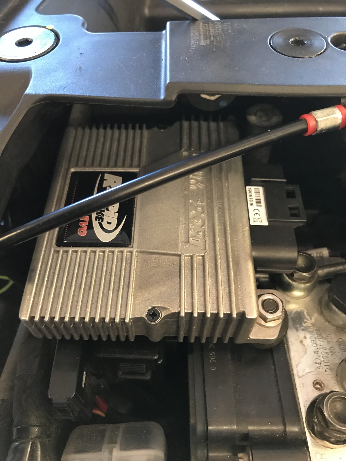

    will send some pics
  14. The ECU unit is best fitted under the pillion seat, the loom goes over that bulk head, I have had no probs with the loom wearing or pinching
  15. When fitting the Rapid Bike unit I also fitted SC Projects end can and link pipe which removed the HUGH catalytic converter which makes for a considerable weight saving
    I dont think the SC Projects pipe is as good quality as an Akropovic or even a Termi pipe
  16. It over fuels when flat out, as can be seen with blackened indicator
    The top end speed is not improved,,, I reckon 240kph (150mph) is the absolute max
