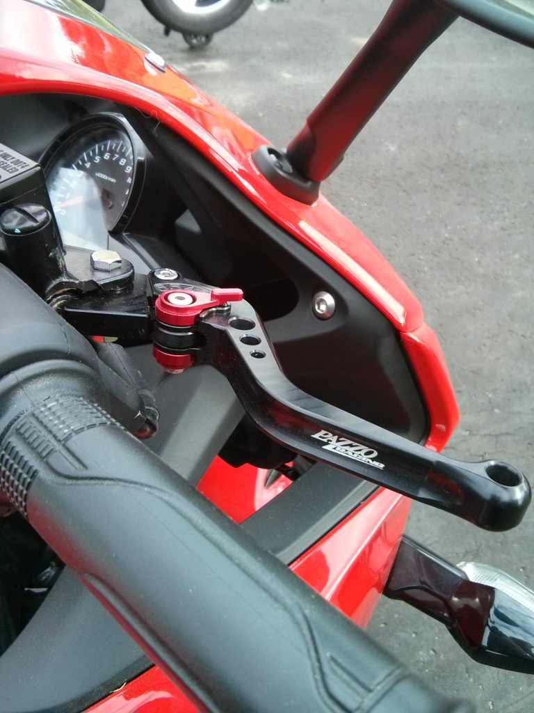

  6. I edited my post to remove that comment because I though it wasn't relevant but now that you asked:
    I find long levers slower to shift. Moreover, two-finger shifting offers more precision as you're less likely to unnecessarily pull the lever all the way. It's also safer as it allow your remaining fingers to firmly hold the grip. Finally if you use two-finger shifting with long levers. you're likely to hit the knuckles of your two-smaller fingers and you can also slip as they have no ball-end to prevent it from happening.
    I would never go back to long levers.
    About the clicker: the range of adjustment is fine. You'll find that you can quickly and readily alternate between two sizes. In traffic, I sometimes want the friction to come in early. Then revert to normal for regular riding.
    My wife is 5'2" with small hands and fingers. I installed short Pazzo's on her CBR300R as shown. Problem solved.
    #6 DarR, Jul 11, 2019
