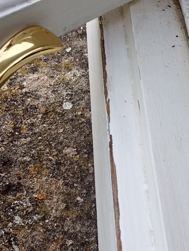

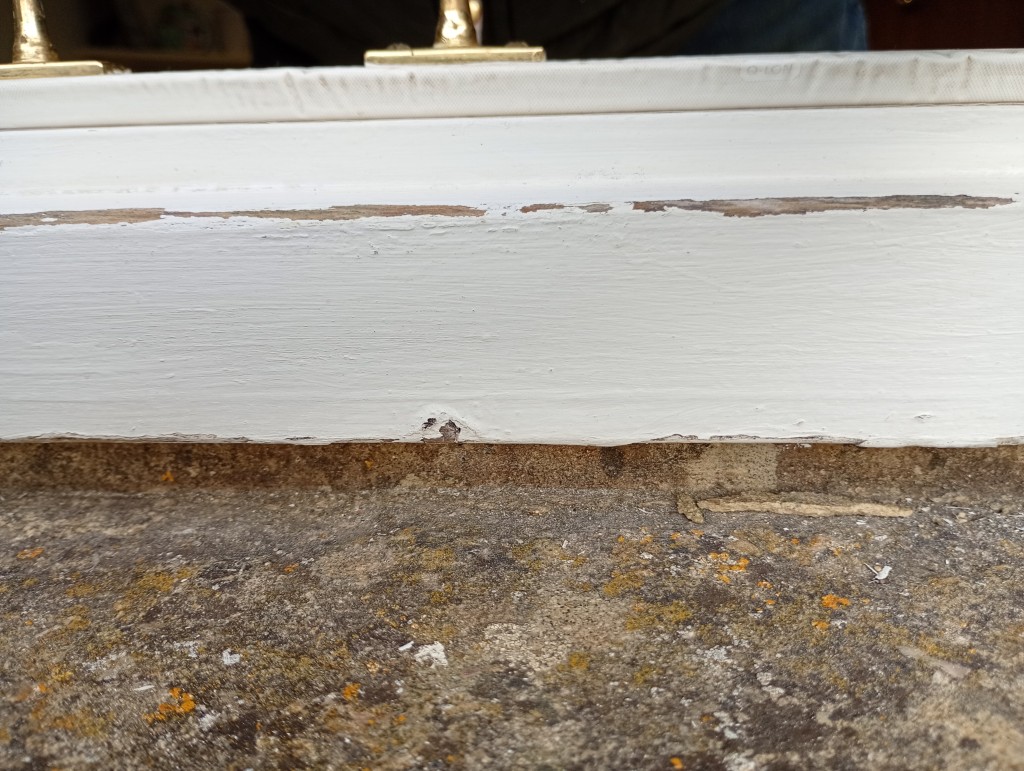

Just giving a couple of the window frames a summer freshen up, you know just sanding away the loose and flaky stuff ready for a little paint. But it's always the same bits that need doing, and those are the right angle edges on various pieces where the paint is thin. So how do you actually apply the paint (brush) to ensure these edges get sufficient coverage?
Those edges look like they need some filler as the woods starting to decay.. Ronseal rapid set wood filler.. Sand and shape Prime sanded woodwork with Zinser BIN primer Paint with a proper outdoor wood paint probably twice.
I hear you... I had a little pick and they're not that bad but I was going to use some Rustins wood hardener and Toupret external wood filler if required. Another vote for Zinser I see. It's the actual paint application that bemuses me. If you use length ways brush strokes the paint flows on the top and side but not on the edge. And if you use brush strokes across then it either runs down the front or forms a lip on the top....
occupational hazard - those areas get weathered the hardest sand back to good and fill and rub back as needed 3 coats; 1 primer 2 top (flatten between two top coats). speak to your local merchant and ask for a high build exterior paint suitable for wood get decent brushes that leave the paint on the surface - again, your merchant will know what suits your paint/application best
I always think the primer is the key (pardon the pun) then the top coat is the decorative icing on the cake. Re- applying the paint, 2 coats minimum and in varying directions to ensure it finds its way in, if you can be bothered a quick sand with finishing paper between coats to really make it look good.
Try to avoid sharp (ish) angles. Sand any angles to round them slightly to ensure good contact and coverage.
I have, and tend to use, the more prosaic option of Dulux Weathershield which has served me well in the past. And yes, I've learnt me lesson with cheap brushes.
