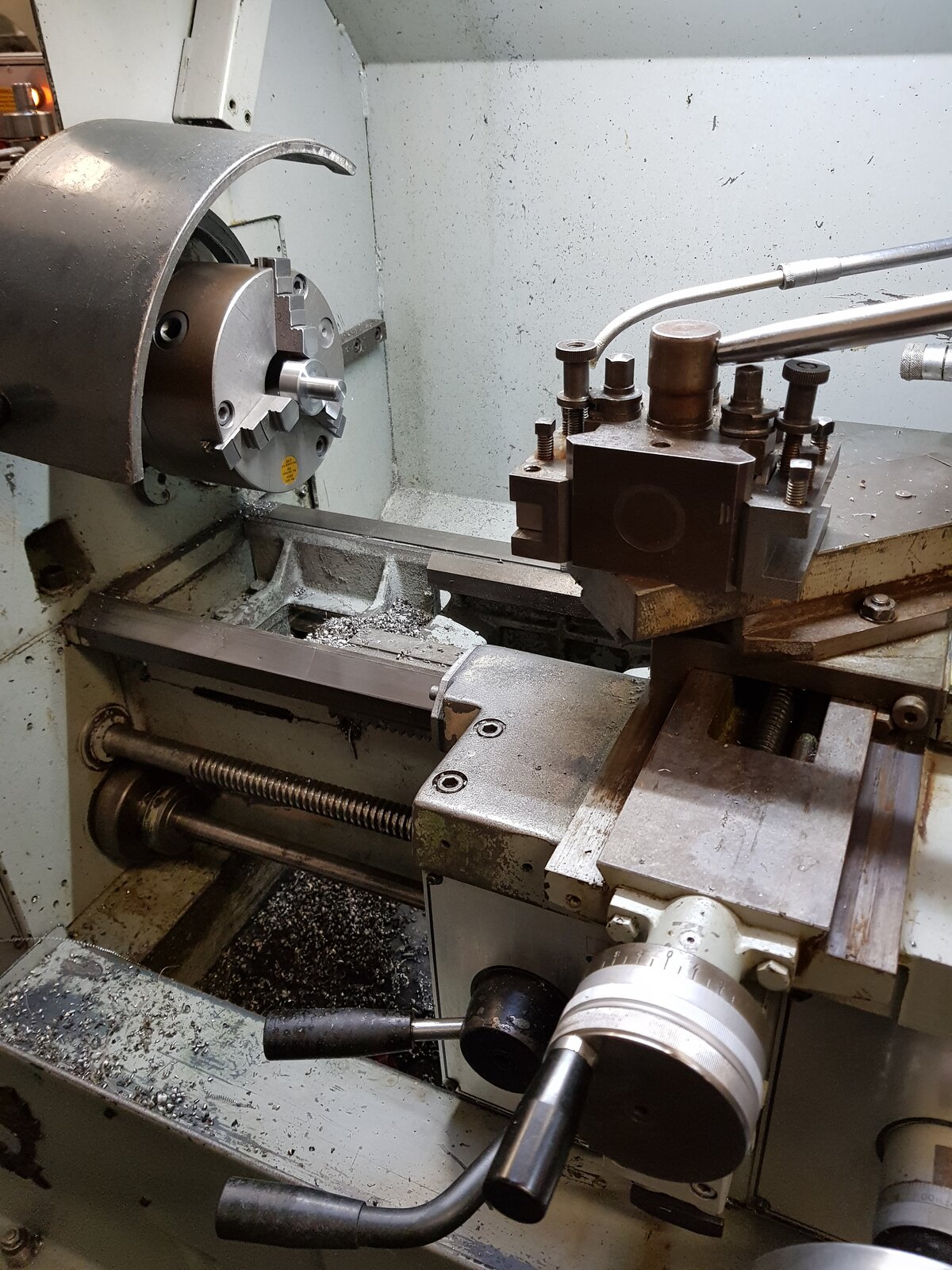

  1. I've got a 3 phase lathe and its tripping when you turn it on.
    There's a bright blue flash/spark coming from the switch wiring.
    I've done the general checks on the wiring to see if any of it is bare but all looks ok.
    Anyone clued up on these types of thing?
    Can I bypass the switch to see if it's the actual switch?

  7. [​IMG]

  11. It's a good big lathe, Chesterfield I think.
    Was running on 3 phase in previous workshop and on 3 phase in my unit.
