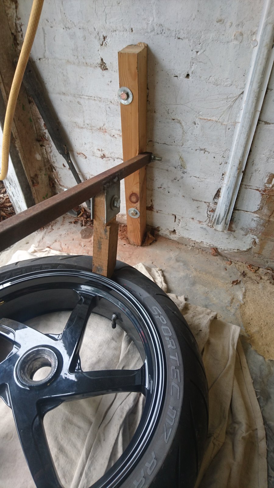

    My bead breaker is 2 lengths of 4" x 2" timber, 1 about 1.2 m long and a short one about 400 mm long. The long one is wedged under a piece of steel angle iron screwed to the garage wall and lever down on the short one against the tyre - being careful to avoid the rim. I use another small piece of cloth wrapped timber under the rim to support it.
    A cheap Aldi compressor - about £80 from memory including tyre inflator etc. is just the job for seating the tyre on the rim and the addition of a rattle gun makes it even more useful.

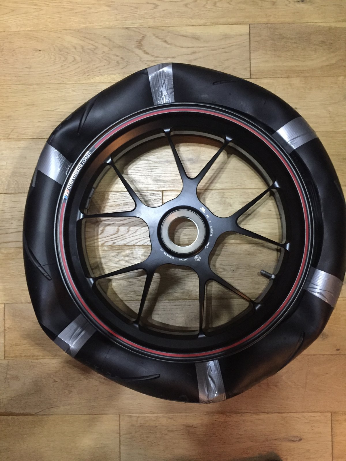

  15. Anyone else tried the cable tie method ? Worried about damaging new Tyre distorting it like that.
    Just got new set of tyres from online , but most local places here want £25 a wheel to change tyres over.
    So it’s either invest in some cable ties or a bead breaker kit and levers. At least then I’ll have kit for future changes. Thoughts ?
  16. Cable ties to remove - gaffa tape to fit :)
  17. Just repaired a rear puncture this week. I used a home made bead breaker, some split fuel pipe to protect the rim while using tyre levers to remove the tyre. Refitting is very easy the first side of the tyre pushes on by hand and the second side just needs levers for the last few inches. Leave the tyre in the sun to soften it up and use some soapy water to lube it.
    Steve

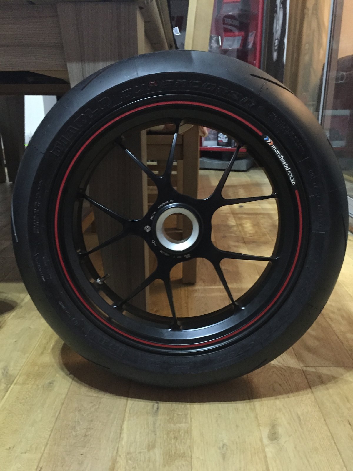

  18. Fitted in around 1 minute from the end of the taping - my first attempt, 5 mins total ... then down to Tesco to pop it on with the airline which it did at around 55psi. Did both front and rear the same method.
  19. Ah , never thought of that
    Easier with the tape going on and not so much point loading on new Tyre ?
  20. Thanks Steve
    Using rented garage at moment so can’t screw anything to the walls :worried:
    But moving soon ,and will fit similar to save a few quid :upyeah: cheers
