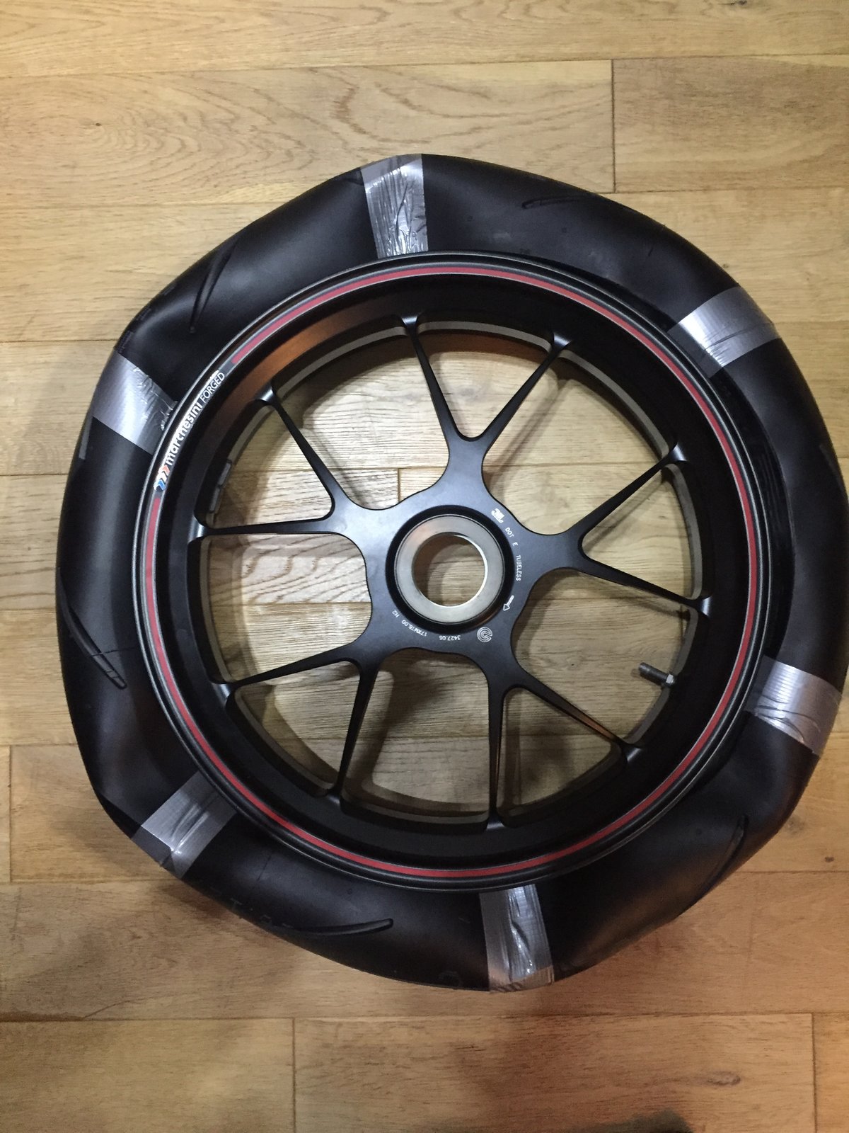

  1. Exactly - and easy to remove too once the tyre is on the rim - impossible to thread in to remove tyres though :)

  3. Never tried the tape or ties, will have a go next time.
    Steve

  7. So no problem getting the tape off the tyre then?
    Presumably trickiest bit is getting the tape off where it's touching the rim, given that the tape touches nothing in the void between the tyre beads?

  9. No, the tyre isn't seated so you just squeeze and pull the tape out - not an issue at all, out in seconds. Some tyres may prove trickier depending on stiffness I guess but these Supercorsa's were easy.

  11. Cable ties do distort the tyre, but it's easily bounced back into shape. If you have a tricky one just fit a rim protector and using a tyre lever pick the tyre back towards the rim before trying to inflate.
    I use a small emergency 12v compressor to inflate mine. Usually pop at ~40psi.
    I'll give the tape a go next time...:upyeah:

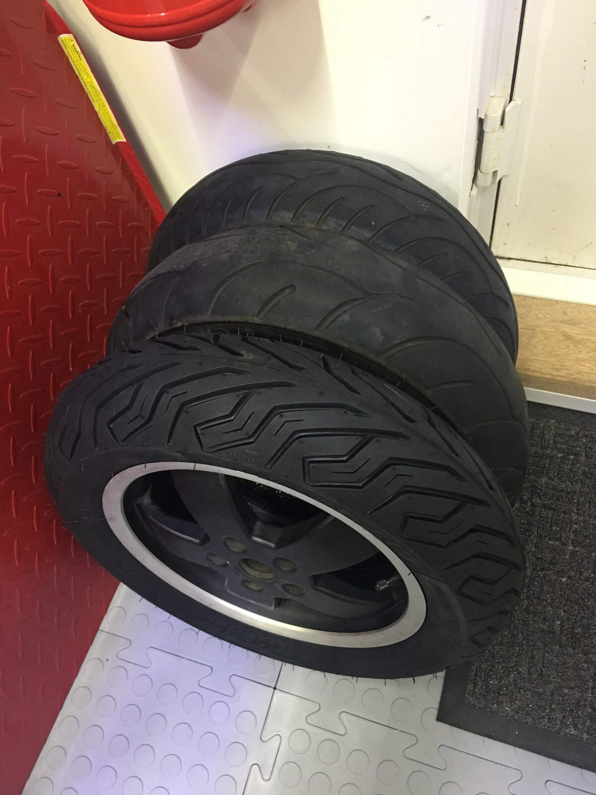

  14. I've replaced my Vespa tyres at home for years and these are more difficult than a 17" wheel being only 12" with a lot less give.
    Bead breaker, tyre levers, rim protectors and a home compressor.......Job jobbed. :upyeah: I put a new pair of boots on only last week.
