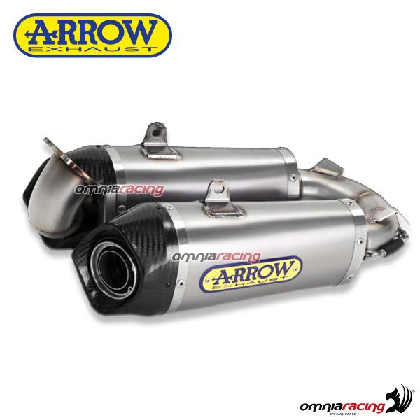

    https://www.omniaracing.net/en/arro...for-ducati-panigale-959-20162019-p-97095.html
    I'm looking at options for my V2, I like the look of the SBK Single silencer but they are just stupid loud, I ideally want something the same volume or slightly less than the Akrapovic but not £2600!!!
    I think these are about £1200 and I've been really impressed with the Arrow products I've had before.
    The issues I think I'll have are: Warranty, Needing an Upmap for a V2 which is probably dealer only when purchasing an Akrapovic, so it may be a non starter.
    Failing this, anyone know for sure of any dealers who would do a deal off RRP on the Akrapovics for an already purchased bike (not from them as I won't ever go near the dealer I bought my bike from).
  2. The thing I don't like about the Arrow from the picture is the exhaust outlets looks like they point backwards, rather than out to the side like the stock 899/1199/1299 exhaust and I wouldn't want the exhaust heat being blown out towards the rear tyre and chain.

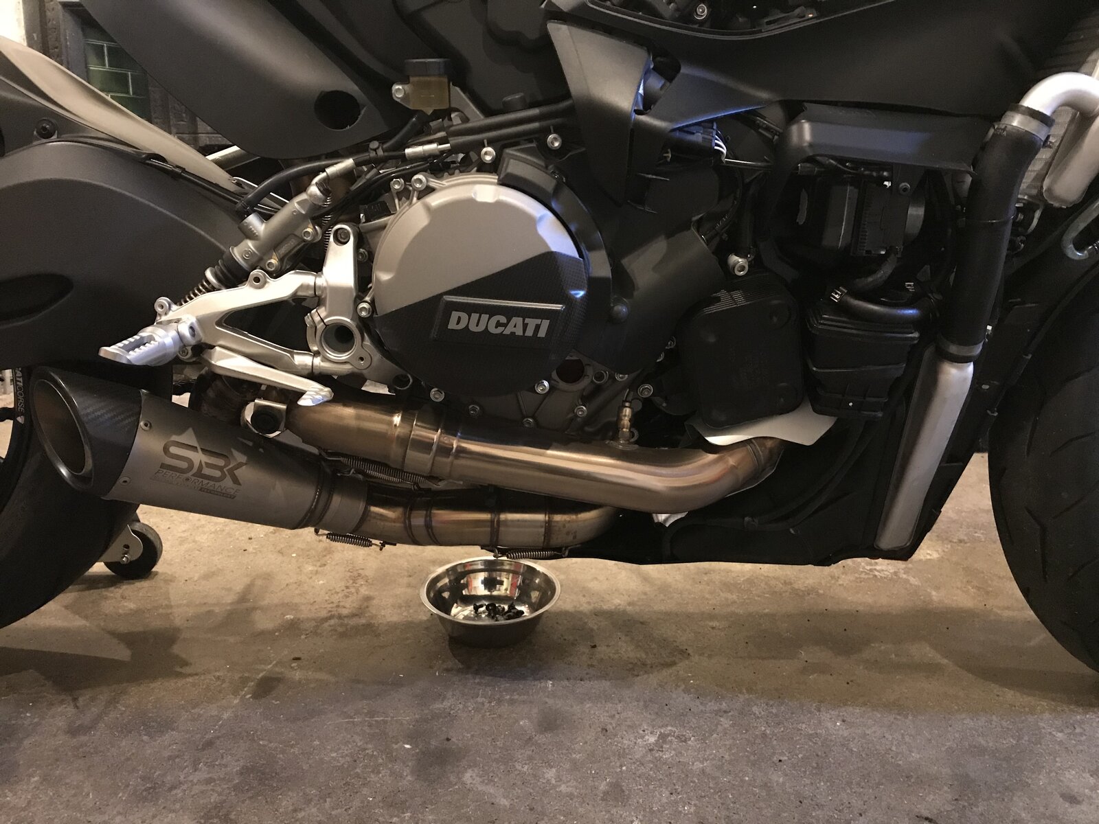

    I went for the SBK silencer and decat in the end. Admittedly loud but not in a bad way, it sounds good, saves a few Kgs in weight and a lot cheaper.
    Looks cool too.

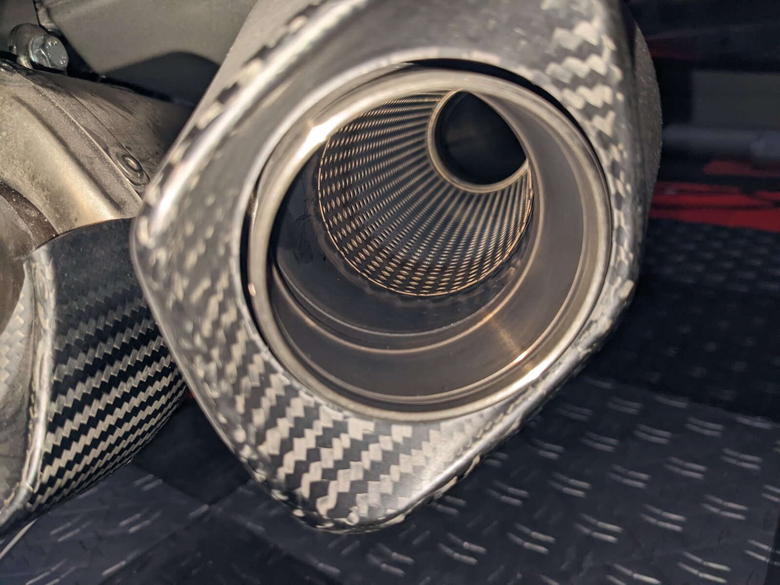

  18. I also have the Arrow (no ugly yellow badge) on my 2021 V2. Love the pipe without the baffles (no noise issue where I live for street or track - Midwest USA), but I do wish it didn't point at the right side of the rear tire. I have an SLR tune with throttle and torque restrictions removed. This thing sings and flies.
    -0260
  19. There’s a whole thread devoted to this somewhere if you take a look, might be useful to you.

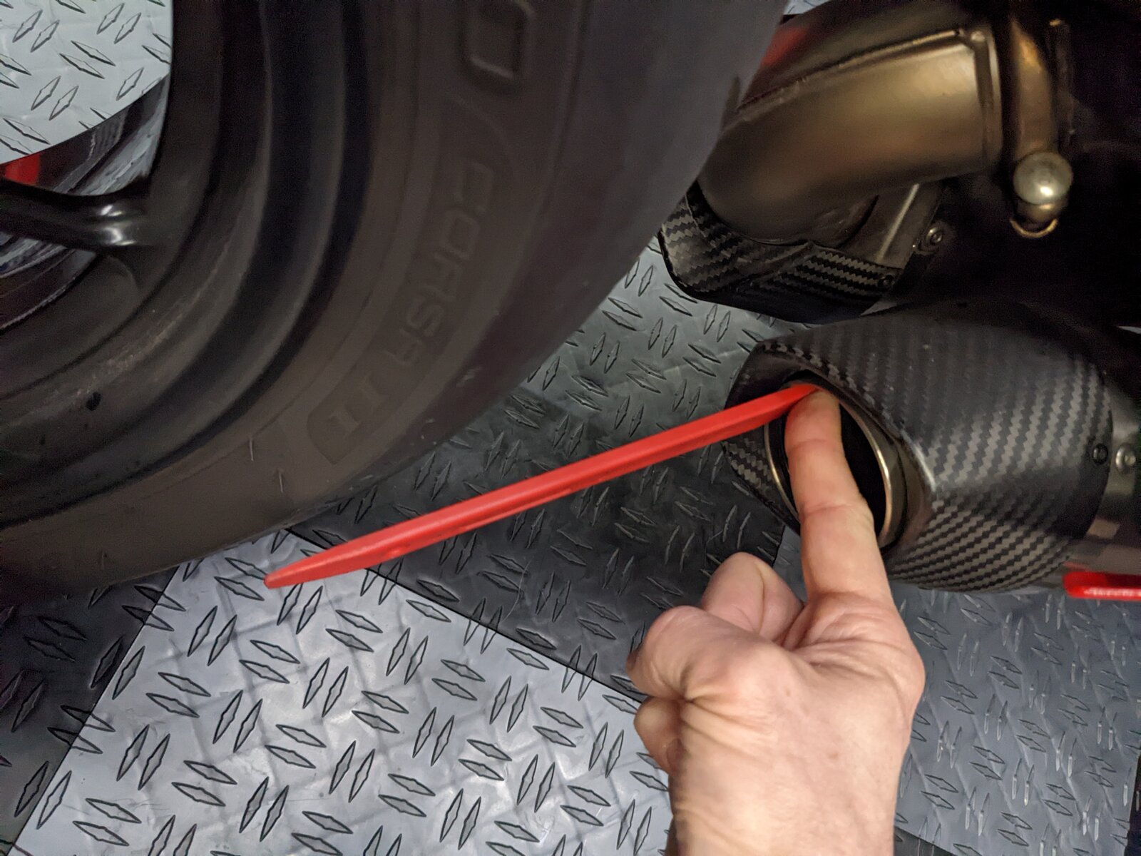

    I dont understand why that Arrow system points straight at the rear tyre and they didn’t just kick the exit out to the side a little
  20. The main flow is aimed at the tire edge, but the last part of the pipe kicks outward and aims away from the tire. So much of the exhaust is not hitting the tire, but some is. I think they wanted to keep the pipe tucked and still have mostly straight flow.
