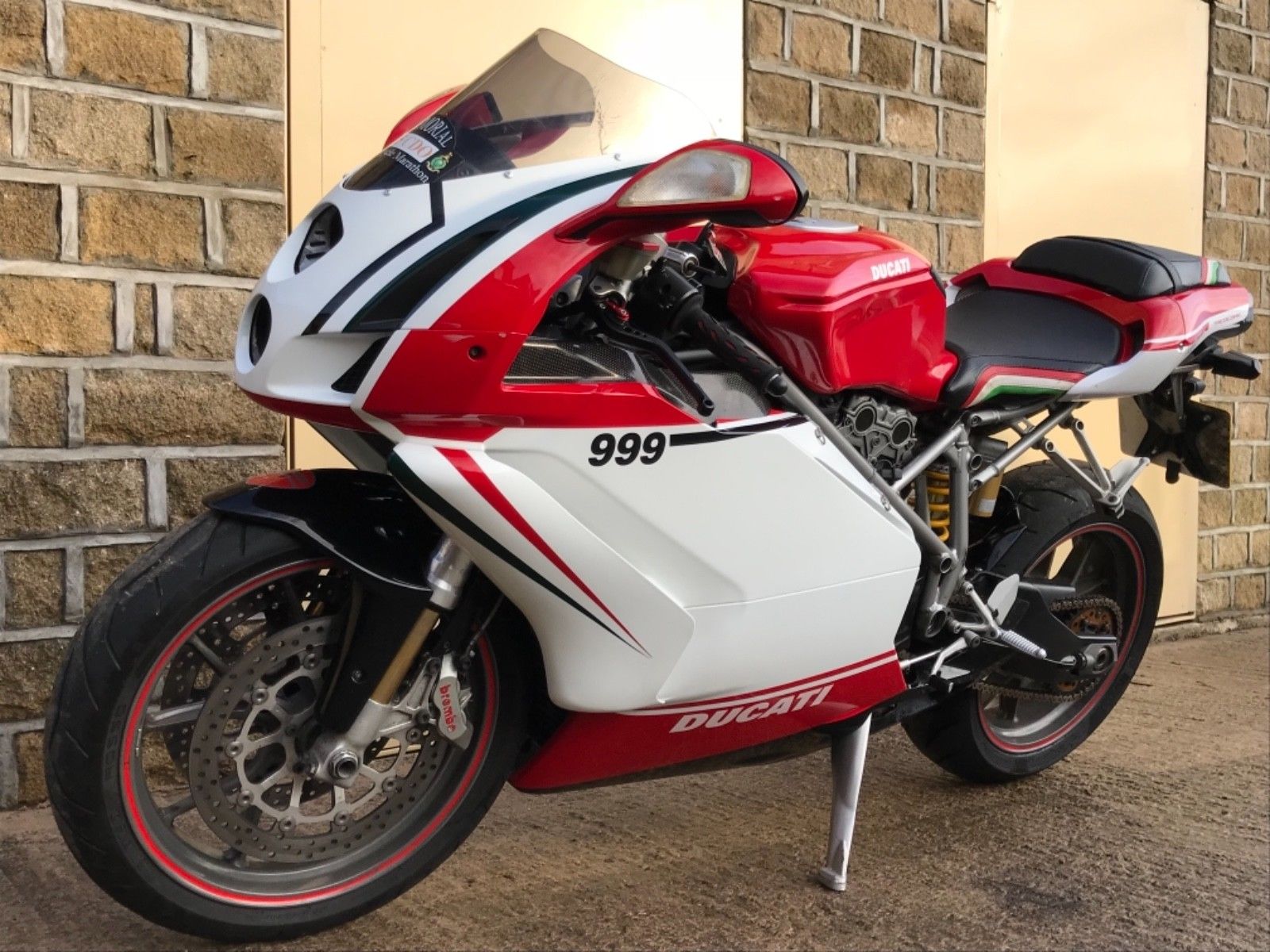

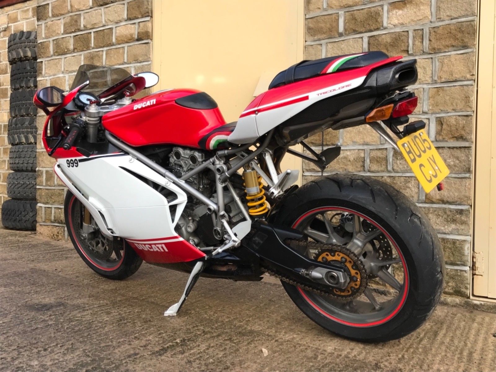

  1. Possibly having a look at this 999, but the guy has no history on it at all. 28000 miles ish and no service history.
    Also, is that definitely a full 54mm Termi system on there?
    Seems to be a little overpriced with miles and the fact it has no history. Said the previous owner had a lot to doing with Ducati community and did it all himself, so thought I'd ty and do some digging :).

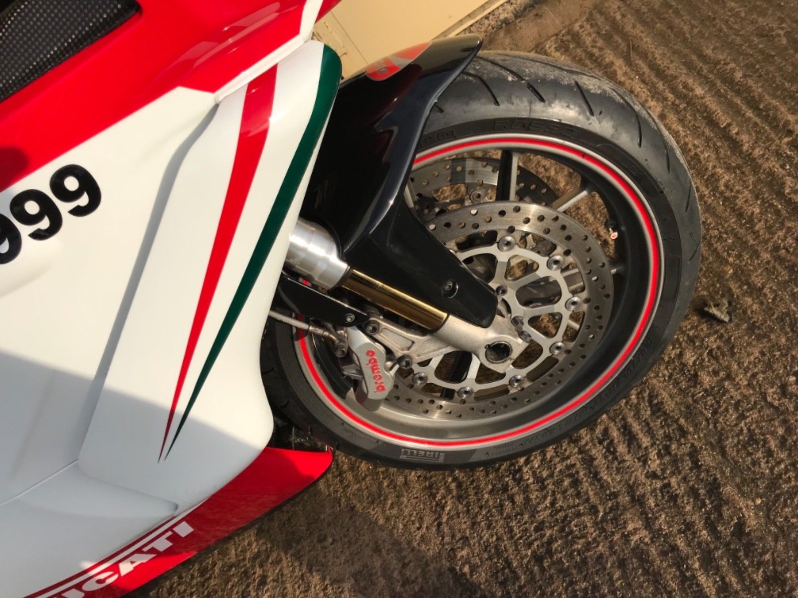

  5. Fairings look Chinese, not a massive issue but I'd be wanting to pay £500 less.
    Looks like a 03/04 base from the swing arm and forks.
    With millage and lack of history I'd say £4k personally.
  6. If you don't know if/when the valve clearance checks were done and you can't do yourself then budget £1000 for a service.
  7. 4k is probably about right for the mileage and lack of history imho.

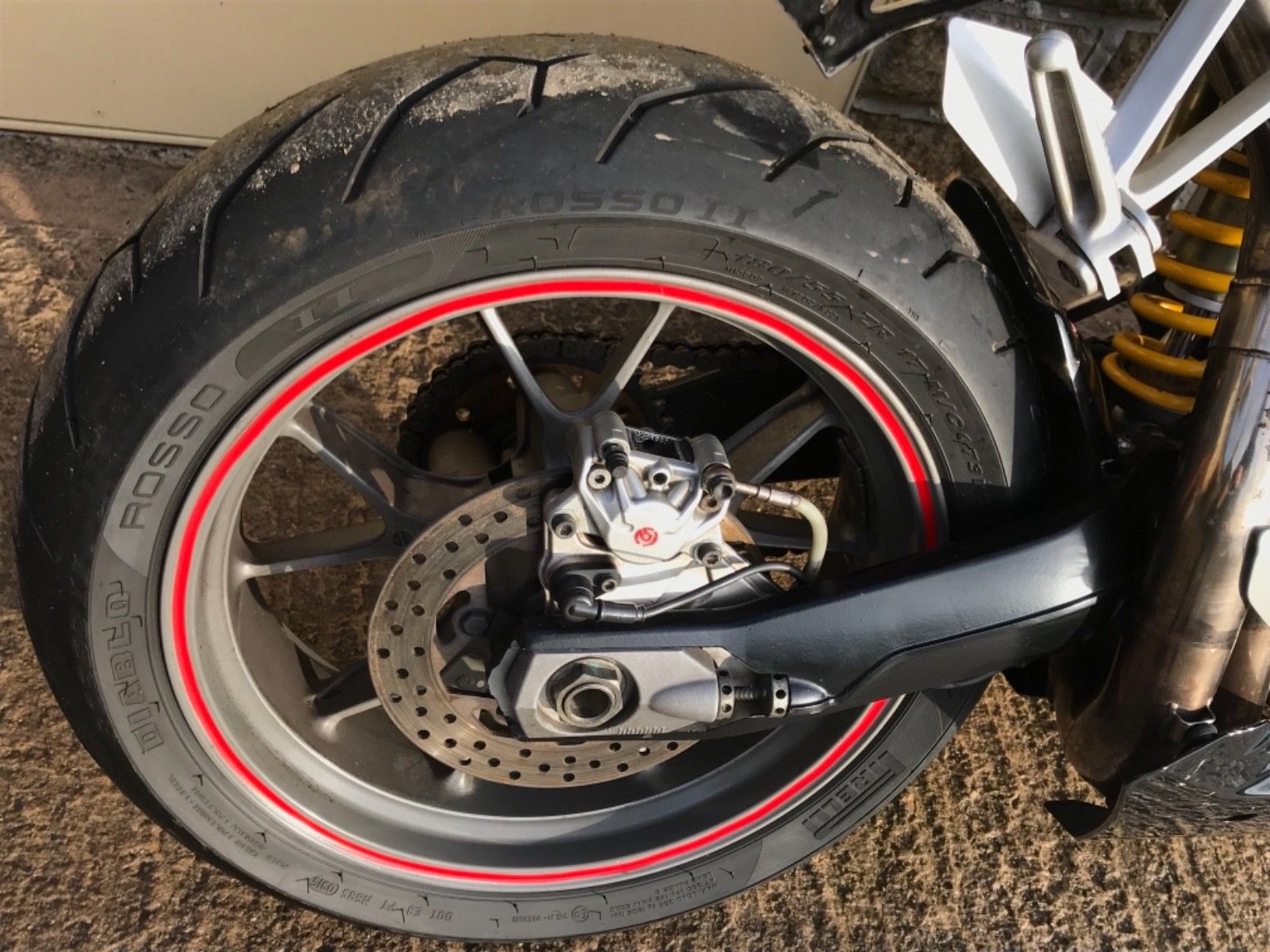

  8. Yes, the fairings are definitely not OEM.
    The exhaust has no fixings for a heat shield and there is a join behind where the heat shield would go that is not there on a an OEM exhaust.

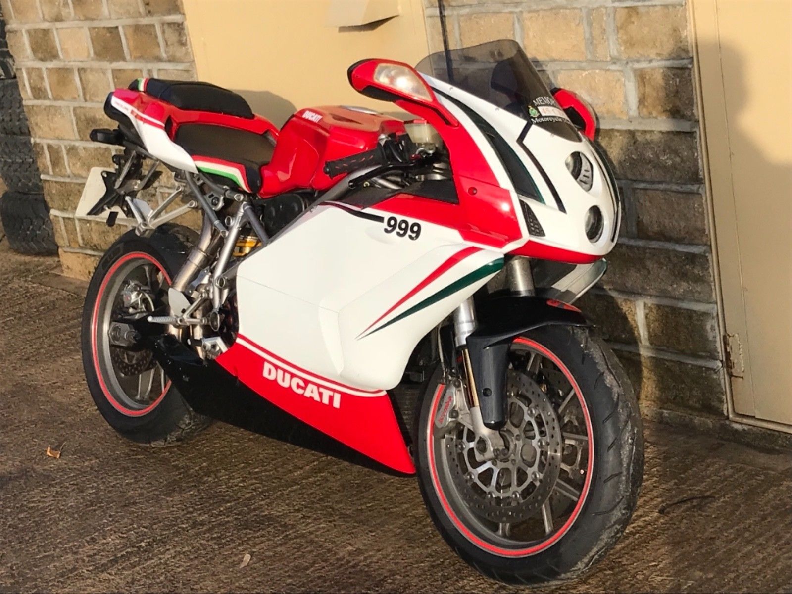

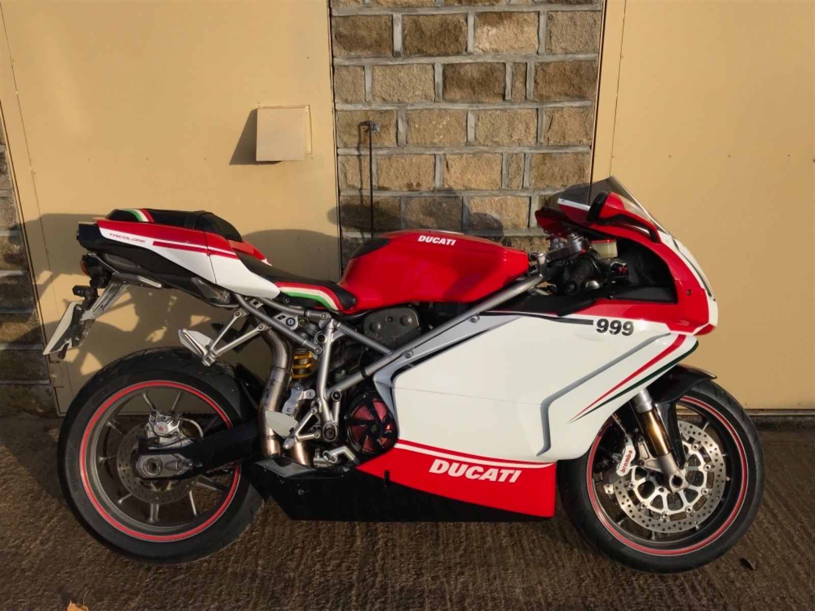

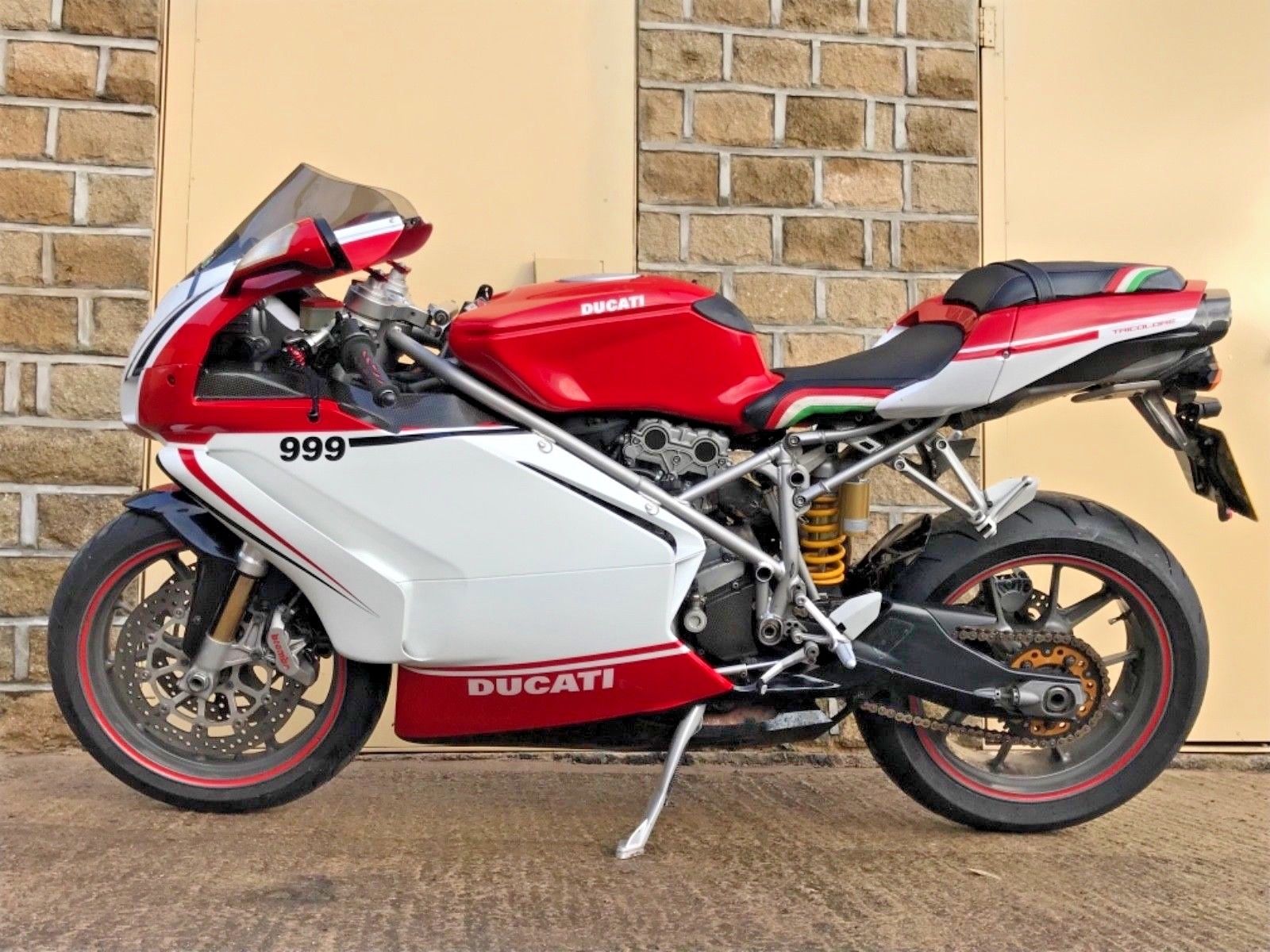

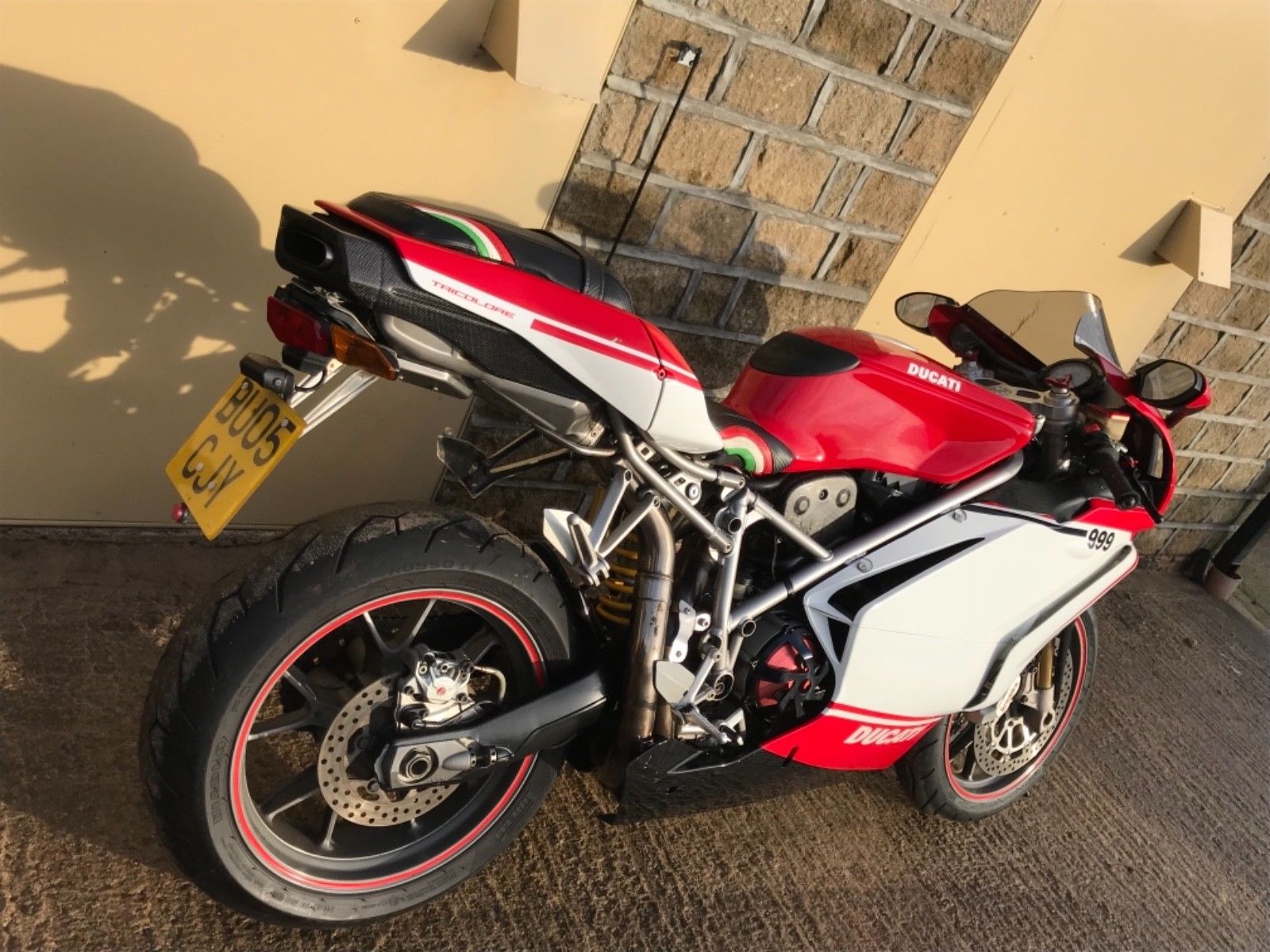

    s-l1600 (18).jpg s-l1600 (17).jpg s-l1600 (16).jpg s-l1600 (15).jpg s-l1600 (14).jpg s-l1600 (13).jpg s-l1600 (12).jpg s-l1600 (11).jpg s-l1600 (10).jpg s-l1600 (9).jpg

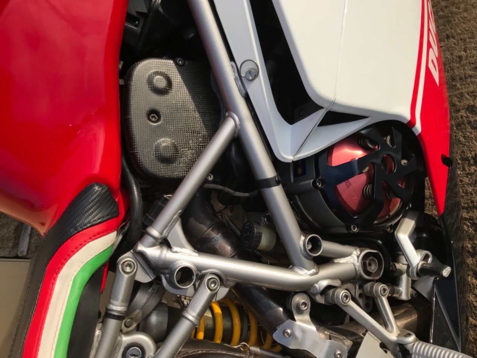

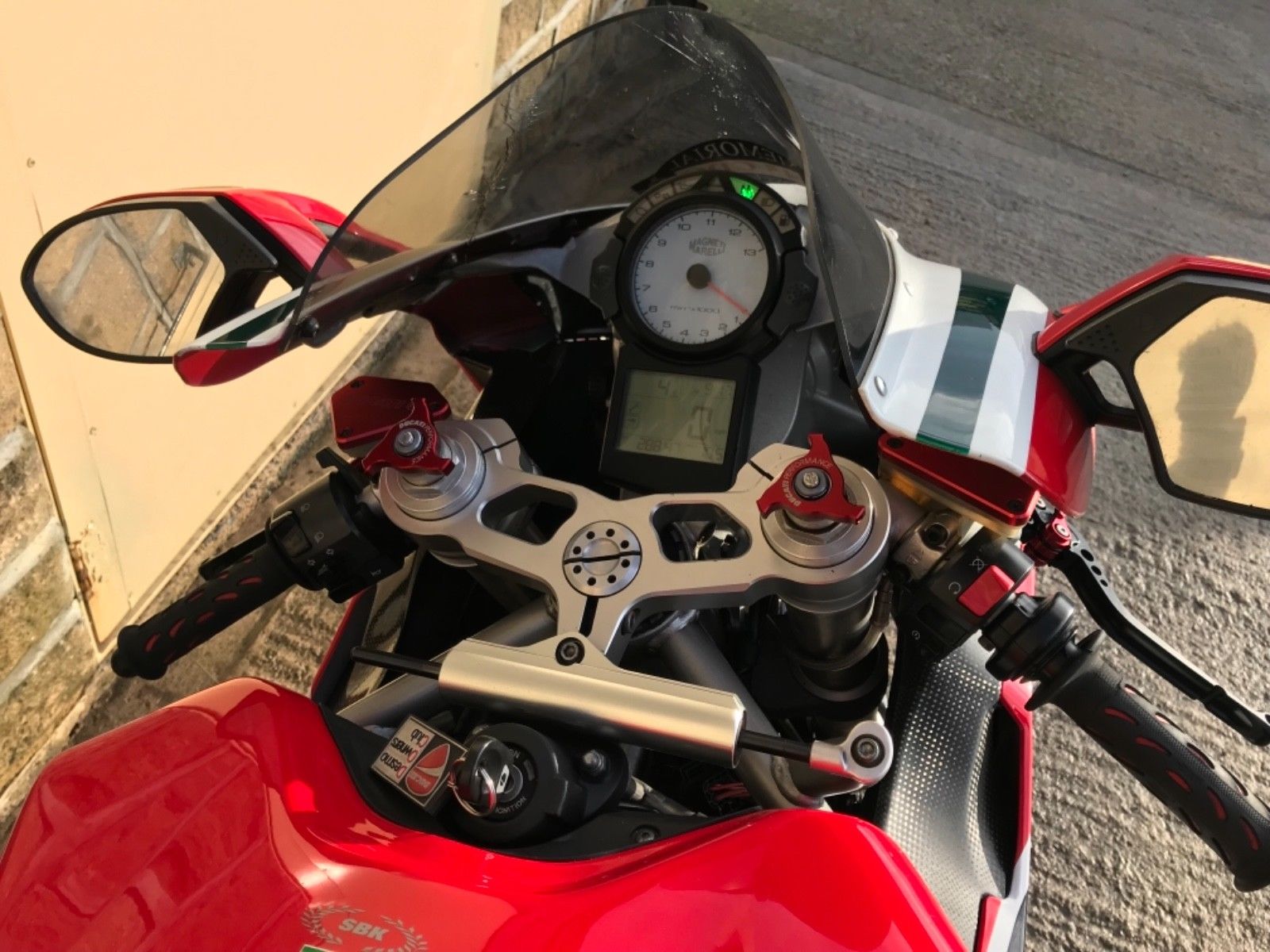

  12. What is that weird bracket in front of the suspension unit?
  13. DVLA are saying its mot ran out on the 5th April, no history with it and possibly with aftermarket fairings. Have you done a hpi on it?
  14. Looks like a home made heat shield.
  15. If so it's doing nothing.
  16. L/h fairing should have two bulges and a vent that just aren't there.

  19. Theres too many ifs and buts with this. 28k is fine with a FSH, but without? I'd walk away or pay £3K tops and take my chances. Replica fairings worry me too, I'd be looking for crash damage and bolts with wire holes. The painted swingarm too worries me. This possibly may have been a track bike. If the price is right, then fair enough but I agree with Old Rider.
