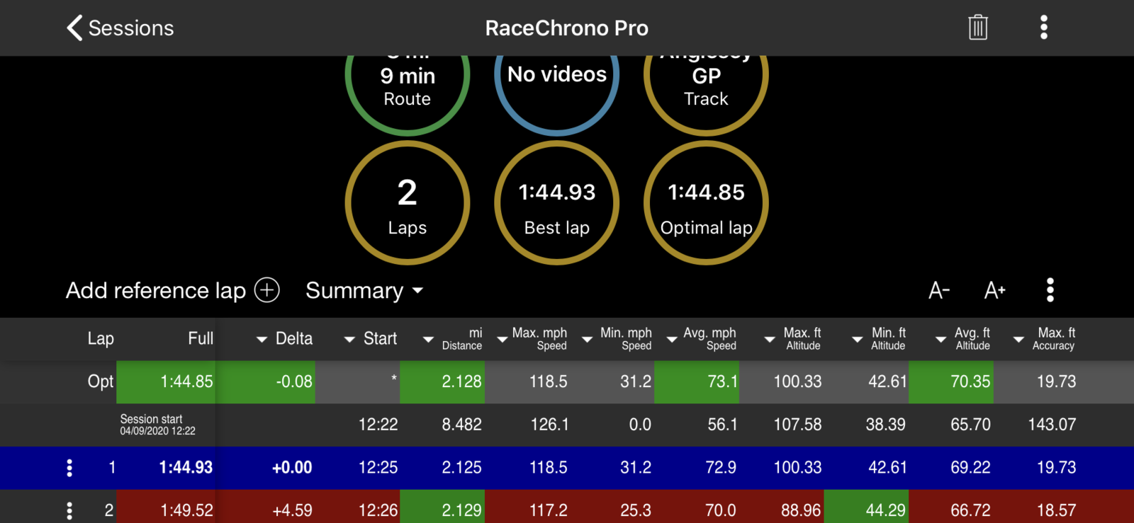

    I’m a bit confused with it being accurate?!
    I managed to record one session on my GoPro with the app running and it was about right to what my camera says, and top speed in the right ballpark to what the dash was saying.

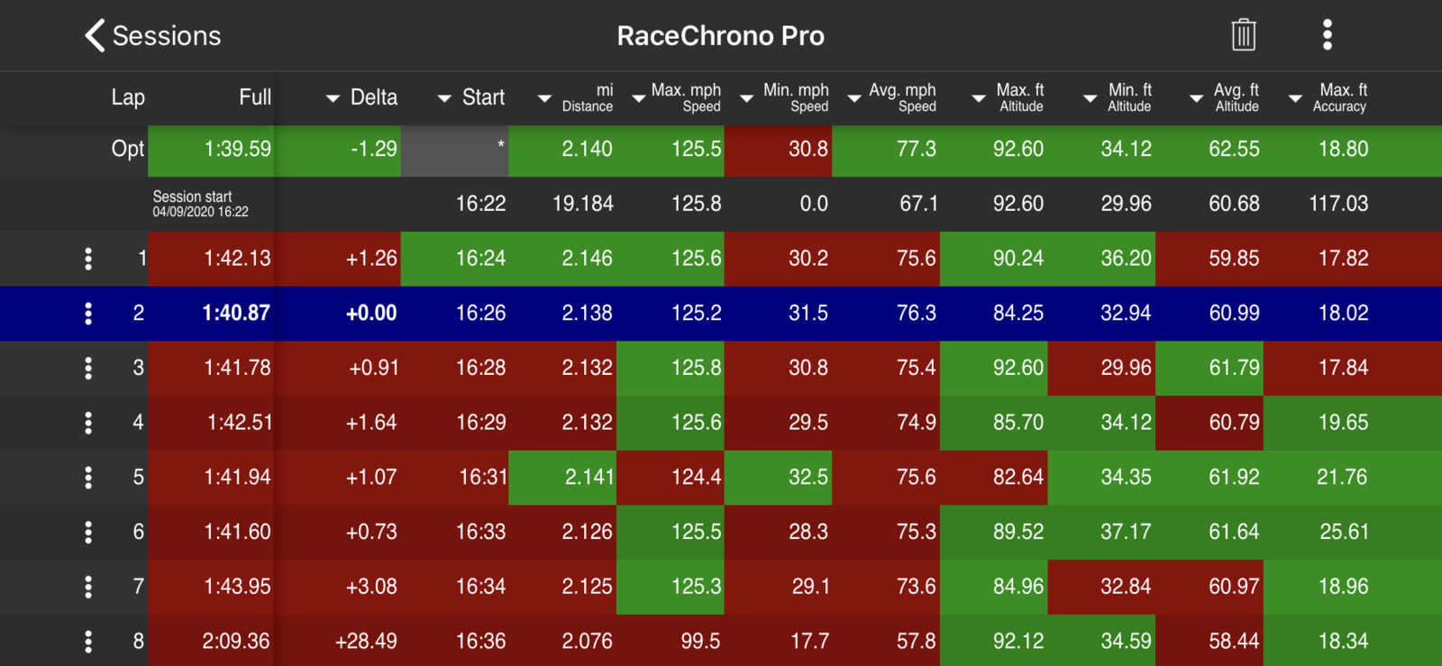

    Then as I got faster it didn’t seem to quite tally up, especially the top speeds it was recording. I was over 150mph on the speedo which is probably 140 something in GPS terms but the fastest it recorded was 126?
    I’ve got my phone mounted on the tail piece with perfect GPS signal so why does it seem less accurate as I got quicker?!
    Screenshots above, first is the one I recorded on GoPro, second the last session of the day.
  2. Normally the challenge with any lap timing device is the frequency at which the gps signal is recorded/logged thus the accuracy of the device.
    I use a dedicated lap timing device instead of an App on the phone as I doubt that the phone gps is as accurate. This may account for the discrepancy or doubts that you have.

  3. Phone GPS are crap, you need to Bluetooth it to a GPS receiver.

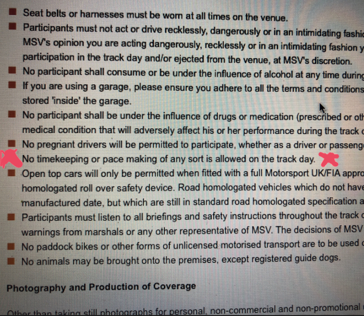

  4. Just a cautionary note. The T&Cs of some TD organisers specifically prohibit the use of timing devices. So not only might they exclude you if they spot you using it, if you crash and make a claim or someone else makes a claim against you, the insurer might try to avoid liability on the grounds that you were in breach of the TD T&Cs, as a result of which you were riding against the clock and pushing too hard as a result.
    Please don't take this as gospel as I am no expert on insurance law, which is a specialist area all of its own but if you do have trackday cover as one of the benefits, check the wording carefully.

    This is from MSV’s T&Cs (though looking again it appears to be for car days, but the bike ones are the same IIRC)

    I used RaceChrono for a couple of years on a cheap Samsung Android phone Velcro’d to the tank and connected by Bluetooth to a Garmin GLO on the tail.
    It worked really well and I was also able to overlay the data display onto my GoPro footage at the end of the day.

    Nah not paying silly money thanks. I bought a waterproof phone case and bolted it to the back of the bike so it gets perfect reception and works spot on. Still been using the onboard timer manually and it's within a couple of tenths of the app which is more than likely my reaction time than the app being out.
    The top recorded speed still isn't quite what it should be but I'm only worried about the times.
    Overall for £20 with the case I'm happy that it's good enough for me to track a bit of progress.

    In answer to your original question though, Phone GPS is pretty pants at the speeds that you get on the track, so you'd want a separate GPS device like a Quartz that you bluetooth into your phone to make it work properly
