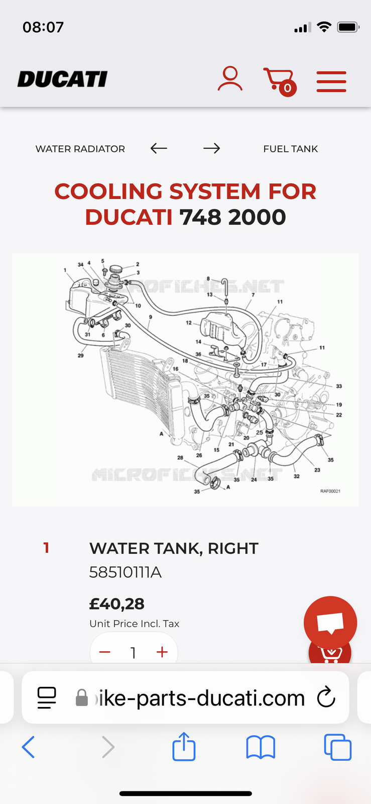

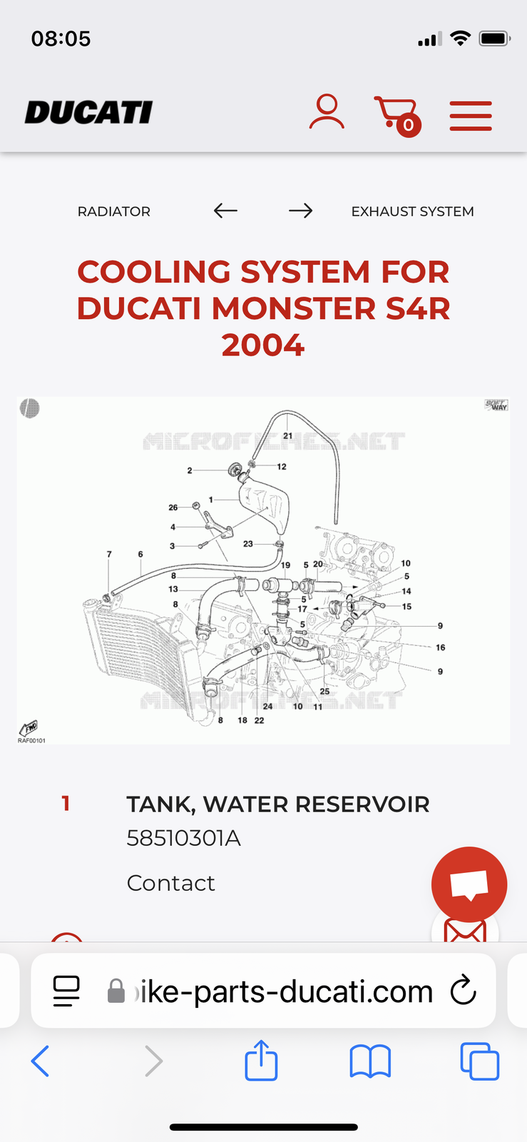

  10. Ok, let’s ask this a different way - the S4R has a 996 engine right??
    So, are the hoses on the 996 engine the same as those in a 748??
    if so, then a S4R kit SHOULD do the job right?
  11. Check the 998 hose diagram too. That definitely shares many common hoses and now, having had a quick glance at the two diagrams above they appear at first glance to be different
  12. AFAIK, 748 will be the same as 916 & 996 but I don't think S4 or 998 will fit.
