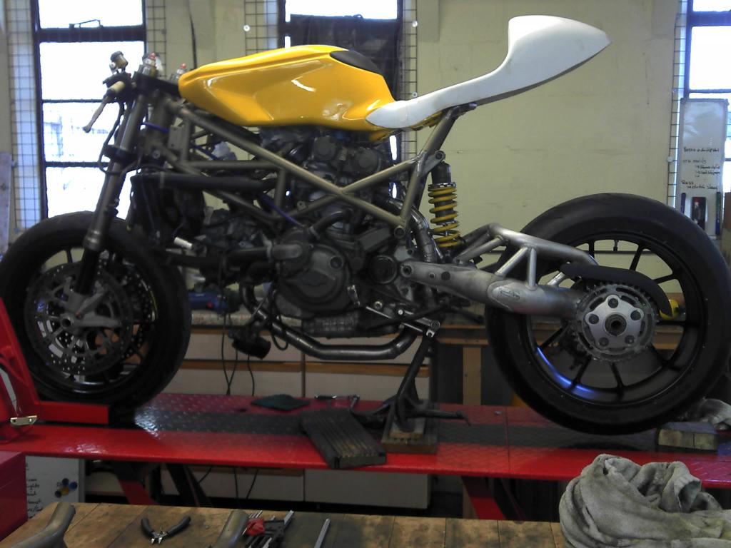

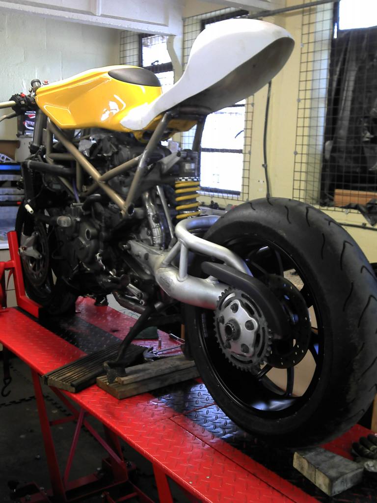

  4. Well Mark sent me these photos earlier, no turning back now!
    its a first mock up to position everything, the tail is going to be dropped a little to close the gap a touch between the base of the tank and the vertical cylinder. I absolutely love it :biggrin:

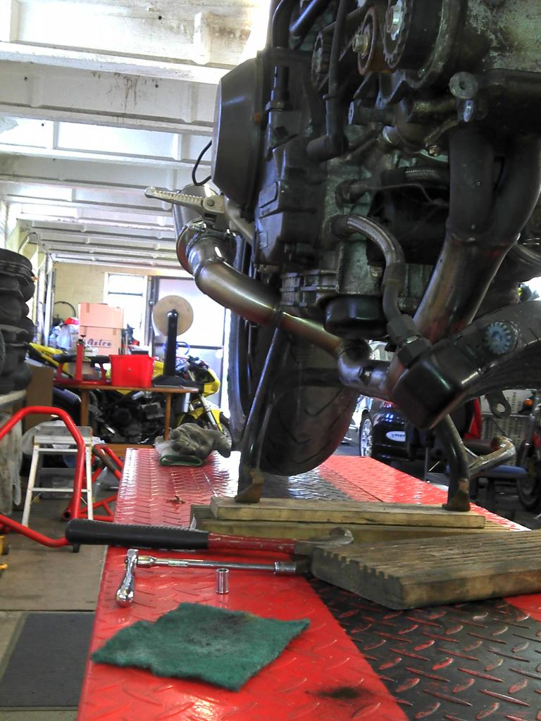

  14. Its been a little quiet recently as its the start of the race season and Mark has been busy, however he has managed to get a few bits and pieces done including the new exhaust system.
    He sent me through these pictures, it's, er, going to be a little loud i think...

  16. Liking this a lot. Seat looks bloody high though...
  17. Swingarm looks the biz. I wish they'd put that on the 999 as stock.
  18. Cheers guys, the seat height is actually a bit of an optical illusion. The ride height adjuster is wound right up and the stand is up on blocks making it artificially higher.
    Having said that it is quite high but because its so narrow I can still get both feet flat on the ground
